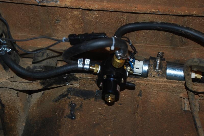

    Picked up the Mallory fuel pressure regulator that I should have gotten in the first place. Haven't had time to install it yet. Heading out of town this weekend and won't get back on it until next week.

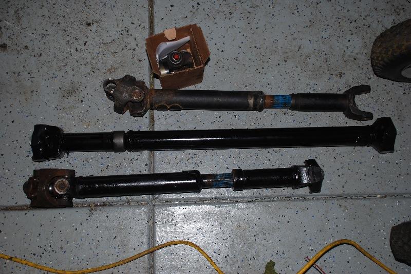

    -tcase/driveshafts, ready to bolt in, won't clock it at this time.

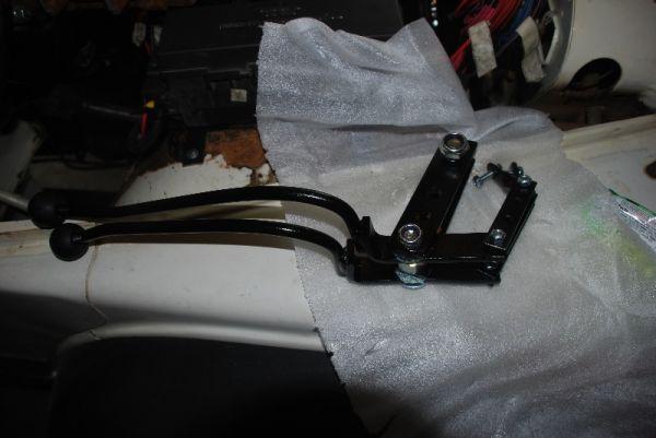

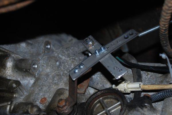

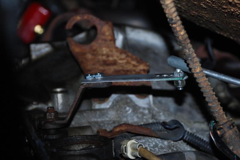

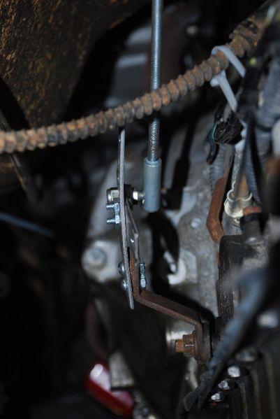

    -fab tranny shifter link: looks like something can be made to work off of my stock floor shifter I really wanted to keep that unique feature of the postal
    -twin stick install: FINALLY had all the parts made sitting on the shelf for a couple years

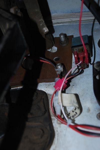

    Hardwired the start and run/start feeds in, wired in resistors for the fuel level sensor and battery temp sensor. Mounted and plumbed in the purge solenoid/charcoal canister and extended the wires in the connector for it so it would reach where I mounted it under the battery tray next to the canister.
    Looks like I'll be able to mount both the tranny computer and the PCM inside the tub, which will make the wiring for the data connector all inside the tub as well and makes the harness/wiring in the engine bay pretty clean. Need to clearance the opening in the firewall to fit the PCM connectors and figure out how to solidly mount the PCM, tranny computer will just bolt to the firewall. PCM will go up in the curve under the cowl behind where I have my Cobra CB box mounted.
    Bed.

    Wired up the fuel pump power permanently

    Found out I got the wrong fuel pressure regulator AGAIN! apparently there's some false info out there, even at the part stores, that the 4309 regulator from Mallory can be set to work with higher pressures. It's a 3-12 PSI unit and it does come with a replacement plunger for a Mallory fuel pump that will allow it to be used at EFI pressure, but only when used with that specific pump.
    So I'll return this one and I ordered the proper unit off eBay from Summit last night. The 4305M is the proper 30-100 PSI unit. My part store didn't have that one as available and called to check on the 4309, that's when they said it could be made to work, it can't.

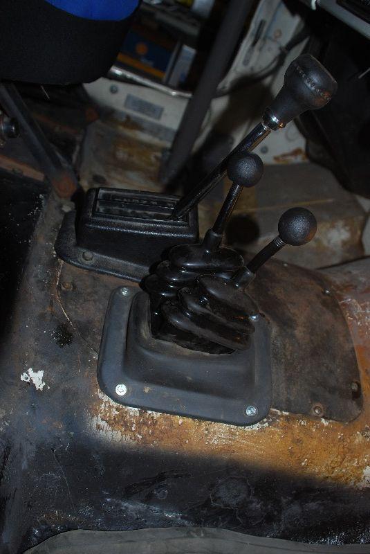

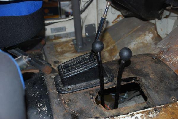

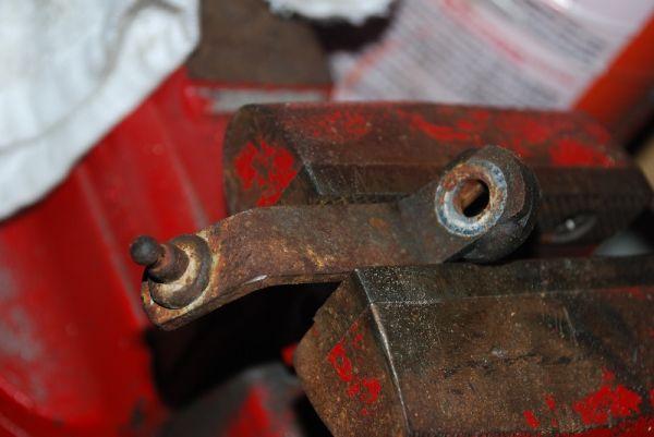

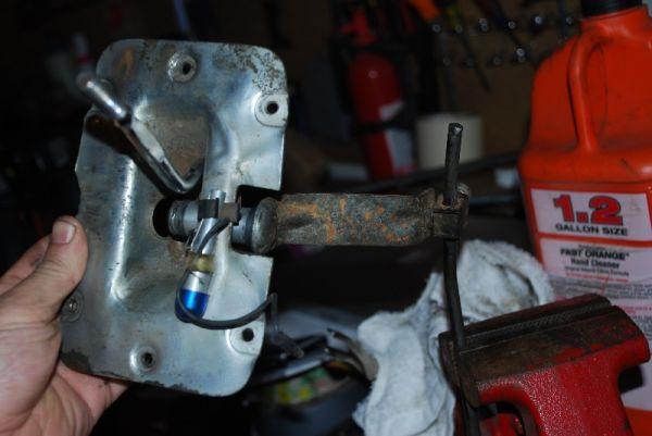

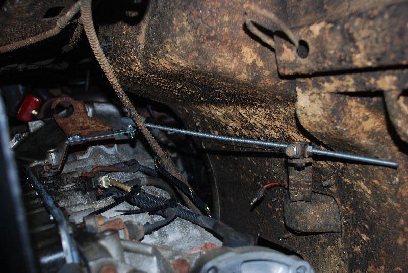

    Tranny shifter fabbed, need to try it out more to see if I have it right.

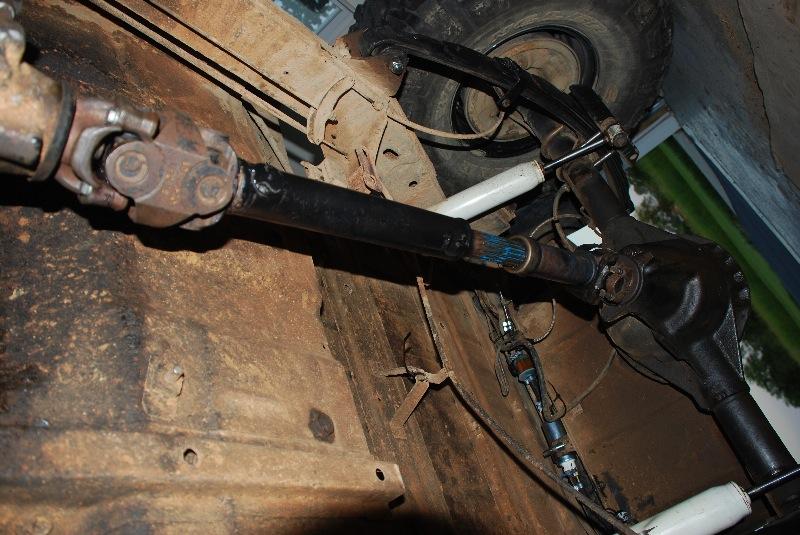

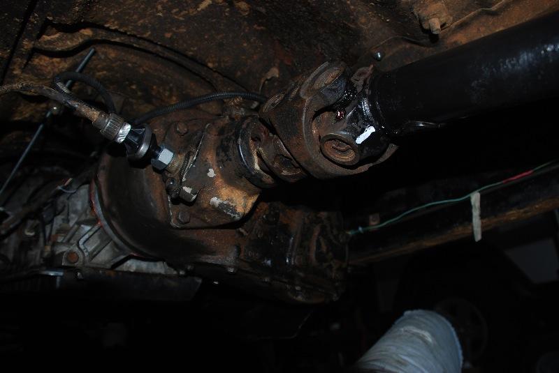

    Tcase mounted, have to shorten the rear driveshaft and lengthen the front, probably means the twin stick will have problems
    Vent lines connected and secured
    VSS/speedo cable installed

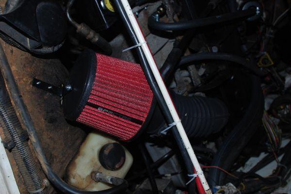

    Items left to drive (I think):

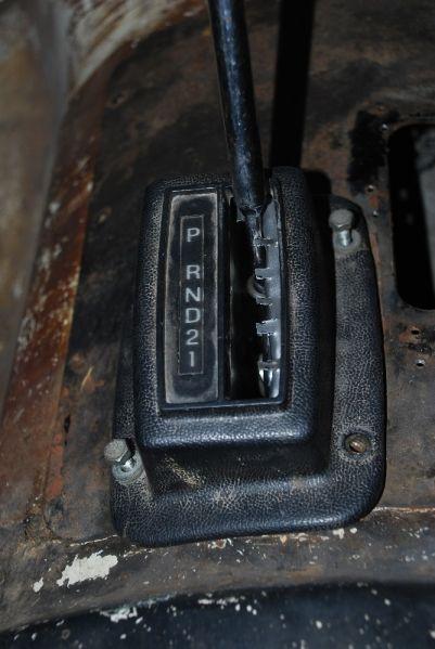

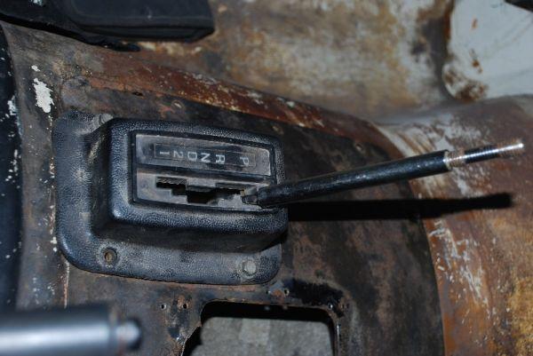

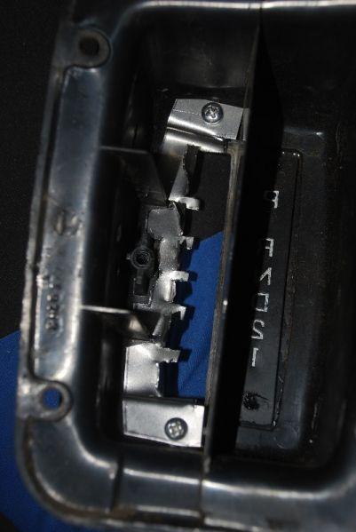

    Need to play with the shifter, P on the shifter is R on the tranny.

    Found a couple driveshaft places ~30-40 minutes from here, of course none were open on Sat. I'll probably have to talk to them on the phone and then drop the driveshafts off in the evening to pick up the next night or something, because I can't make it to any of them during the day without taking time off work I'd guess they're all 8-5 type shops.
    Pressure regulator should be here Tues. I'll slap it in ASAP, plumbing is there for it already.
