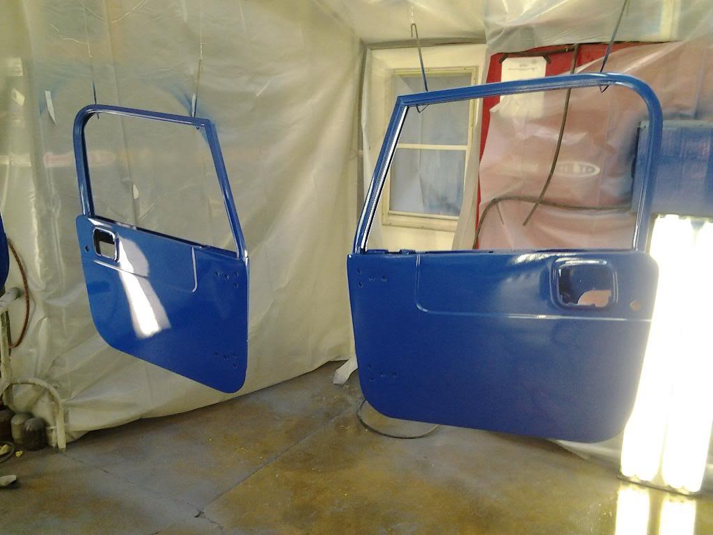

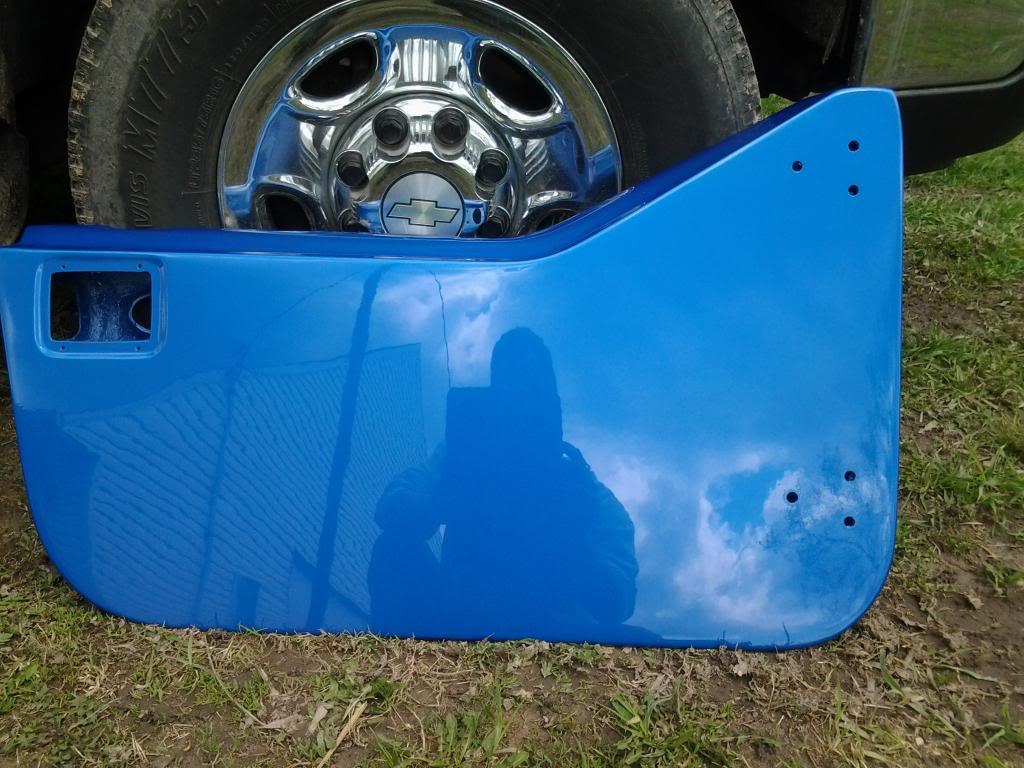

The half cab and doors

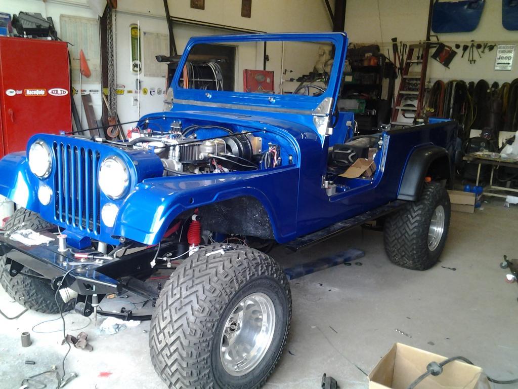

A little more about the plan.
It is going to be a daily drivable rig mainly for street, light trail, and dunes. I plan on running 33 or 35 inch tires, the motor it came with and a overdrive trans.
I have a crawler that I play with so this one can stay nice.
Putting the body mount on

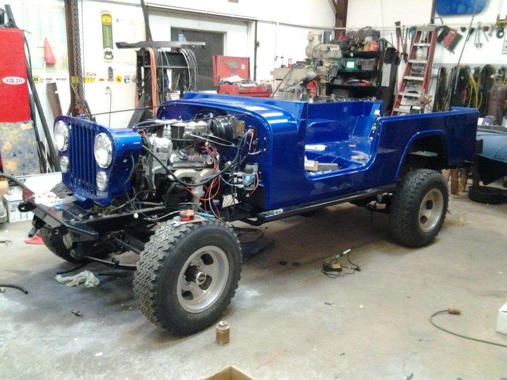

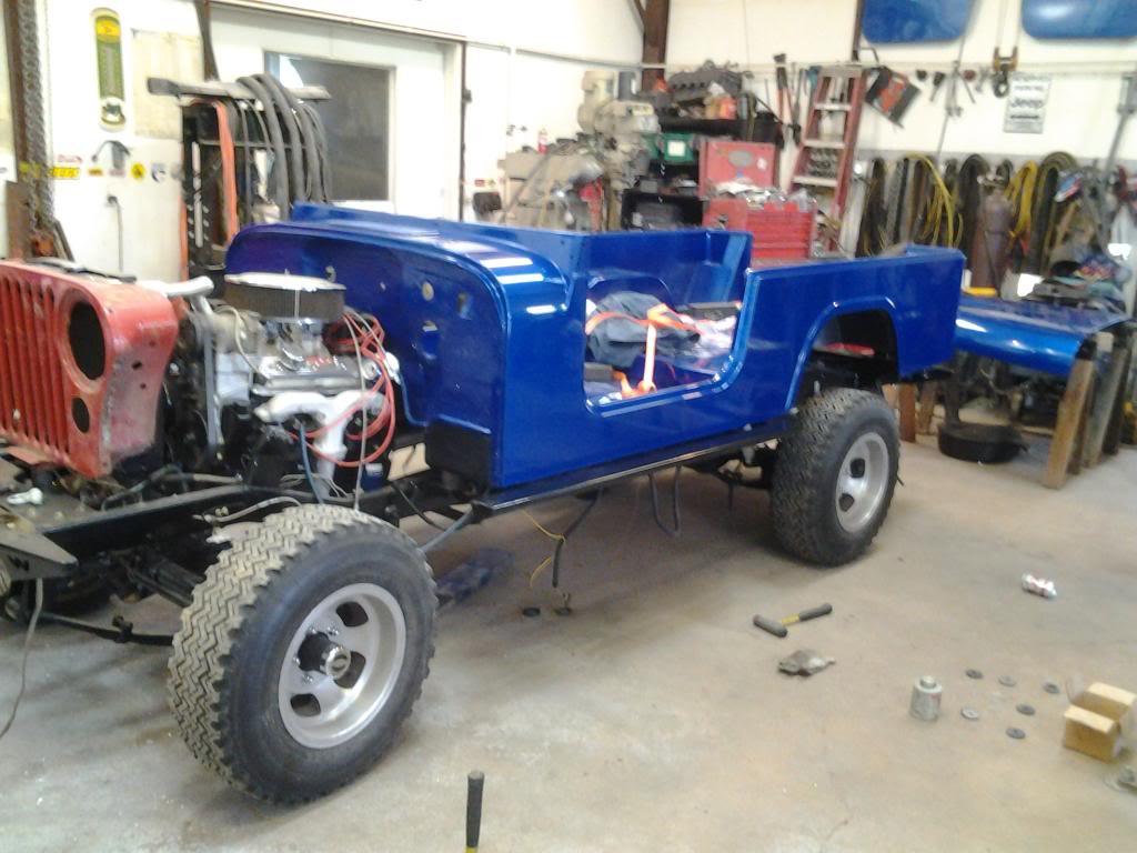

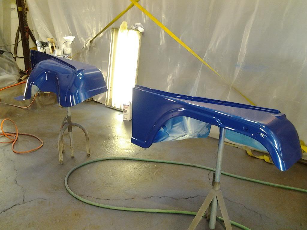

Did a little more last week

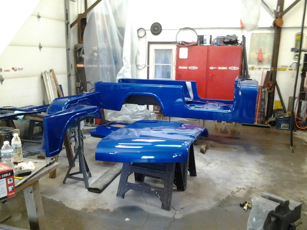

Final fit of the body and flares
Some of the body mounts, cage tie ins, shock mounts, and slider/steps
Frame ready for paint.............later today :bacon:

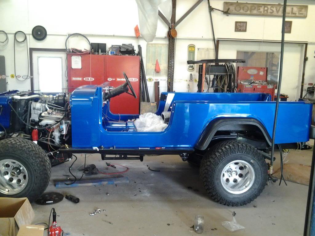

Finished the exhaust, radiator hoses, heater hoses, and fuel lines today.
Hoping to mount the steering box and power steering lines tomorrow.
fill the rest of the fluids, make a temp starter harness, and fire it to break in the engine :D
I am a little nervous, a 13 year old engine that has never been ran :huh: hope all goes well :fingerscrossed:

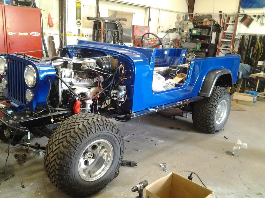

Got it fired up yesterday :headbang:
Ran great, few minor issues, now it's time to get the rest of it done :cool:
I tipped the mufflers..........Just in case it needs a anti-wrap bar added
And the t-case still needs a clocking ring to turn it down so the driveshaft will clear the 700r4 (that still needs a rebuild)

Got the "kid cage" welded up, etching primer, and regular primer on it today. :woohoo:
I think it is going to work out good, it bolts in the same holes as the stock roll bar, so I can run either one with a simple switch.

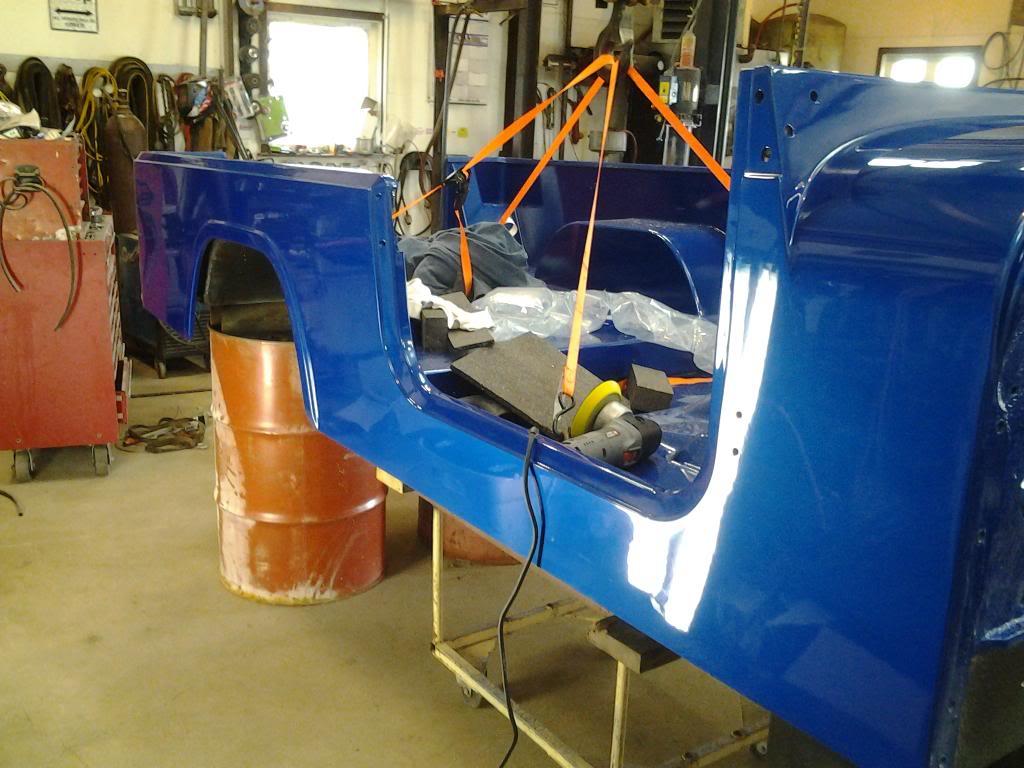

I also stripped almost everything off of the tub. That way I can start scuffing, blocking and priming.
