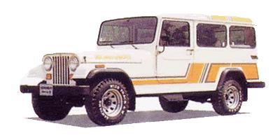

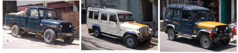

Because of my CJ-8 World Cab, I get lots of email from people wanting to know where they can buy World Cab hardtops. Of course you know the answer to that one...
But I had an idea tonight, it's not quite a World Cab, but... with the body sheet metal from two DJ-5 postals you could build a pretty cool CJ-8 hardtop.
The DJ's have one-piece body sides, so you'd cut the side panel horizontally at the right height to be a hardtop. Finishing off the bottom of the cut to mount on the CJ-8 tub would be fairly trivial.
You'd need two bodies to make a hardtop long enough for the CJ-8, but they'd be easy to piece together since they're square and parallel in every important way. The roof panels would be very easy to piece together into a longer panel.
The DJ's rear "barn door" would fit the CJ tailgate opening, and since you'd be using the DJ sheet metal from the belt line up, the door would of course fit there also.
The only original fabrication would be the side door jambs; to use the normal CJ swinging doors you'd need to build the jambs from the belt line up. Wouldn't be too hard though.
This would be a very straightforward project, not really difficult at all. Certainly no more difficult than the hardtop I'm building for the Retro Wrangler right now.
Of course it wouldn't look like a World Cab really, it actually would look quite a bit like a Land Rover 109 hardtop because it would be more square than the World Cab. The 109 in the photo below has smaller side windows, but you get the idea.
What do you guys think? Goofy or cool?

So you'd end up with massive side windows? There wouldn't be much sheet metal on the sides as I picture it in my head.
With no rise on the front part of the roof, would it clear the top point on the rollbar?
It would certainly be a different look, that's for sure. I'm trying to picture an -8 with completely vertical back corners, every top I've ever seen had some degree of slant to the back wall.
Where do the hinges fall on the DJ door? I've never looked at one before.

Should clear the roll bar because the roof panel is fairly deep, I think at least as deep as the deepest part of the World Cab top.
DJ rear doors I believe have long piano-type hinges. Might need to replace these with standard CJ-type door hinges for this application.
