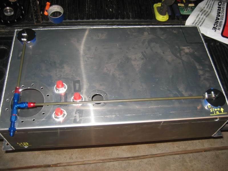

I worked on the Fuel cell guts. I got these fuel pick ups from Auto Performance Engineering. (MP-12 & MP-13) Some fittings, high pressure fuel line, hard line, and stainless steel hose clamps.
http://www.autoperformanceengineering.com/html/pickups.html
Here is a layout of the guts.
Here is an inside view of the guts inside (Passenger side)
Here is an inside view of the guts inside (Driver side). Note the return line (elbow not in pic yet) dropping right back on the fuel pick up.
