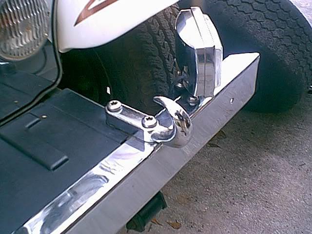

If you need just tow hooks up front, I used YJ hooks with large thick washers under the frame rails. I'm not worried about ripping them off. Pulled from several times with no issues. Yeah yeah, I know the're chrome...It went on a Laredo package. I had to drill the rear holes.

snapped one of those hooks off. Granted I was snatching on it, but figured the rings would be a little stronger. Had the hooks for a long time before I broke one though....

I to used YJ hooks, had to drill and used grade 8 bolts, washers, and nuts. Your frame cover really dresses the area up also, looks nice.
