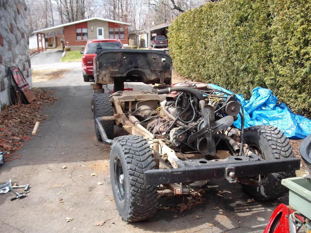

starting to take her down !
got the tub off ..

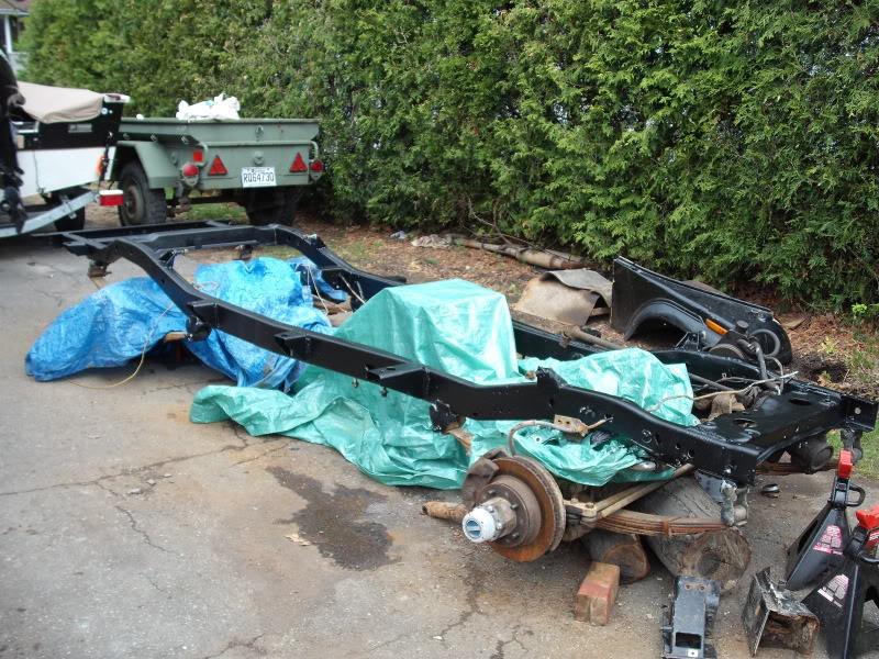

got the welded junk of the frame
new rear crossmember welded on the frame

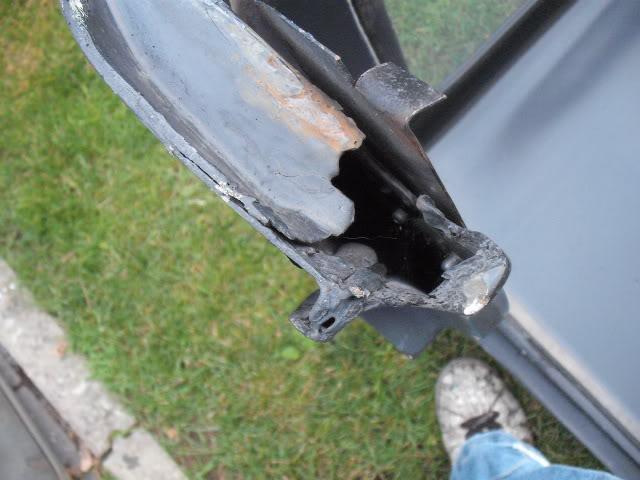

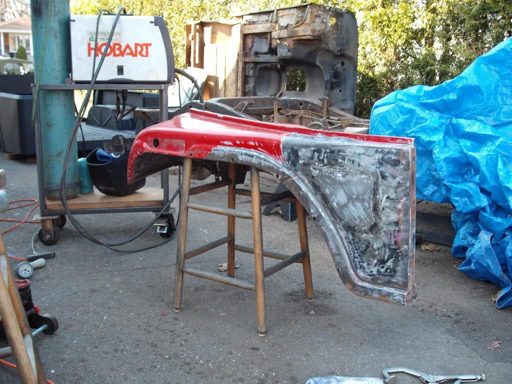

a little welding on the replacement front fenders , the old one's are all roted out from inside

now here is the tub and the frame with a few coat Rust bullet

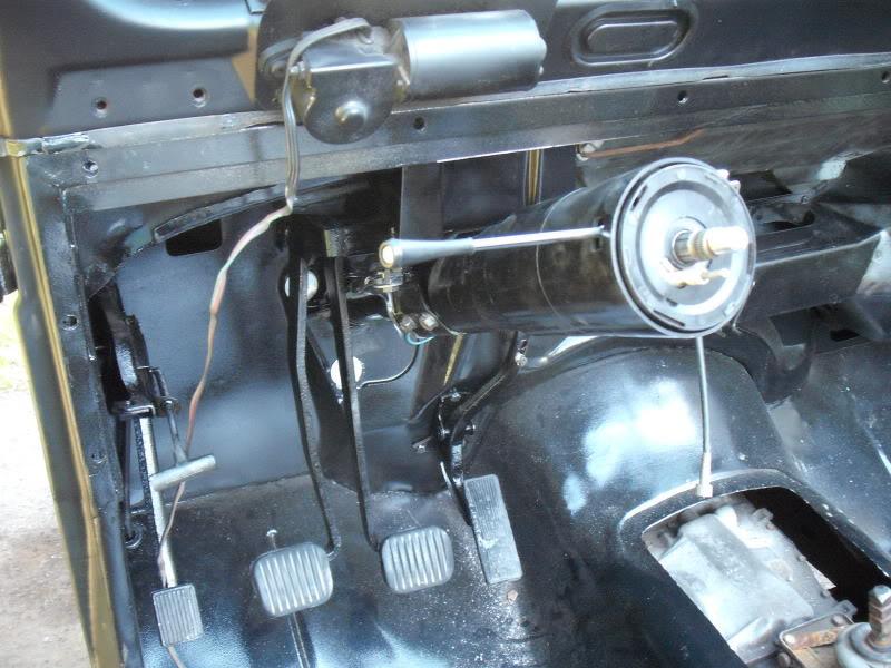

after rebuilding the steering column and por-15 on the pedals I got them back in place

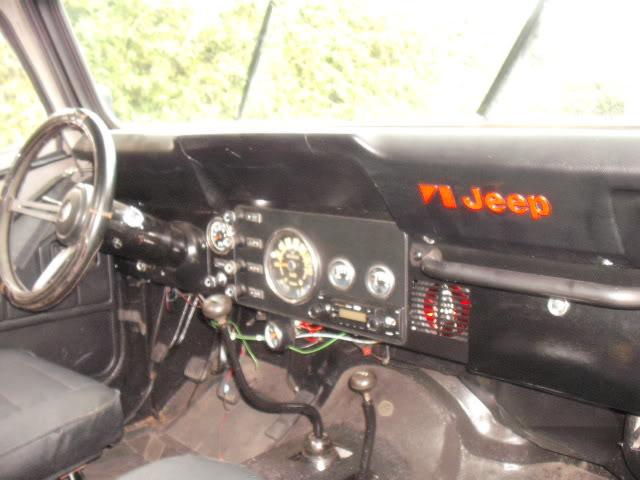

then the dash got stripped and painted, then got the wiring done on all the gauge

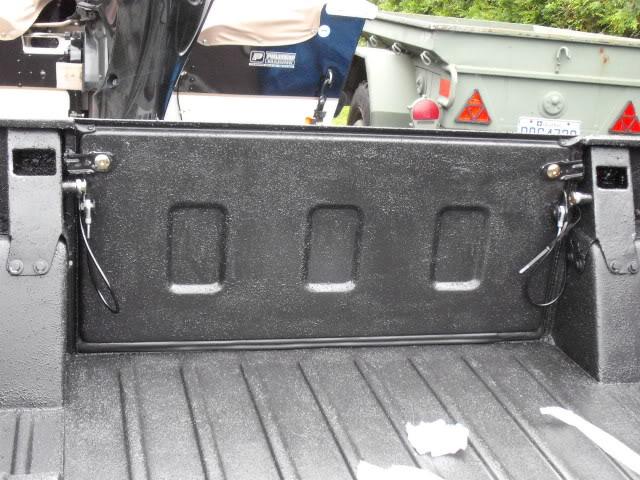

now it was time to put the bedliner in 4 coats should old up pretty good
when I got the Jeep it had no tailgate so I had to put some tailgate bracket and cable

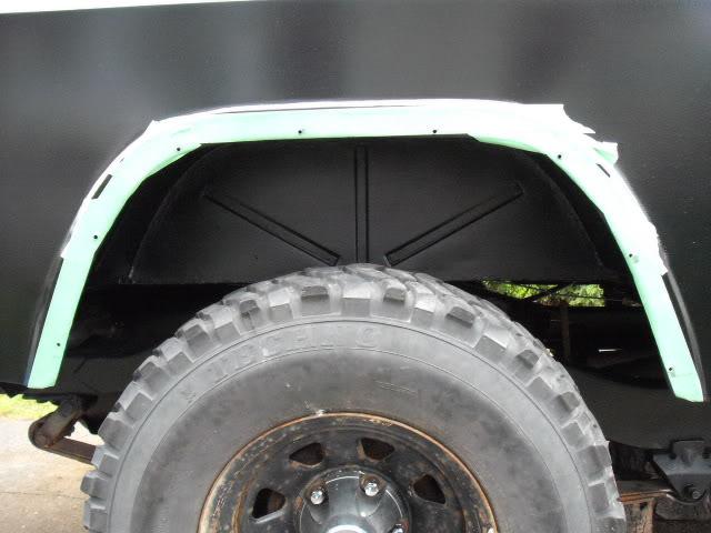

there goes the roll bar and some drilling for the flares
