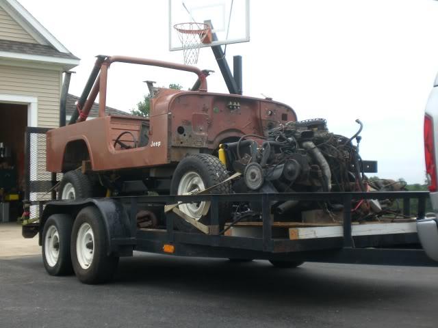

Like I said, the plan is to use the driveline currently in the ‘7 and transfer it all over to the CJ-8. 2 weeks ago I purchased this Scrambler in Milwaukee, WI. It’s all in pieces but here’s some more info.
- Titled as a 1984. 63k original miles. Frame is a 1984. Previous owner blasted and repainted. Since I’m picky it just wasn’t up to the condition I wanted it to be. Unfortunately it had been used as a plow truck. So the tear-down began since it was a rolling chassis. Had original Dana 30 front axle and AMC 20 rear axle. Had the frame blasted last weekend. I’ve been working all this week on patching it.
- Tub is a 1981 rust-free original from California. Just a couple minor dents that should be fixed but other than that, no rot and it should be ready to go to the sandblaster shortly. Rust-free fenders, windshield frame, grill, tailgate, etc. from California as well.

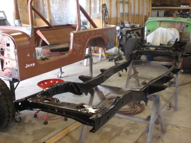

Removed the tub, stripped the frame all down and got it sand blasted. The frame had some patchwork that needed to be done.

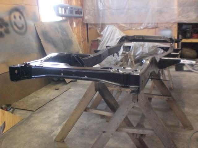

Made some more progress on the Scrambler over the weekend and this morning.
Finished patching a couple spots on the frame. Also purchased and welded on a new rear crossmember. Most of the frame is now covered in 2 coats of POR-15. Just need to flip it over one more time after it dries and do the bottom again. Then it should be ready for primer and a topcoat.

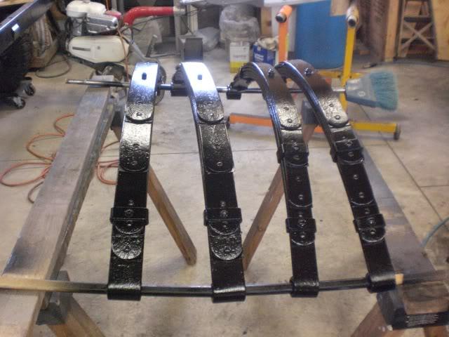

Got the 4" lift springs sand blasted as well and gave them a coat of POR-15.

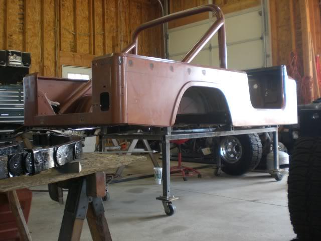

Welded together a cart to roll the tub around on.
Stripped just about all of the components out of the tub and off the fire wall. Roll bar is loose, just needs to be lifted out. Going to weld up some little bolt holes in the bed sides (wire-wheeled the paint off in those spots) from a soft top someone had over the back, then it's off to the sand blaster.

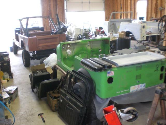

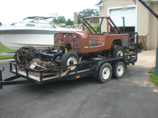

What is the blue marking on the rear quarter panel? It looks just like the symbols first responders spray painted on houses/vehicles here after Hurricane Katrina. The various numbers/letters indicate when it was searched, dead bodies found, etc. Not saying that is what is marked on your quarter panel, but that is exactly what it looks like:shrug:
This is what i am talking about
forum
Very good looking project.
Hmmm....interesting. Actually I really don't know. The previous owner told me that his brother pulled it off a jeep that was in a junkyard in california and hauled it back to Wisconsin for him. I just assumed it was markings the junkyard used but don't know what any of them indicate. I do know it has a date of 2004 painted on it so I'm guessing that was when someone brought it to the yard.

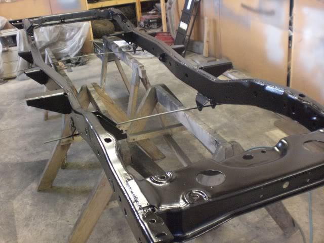

Got the frame primed and topcoated as well as the springs. It's now ready to start assembling again.

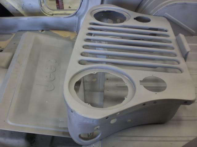

Welded up all the soft top holes. Got the tub sandblasted as well as some other parts including the fenders, grill, and tailgate. Here's some pics. Some sand that has to be cleaned out yet. Should have it primed within the next couple days.

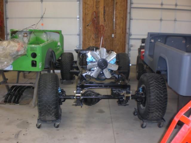

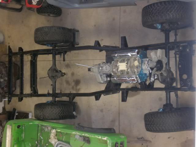

Here's a pic of the CJ-7 currently. All of which will be swapped over to the CJ-8 frame.
Busy with college but here's a quick update....

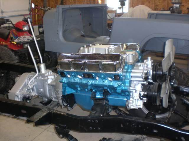

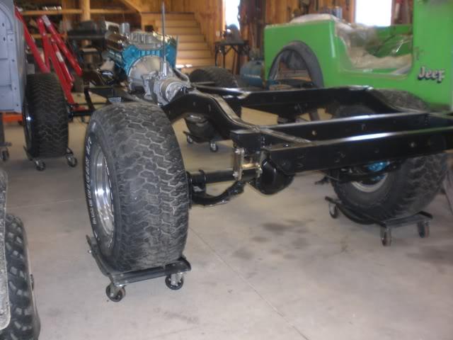

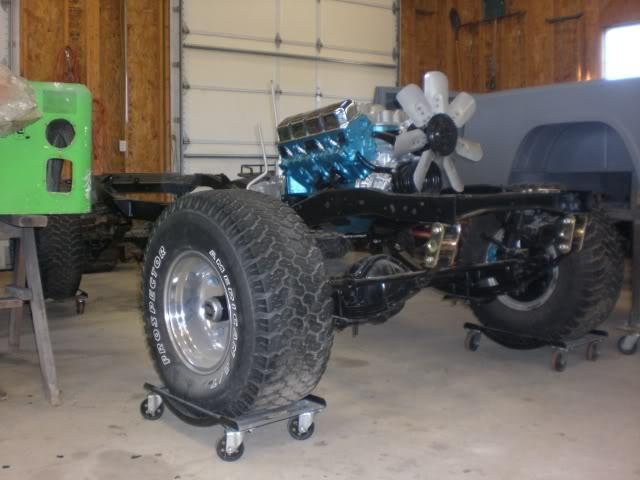

Engine, axles etc. all on the Scrambler frame now so its a rolling chassis.

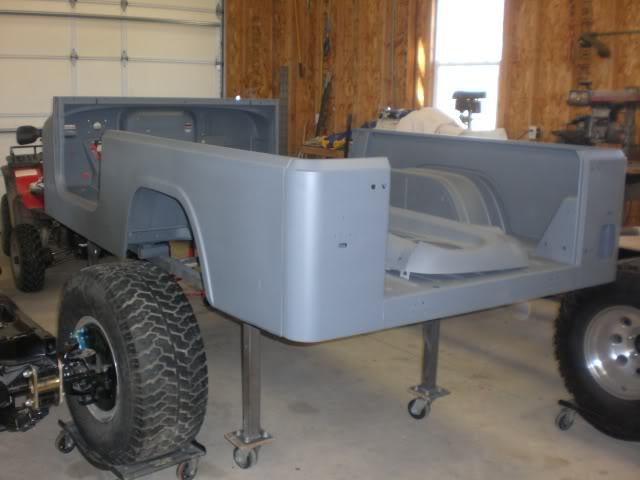

Tub, fenders, grill, tailgate all primed.

On Christmas break from college currently. Haven't made much progress since my last update. Tub received another coat of heavy primer.
Installed my headers:
How it currently sits:
