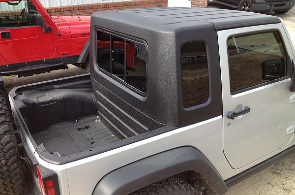

Here is our existing 2 door recruit JK hardtop. It reuses the freedom panels and does have fair amount of cab room. Some side portal windows that are somewhat of pain in the sense of installing gasket etc. But, they look good. But, this top requires that you reuse your factory freedom panels.
Here is one of the prototype 1 piece JK half tops below from last year. Dimensions and proportions will be similar. It is a bit shorter and does not have the side portal windows, but gives a bit more bed space.
