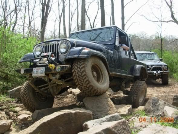

SOA lift (lift hieght depends on thickness of axle housing)... This set up is WAAAY better than spring lifts (in my opinion). But there are MANY draw backs to this. You need to know what youre doing if youre gonna build this kind of suspension. Issues that need to be addressed: steering, axle wrap, the list goes on... This system has many benefits though IF DONE RIGHT...
smoother ride (flatter springs) and more suspension movement (flex). Axle wrap is a big problem. I snapped the output shaft on my 300. I was building a torque arm but didnt get it installed in time before leaving on a trip. Drove the Jeep 3 hours to get to the event, snapped the tcase on the very first obstacle. fun.
people who say SOA is cheaper to do than a spring lift are idiots. It is NOT cheaper, when its done properly. I paid approximatly $800 for my 4" spring lift (springs, shocks and brake lines)...
in contrast, I lost track how much i spent on my SOA. steering alone was well over $1000 (histeer arms, tie rod ends and misc materials), everything else I fabbed, including tie rod, drag ling, torque arm, all mounts. dont remember what I paid for shocks and brake lines, but i think you get the point, SOA is EXPENSIVE when done properly...
