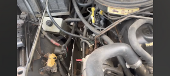

I would worry about the pump cavitating if it sits too long and the fluid drains back down to the reservoir. Maybe if you could run both lines higher than the pump before dropping to the reservoir it would act as a barrier to the fluid draining out of the pump itself.
Or perhaps an anti-backflow valve on the in-side of the pump?
IIRC, pump was mounted below the alternator, kind of low on the engine in the CJ7. The reservoir was mounted to back side of passenger fender, so reservoir and pump about same height. Can't remember how the hoses were routed, pictures on my thread might help.
EDIT - no pictures of hose routing. Top of reservoir was mounted higher then pump. Pretty sure you want gravity helping you out here.

Unless I missed something I couldn't really find any pics of the tank. Even online I couldn't find anything. I took this screenshot from that video in your thread. I just wasn't sure how high it was in relation to where the pump was.

This is my concern as well. I think I'm just going to remount it just to be safe. I'm going to eventually replace this fender anyway so I don't mind drilling a bunch of holes in it.

I relocated the tank. The top is at least 4-5 inches higher than the pump. I think I'm good now. I just added some angle iron and made a little brace. It is super solid. The fittings are also pointed in a good orientation too.
