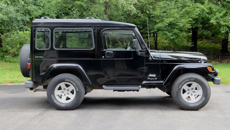

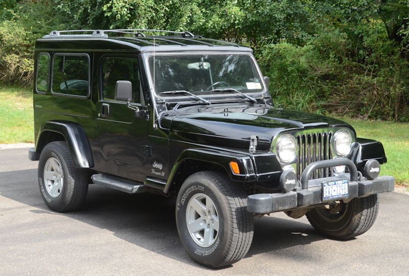

A few photos of the LJ Safari Cab, the concept image above looks pretty much like this...
