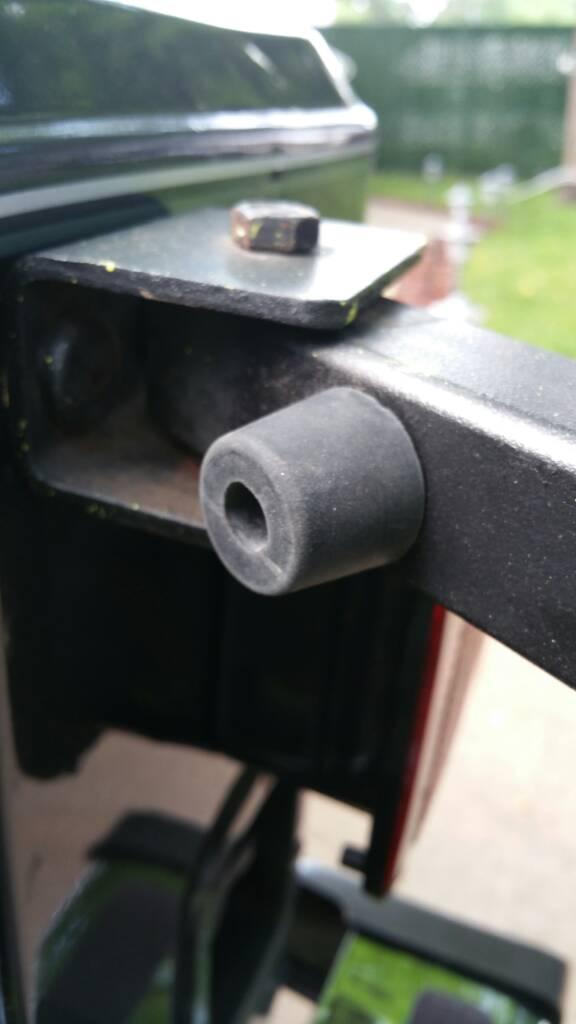

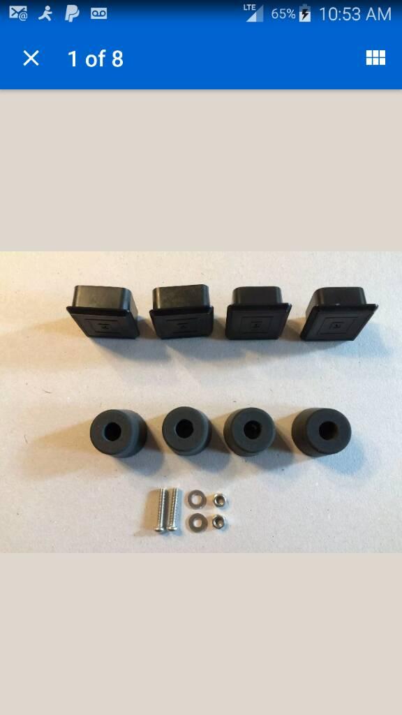

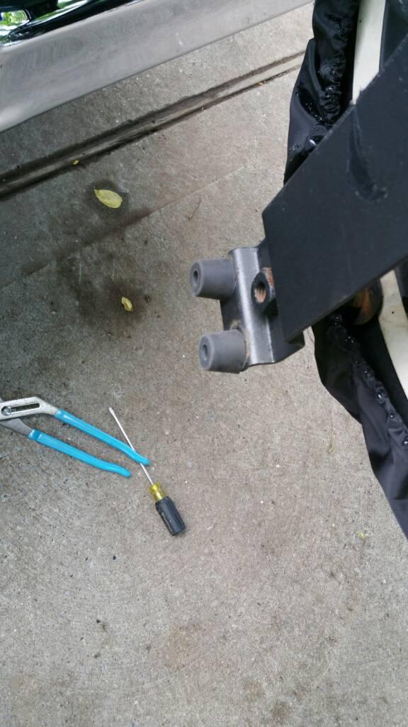

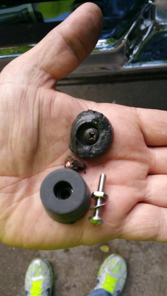

Got these off ebay to replace the crazy worn out bumpers that are on most of our swing carriers. I bought the kit with the screws but your going to need longer screws for the top bumpers as they are not supplied and the original are to short. The bottom bracket for the tire had to be reajusted but when closed the carrier doesn't shack and it really solid now.. worth the 17 buck upgrade..

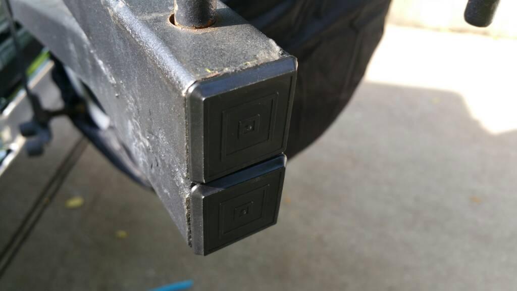

While i was buying those bumpers i bought the endcaps to the carrier as well. Not like anyone but us would notice but it keeps the water and bugs out from making there home in there. I used a little silicone and the pop right in. Had trouble with one of them as the tube was out of wack. Little smashing and it fit great.[emoji106]
