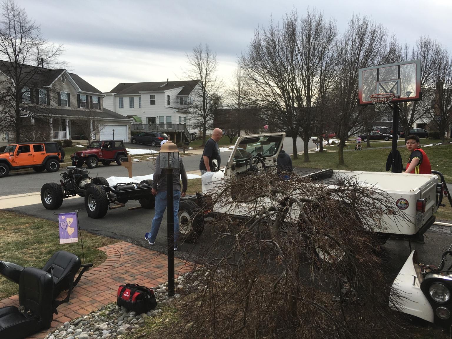

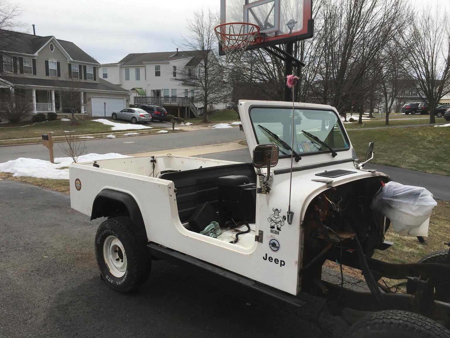

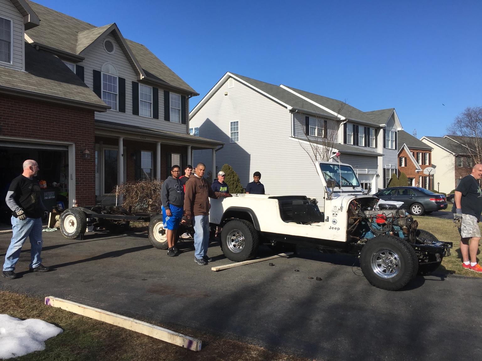

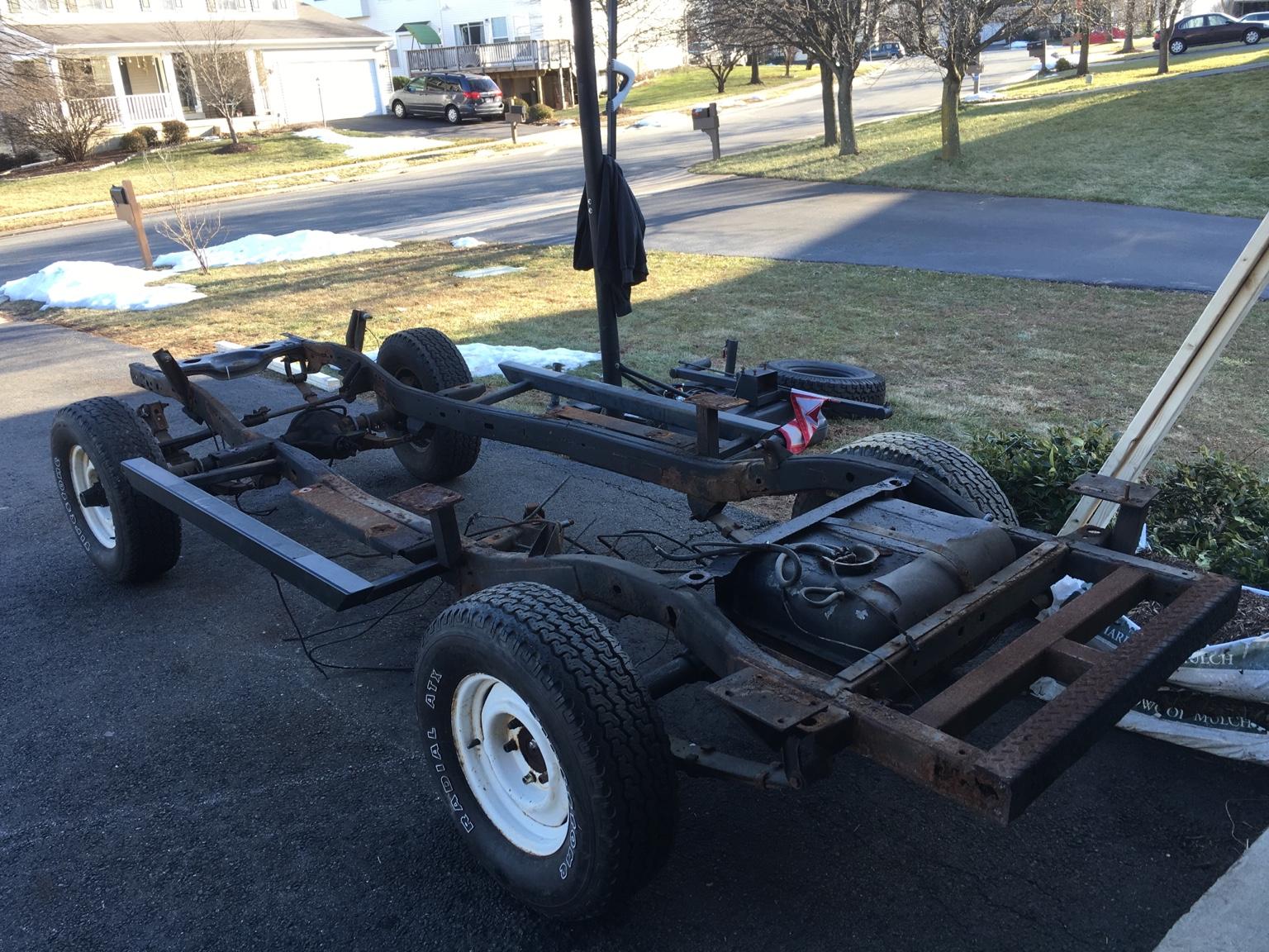

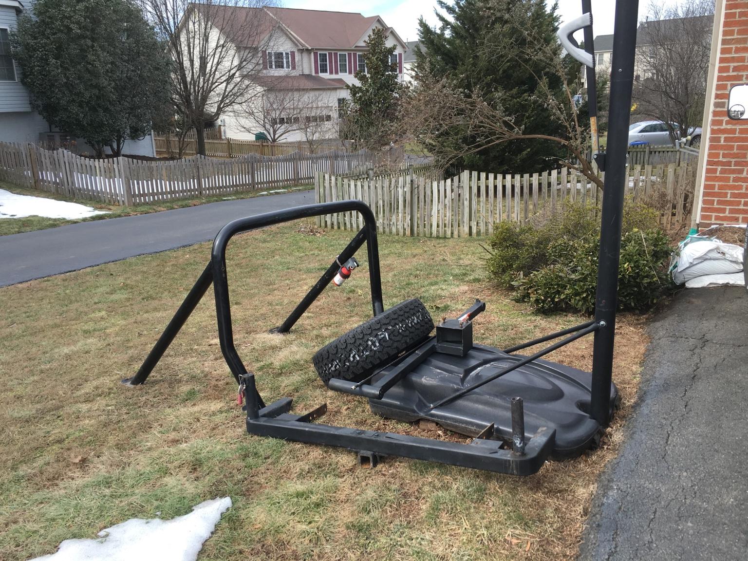

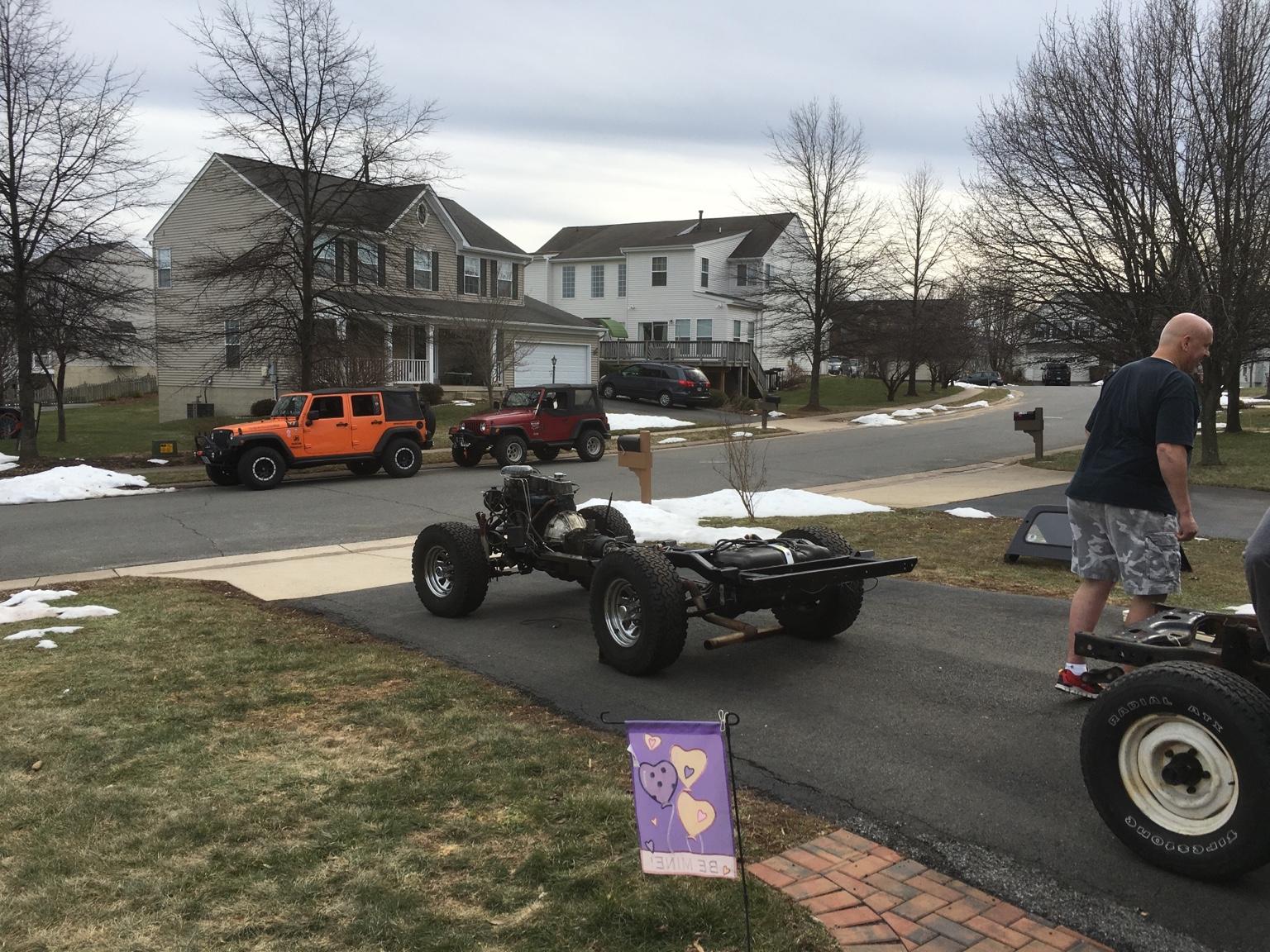

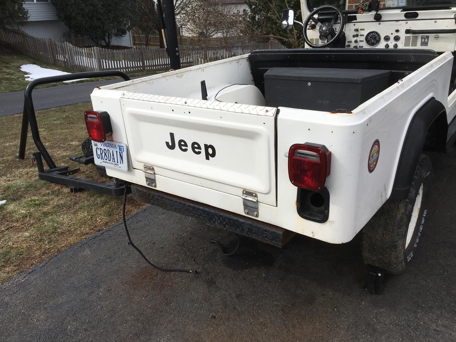

Made a lot of progress today. Started by taking off the rear bumper, the seats and the top. Then folks came over and we started to get to the body. After a lot of aligning the jeeps just right and prepping the 2x4s, we started it. The picks that I cut work, but some will have to be redone as they are not thick enough. But I can do that in the garage now. Here are the pics and a video.
I am so frigging happy to get this done today. There is a light at the end of this tunnel. I just hope the HOA does not mind the old chassis in the driveway for a little longer.
Nice job guys! Dang Dain your gonna be done before me and I'm only swapping the engine. But I'll be done sometime this Spring. Starting to look like the Scrambler again.
Thanks Pete. The rush is on now. Planning to take it on the trails in May. So I want it driving in March so I can work some bugs out.
Great work. Having a folk lift is easy but nowhere near as much fun as a bunch of mates helping out.

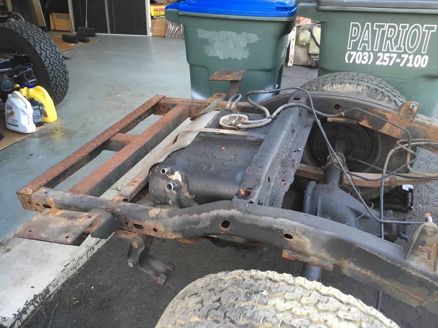

Today was a planned wrenching day. Tomorrow is reserved for family and chores. Gotta split it up. At least now the assembly can take place in the garage so I can go out there in the evenings and on cold or wet weekends. Hopefully things will speed up.
I just hope I remember where things go. I am sure I will be asking.
