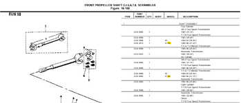

This from the Factory parts manual might help in your search.
(The "88" is CJ8. 87 is CJ7, etc.)
Supposedly this would be correct for factory stock, new suspensions.
