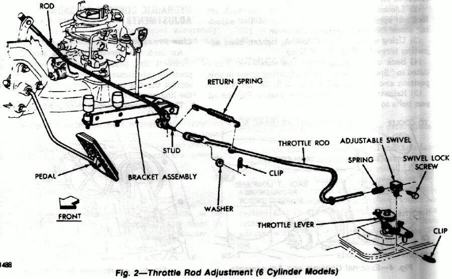

Where does this belong? I thought it was part of the floor shifter mechanism but it appears not so now im not even sure if it belongs on the Scrambler at all. Anyone know?
It looked like a automatic linkage but cant find my pictures to confirm it..
Sent from my SPH-L900
That would be my guess too... I don't have anything that looks like that on my RHD, and it is a manual, so the theory so far is still valid.
E-brake mechanism was another thought, but I don't think so.
I have the automatic linkage for the kickdown, this is a far beefier bit of unknown origin.
I will leave it off for now and see what doesn't work properly at the end:D
I will leave it off for now and see what doesn't work properly at the end:D[/QUOTE
yea I just checked my auto linkage and kickdown on the 258 999 and its nothing like what you have.. It did look like the one in the picture I posted before..
heres one of mine.. the part I though it was is actually a very thin and kinda wire looking linkage .. its way on the bottom of the picture I posted
Thanks for looking anyway, it will either become surplus to requirements or obvious at some point i am sure......

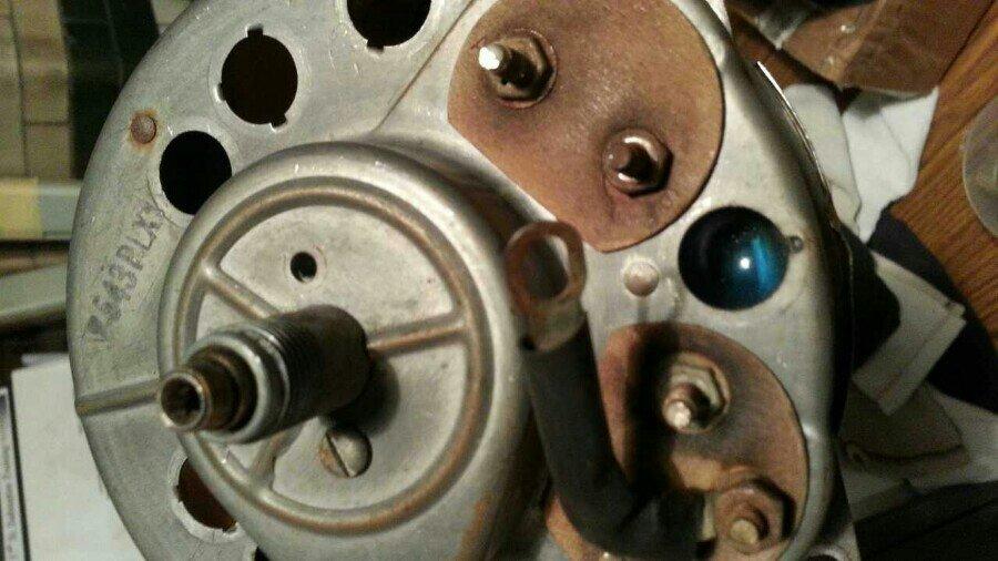

Body tub has made it to the painters so i thought id try and sort some other stuff out starting with the clock which just clicked when i tried it and then that was it.
So one strip down a lot of prodding to find out how it worked and bingo i have a working clock
Did AMC have different colour surrounds depending on the body colour?
My clock has blue inside to presumably give a blue light when illuminated and everything else in the Jeep seems to be blue inspired....
If your talking about the blue filter that the bulb eliminates threw then there all blue.here is a blue speed filter glass I took a picture of .I never took my clock apart so I dont have a picture .
So even if you bought a garnet Jeep you got blue illumination in your dashboard, that is brilliant:D
