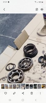

Thoroughly enjoyed putting this gearbox back together, not something i have ever done before and pretty pleased on how its turned out.
Main issue i had was the rebuild kit bearings were unbranded and felt notchy straight out of the box so they ended up in the scrap bin and i just went and bought some proper ones from the local bearing suppliers.
Only other thing i could fault in the kit was the snap rings didn't seem the right sizes so i ended up reusing some of the old ones.
The replacement main shaft installed exactly as it should do, not what i usually find with Crown/Omix parts, i was bracing myself expecting a nightmare, but no that seems to be made correctly, proof will be when its got a few thousand miles on it though i guess.
