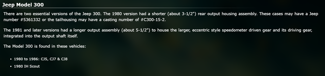

I was going to ask about any adapter that might have been bolted to the one you took out. Manuals aren’t my strong suit but either that or a Tcase input vs trans output difference was my thought.No Jeep Dana 300 will bolt to a t19 without an aftermarket adapter
I have the novac adapter and it may be in correctly. I will have to see when I put the shifters inNo Jeep Dana 300 will bolt to a t19 without an aftermarket adapter
