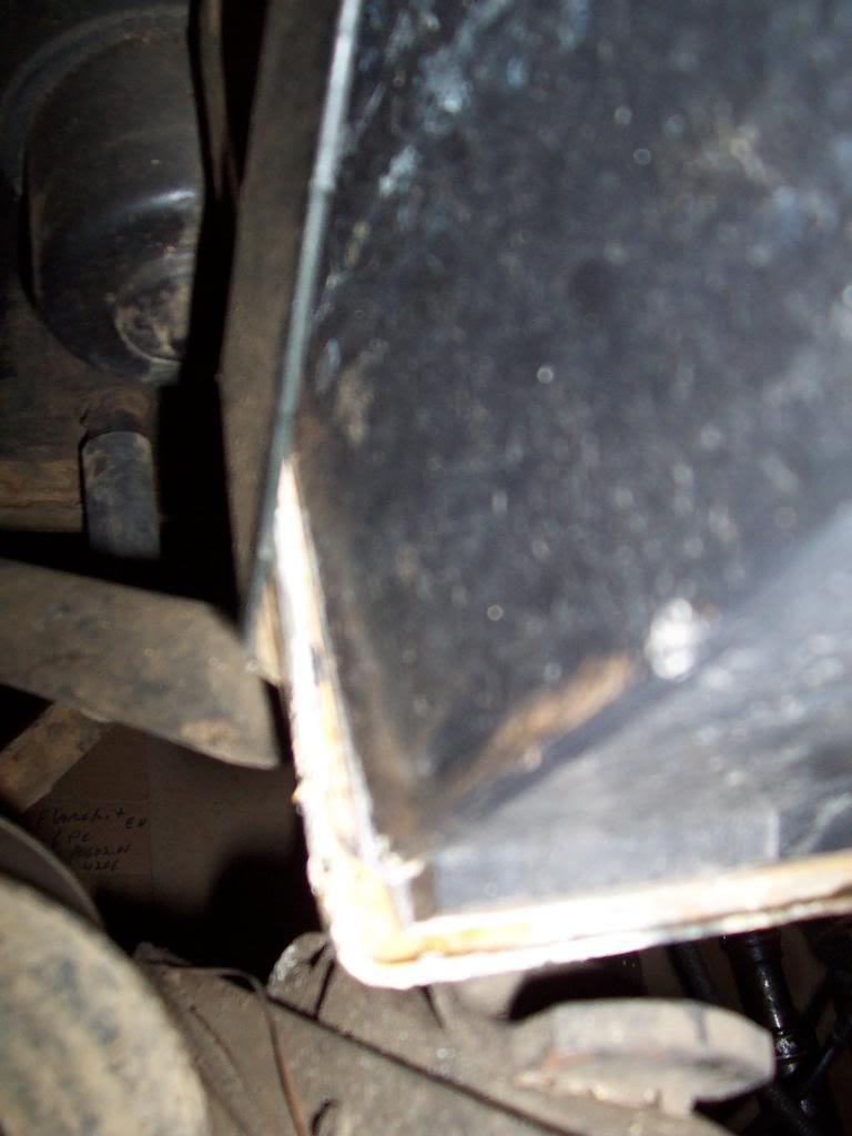

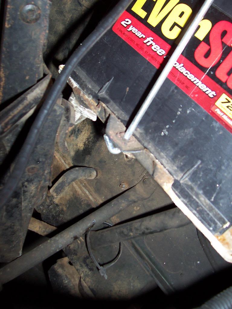

Here are some pics that I took of the fender/body tub braces. Hope these help you out.
These first pics are off my green Scrambler. It is kinda dirty, but all these braces are painted the body color. Pics aren't the clearest because it is hard to take pics of these areas with all the factory mounted stuff in the way.
Passenger side, 4 braces total. Two hold up the battery tray, two go from body tub to fender.
