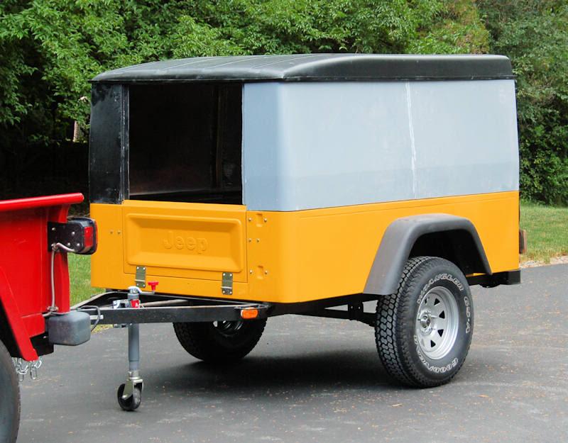

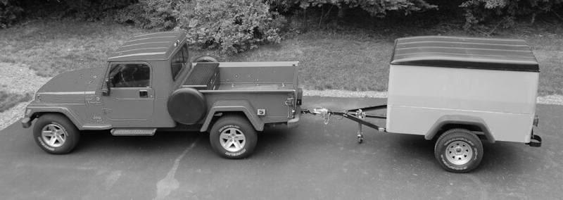

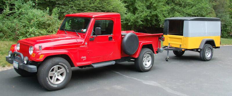

Hey Jeff,
I just had a thought. Is there any interest from Matt's fiberglass guy of making a tub similar to the one on your trailer. That way he could offer a Trailer body to the Jeep folks out there?
It would be great to get one out of steel, but I am figuring that the process of getting stampings would be very expensive. Wonder if that place out of the Philippines would be wanting to stamp a tub for a trailer similar to yours. Might be worth an e-mail to talk to them about it. Great thing is that there would not be a big fitment issue with an existing frame like on a replacement body.

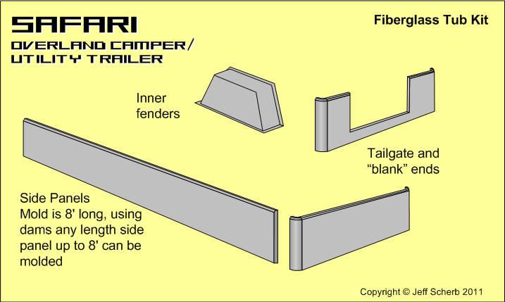

Hey Carl,

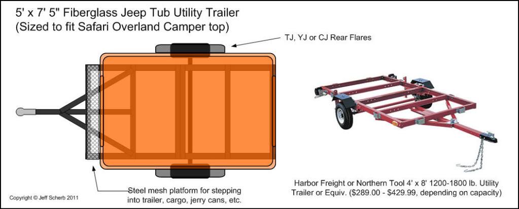

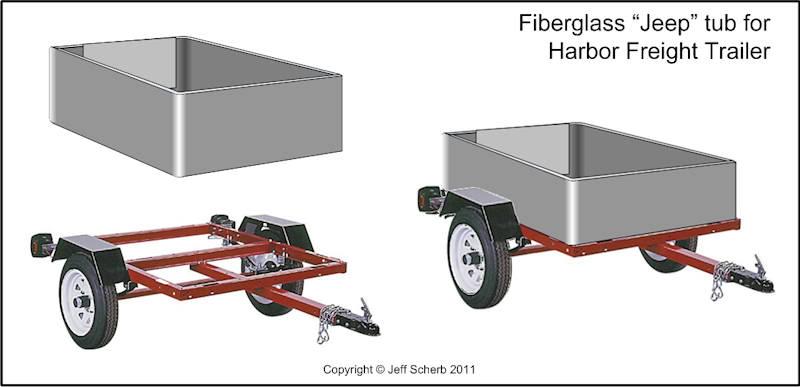

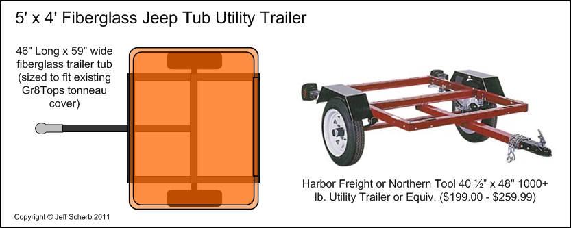

I've been doing some design work on exactly that. I've come up with a concept for a modular series of molds that could make pretty much any length Jeep-style trailer tub in fiberglass. The "kit" would consist of side panels, which could be any length up to 8', end panels in either tailgate or "blank" style, and inner fenders.
The floor could be either fiberglass, metal or plywood, there are a bunch of different ways to go with that. There would also be some fiberglass angle brackets that would reinforce the tailgate opening so it could support either CJ-style tailgate cables or Wrangler-style hinges/striker pins. Those aren't shown in the drawing.

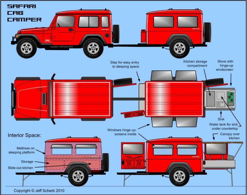

If someone wanted to offer these commercially, they could be made available fully assembled in a range of standard sizes to fit various trailer frames that are on the market, or they could be offered as a DIY bond-togther kit so someone could make a custom size trailer. Add the necessary Safari Cab side panels, roof and barn doors/hatches and you could make a Safari Overland Camper trailer.
They could be offered in a range of standard sizes (either assembled or in kit form), to fit a range of the inexpensive trailers out there, like those from Harbor Freight:

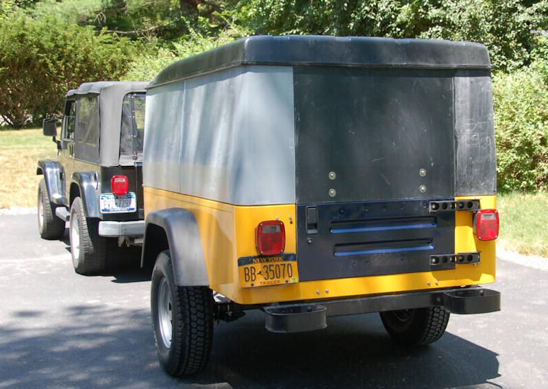

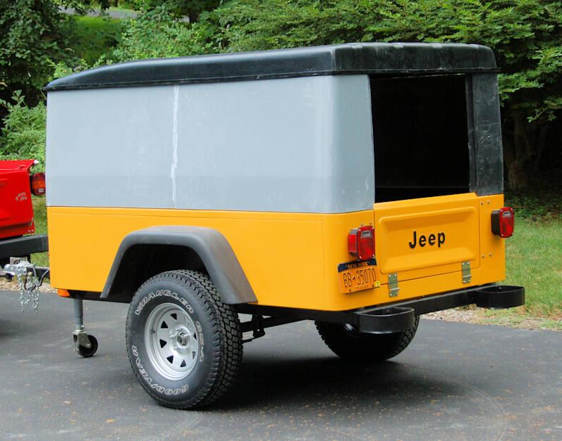

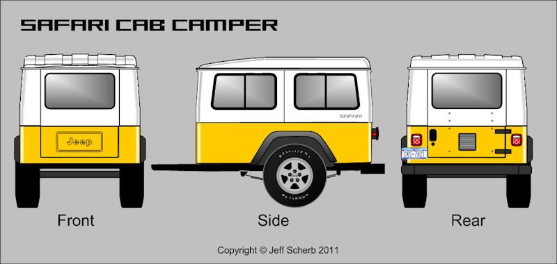

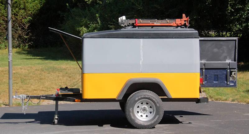

I really like that trailer and topper on it, But I think that I would prefer to see the sides have windows.
Me too, I just haven't gotten to doing the windows in mine, but I do plan for windows.

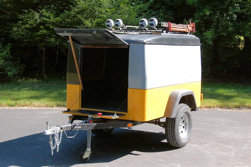

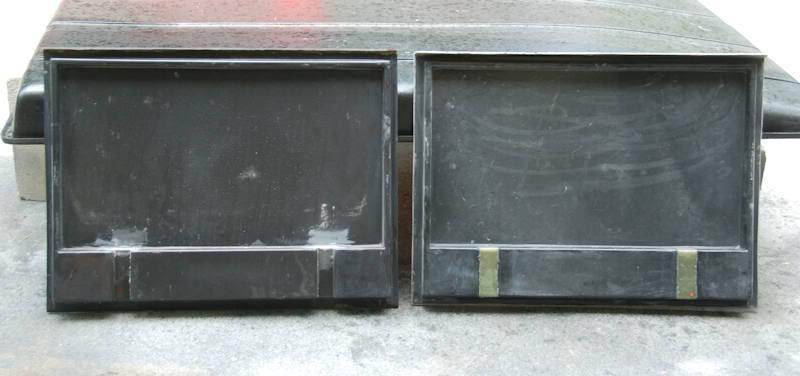

I could either use the standard Safari Cab LJ sliders:
or maybe some swing-up windows:

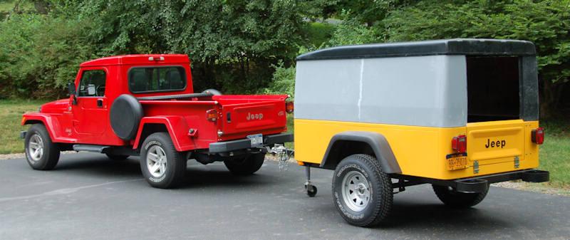

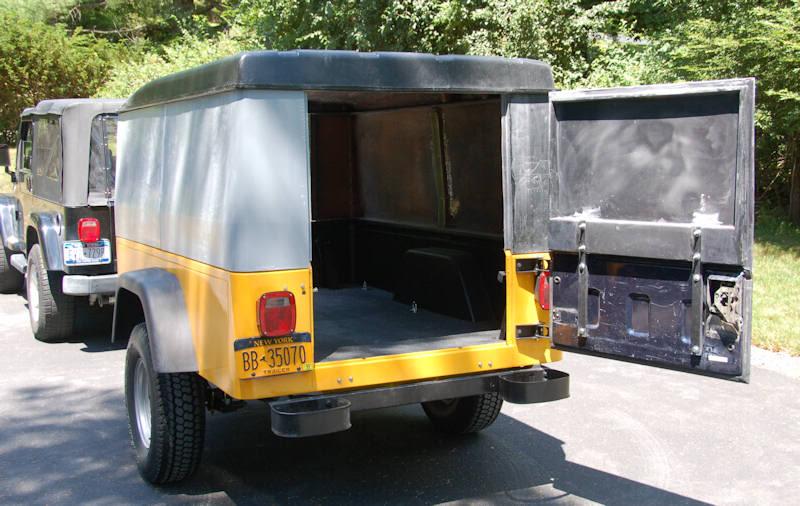

Did you make the trailer so that it uses the standard LJ top. That would be something to consider, then you would have one less part to make.
Yes, the trailer tub is sized so to be the right size so that the standard LJ Safari Cab roof panel fits it, no new mold to make for that part.

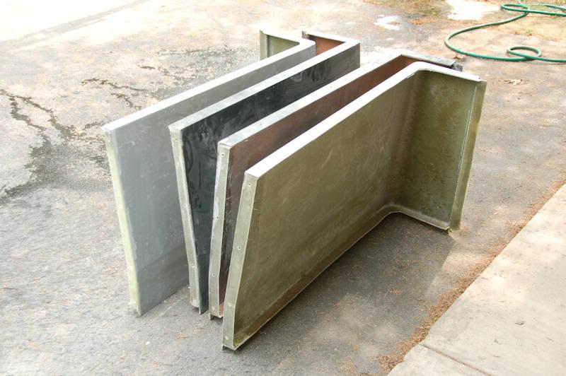

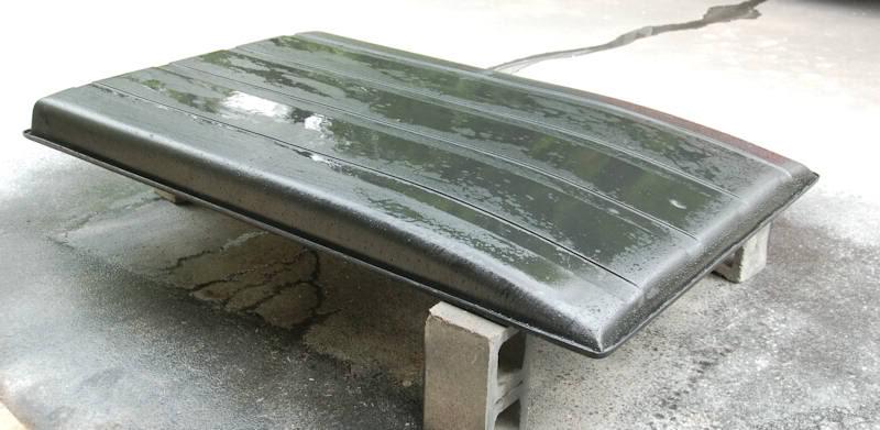

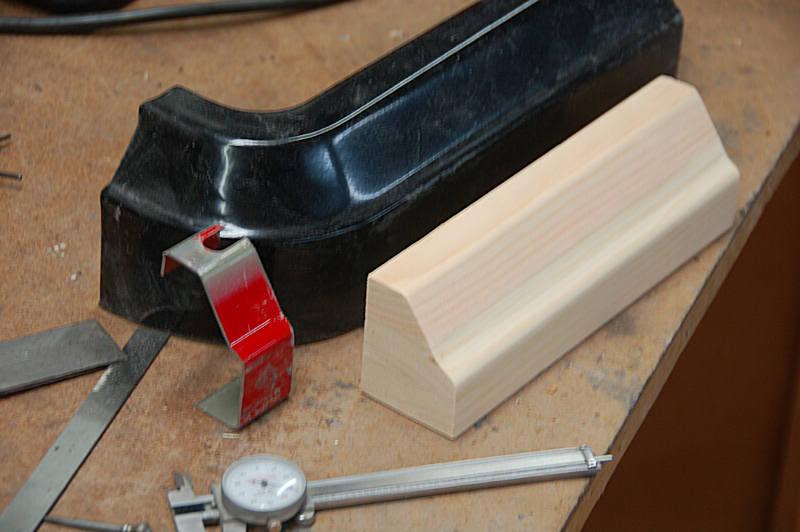

Making the molds for these would be pretty straightforward; I've already done a little experimentation in duplicating the profile of the top of the Jeep tub for the mold:
I'm seriously considering making these molds, I'm trying to gauge interest in them.
