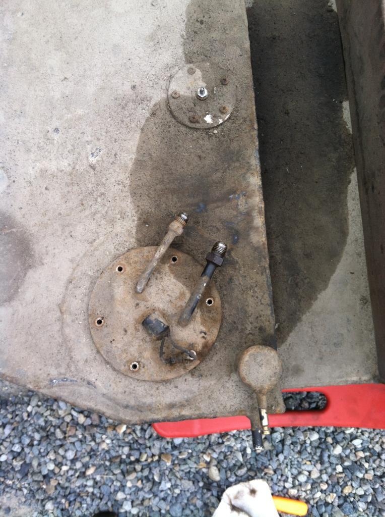

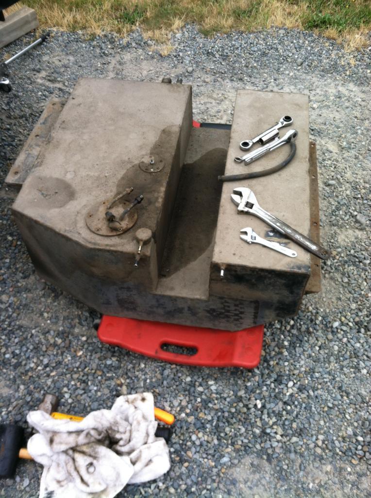

So I dropped the tank this morning and this is the Beast! Made by Aero Enterprises according to the shipping sticker I found on the top.

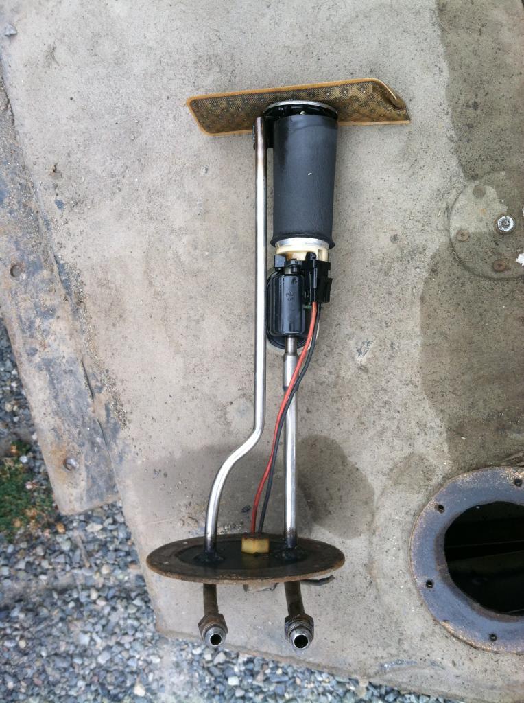

I got the fuel pump out and this is what it looks like:
It's not quite the same as the s10 fuel pump, but it's close. Heading to the parts store to return the regulator and pick up a new pump, screen, filter and a new vent hose.
So it actually IS an s10 fuel pump. The sending unit is just a little different. Picked up the pump, filter, and a new screen. Bday party for the grandkid right now, so i'll get it installed this afternoon
