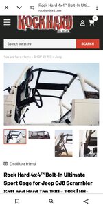

Do they go on the bend? When I looked into them awhile back I thought they mounted on top in the straight section.
That's what I thought when I ordered. But nope. They go on the bend. That picture is missing leading.
And their reply to my concerns.
I've ordered some longer bolts. That with some c clamps I might get them to squeeze on? Not exactly what I had in mind. Live and learn.
