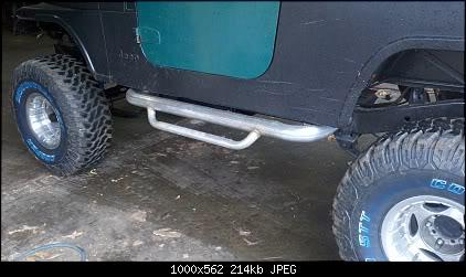

Got some pics with a real camera today lets see if they look better, I have got the front drive shaft in , rebuilt the heater box with a new heater core and a bigger blower motor got it all hooked up and warm, put the top and bulk head back on for the winter.
Still will need a newer style roll bar if any has has one.
[/IMG]
[/IMG]
[/IMG]
[/IMG]

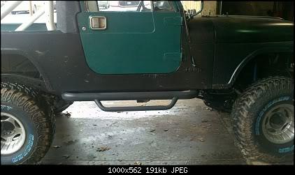

Its got a little dirt on the side, I took it to the deer lease just before I put the front drive shaft in and I only rolled through a few hard bottom holes, I just dont want to muddy it all up since its so clean under there.

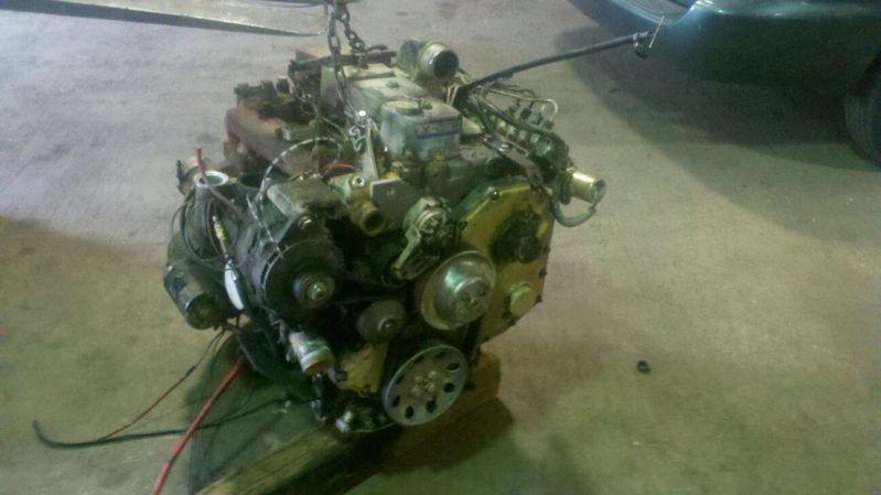

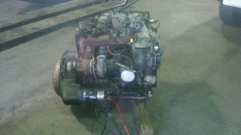

4 BT going in
Well it went from in the bread van to out of the bread van in about 2 hours today. Its also white now, just some cheap paint to help out on the body work.

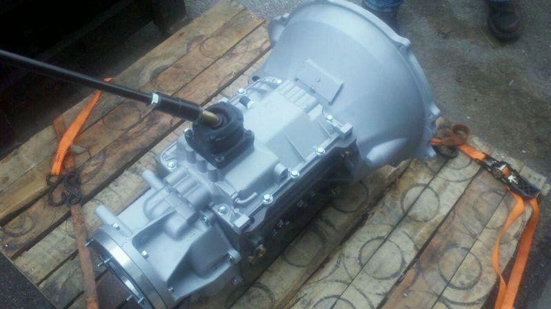

Well the last part i needed arrived today to start putting it in.

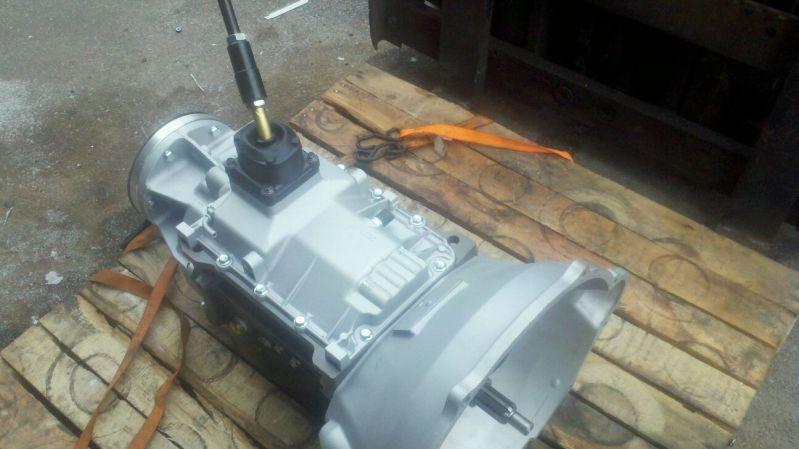

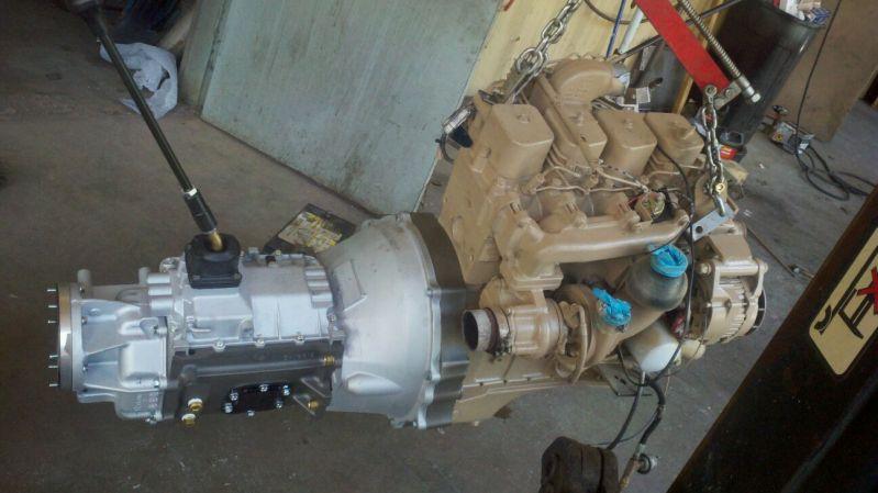

nv forty five hundrend with a clocking ring and the 5 quarts of liquid gold already in it.:headbang::headbang:
Lots of pics from here on out will be the norm.

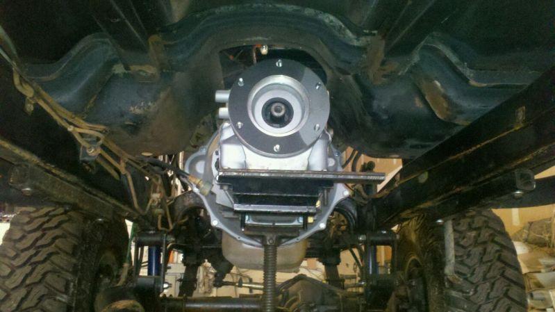

I got the gasser out and pulled the fenders and core support off and got the clutch in and the trans bolted up so its ready to start doin the fab work.
I can just hear it now.... Looks good just sitin there.

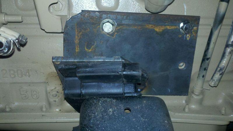

Well its sitting on motor mounts, I started the crossmember and darn customers kept coming in trying to give me money in exchange for work on there cars. Cant get much done when you have to stop every thirty mins but at least i can work on it for most of the day.
