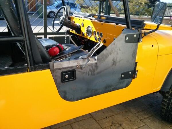

2. I started to build my half doors.

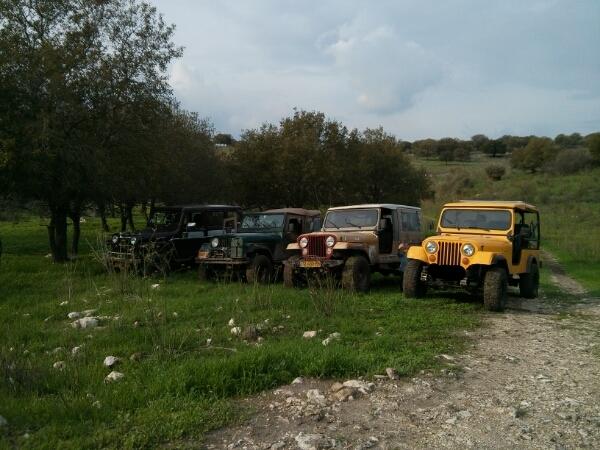

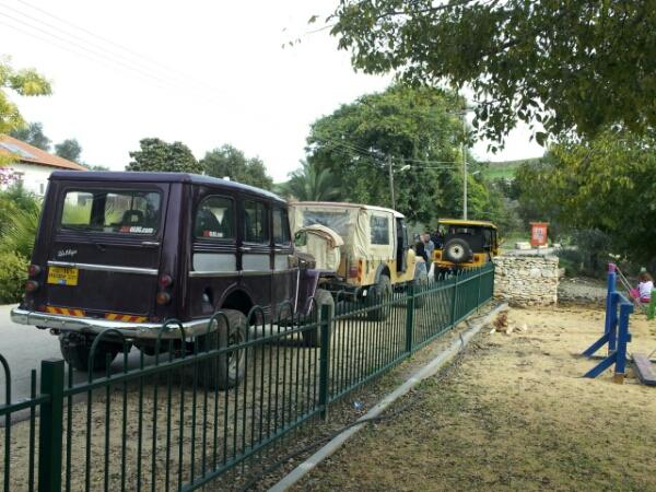

I will give free hummus to the one who can recognize which cars is in pictures 3 and 4.

Looks like a Willys wagon to me.

barrys - you won!

barrys - you won!

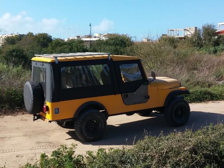

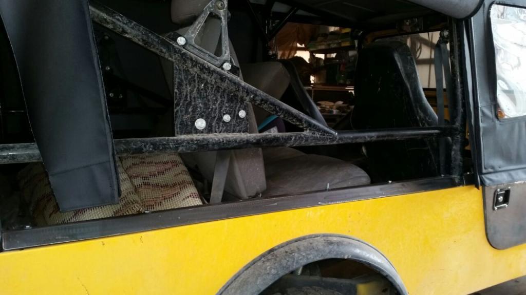

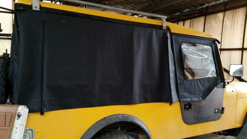

I like my new custom made soft top!!
I will share more once I will end up with the painting.
Soft sides look great. Did you make them removeable or so they roll up next to the top? I think your top has the best features of both the hard and soft tops. Maybe you will start a new trend!
The all fabric can be removed easily but I do not plan do it... The sides and back can be open by the zippers and then roll in to the top-sides of the hard top.

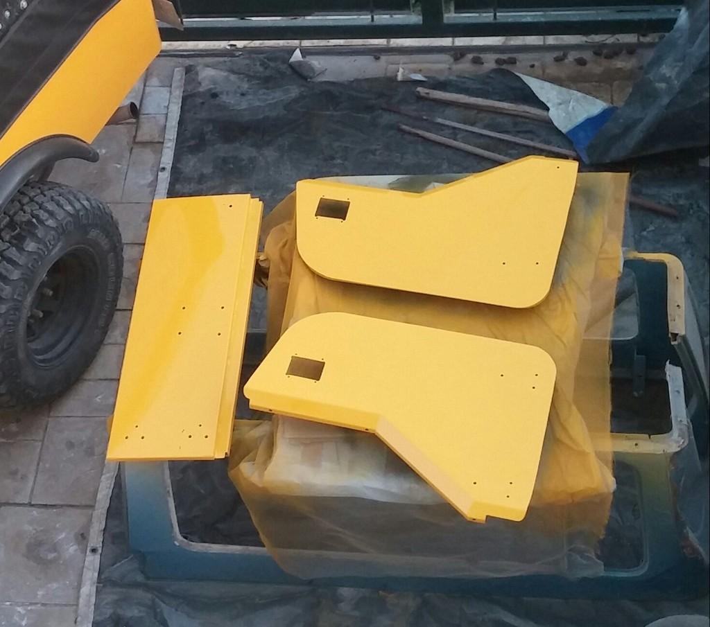

Ended painting the doors: epoxy primer, polyester & PPG paint.
Hoping to assemble everything at my next weekend.
