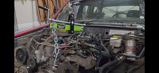

Disassembling has begun...
Grille and exo cage are removed
Hood is off
Driveshafts and transfer case are removed
Transmission and engine are drained
Underhood Wiring and computer are removed from the vehicle and pulled to the engine
Transmission wiring is removed and linkage is disconnected
Fuel lines and vacuum lines are disconnected
Exhaust is removed
I think I'm about ready to pull the engine

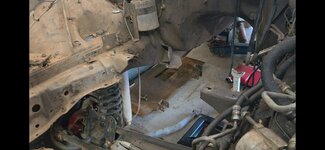

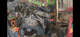

This weekend I had some more time to work on pulling the engine. I double and triple checked that everything was disconnected and lifted it a bit to release the weight from the motor mounts. All was good except for 1 wire loom that I hadn't disconnected under the dash along with an aftermarket water temp gauge. Once those were free, the engine and transmission came out pretty easily.
Once it was out, I mounted up the passenger side just fine to my engine cradle, but the driver's side needs the rear hole tapped. Of course, nobody around here had a 1/2 - 20 tap in stock, so that will have to be addressed this week.
I pulled the rest of the wiring etc that I think I'll need and I'll work on getting the donor vehicle back on the trailer... that should be fun!
From here I'll work on cleaning everything up, degreasing, maybe replace some seals etc. and all will sit until I pull the Scrambler off the road for the winter. Then the real fun begins!
