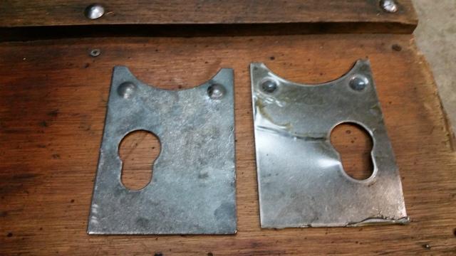

Put a new brake shaft retainer plate in my 8274, my had shape to it. I didn't realize it was supposed to be flat until it was back together. so I order one and replaced it it.

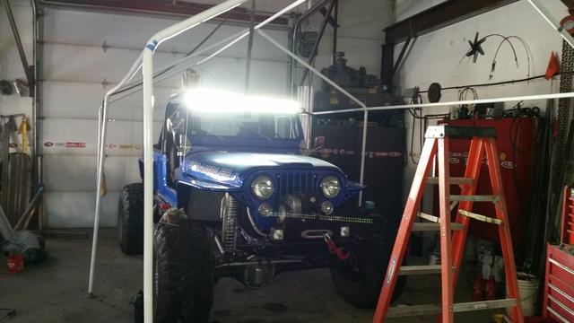

Also picked up a 300w light bar just in case it gets dark

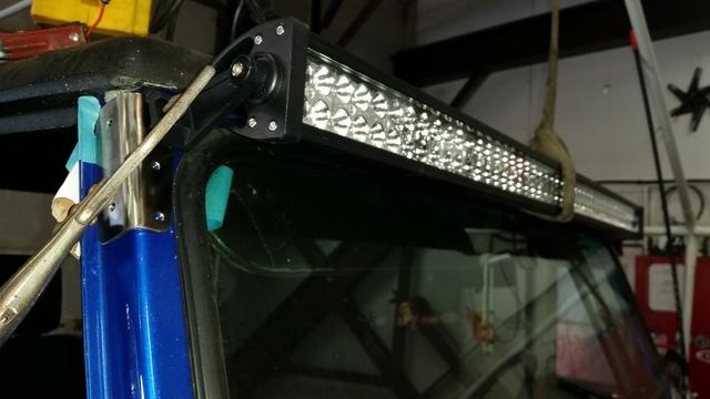

Did a test fit.
Made some stainless brackets to mount it

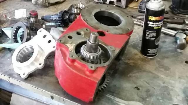

Started putting the JB conversions HD front out in the tcase

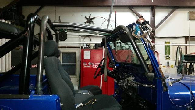

Started on the in cab cage
This is really cool. Im working on my 84 Scrambler that has sat for 18 years. What size tubing is your cab cage made from?
I just realized I hadn't replied to you...........
The main hoop is stock. The front parts are 1 7/8" OD. That's what I had dies to bend
