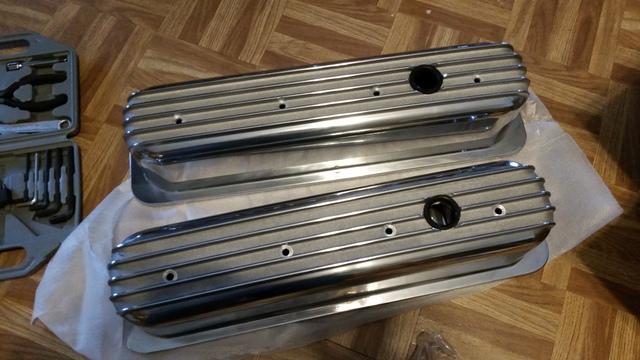

first the rocker adjusting nuts hit the valve covers..............
solution..........................
new tall valve covers

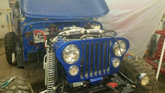

Made some more headway today. :woot:
finished up some wiring and plumbing. Mounted the winch. Trimmed the rock rails back. mounted the winch.
Now I just have to buff the fenders, install the inner fenders, wire the winch, and finish the AC mounts
Looking great! Where did you get the valve covers? I'm looking for some like that.
