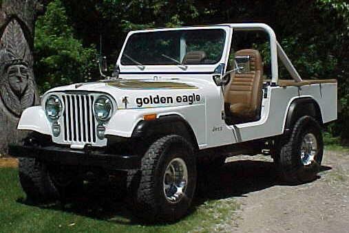

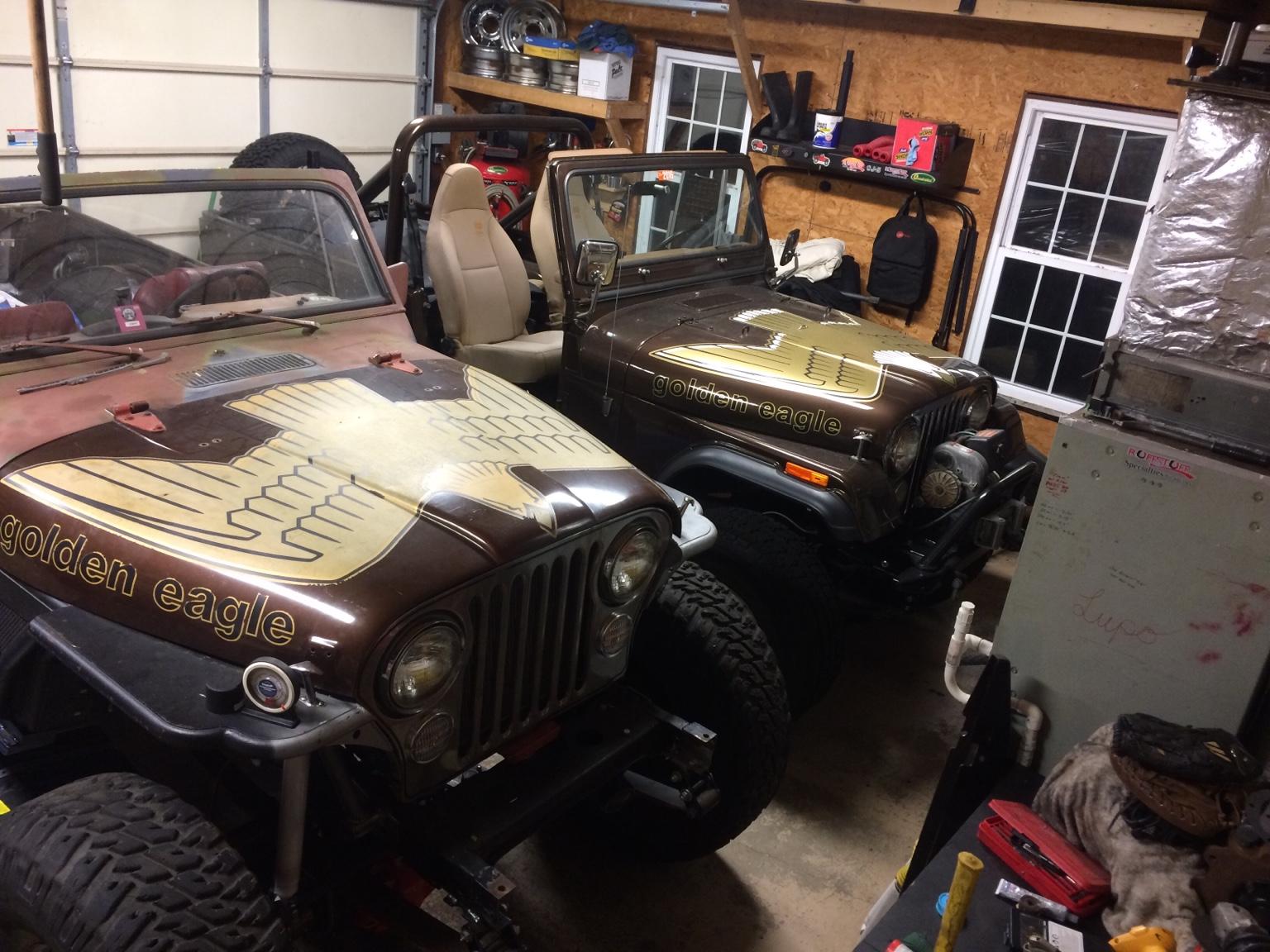

Super nice. Can't wait to see how it ends up. I need/want a front cage. And I want a Golden Eagle hood too. And you are hoarding the good one!

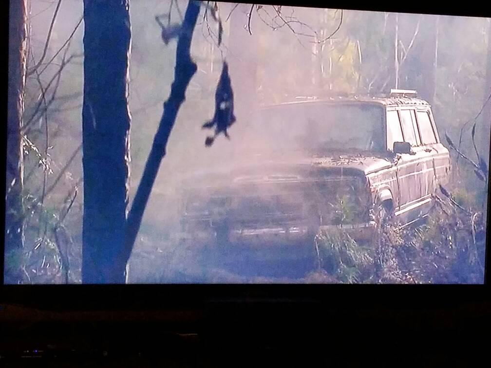

Saw that. I can say with all honesty that the scrambler was the ONLY good thing about the show.
I was watching some movie the other night and they had a Wagoneer in it.

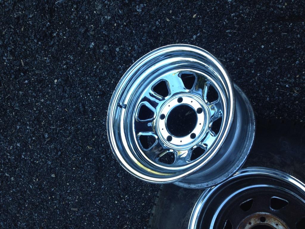

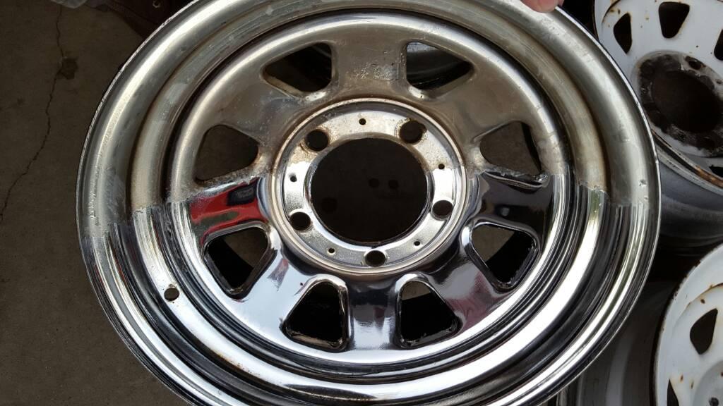

For those of you on the fence about stripping wheels... I ran out of stripper last night so only did half this was no effort just stripper and 20 mins
Wow. That sold me. Off to find a stripper. I mean off to find some stripper. ;). You have probably said it before, but which do you find effective?
Walmart carries same stuff a dollar cheaper per can. It has orange and silver marking with a white top and is made by Kleen Strip IIRC. Don't have any in front of me. But it's about 5.98 a can at WM
Makes easy work of the brake dust and grease on the back also.
It depends on how many coats. Typically 3/4 of the clear comes off in one spray. Then let dry and do another coat where needed. We all do it dif tho. CB uses power polisher tool I think after first shot. Brooklyn has another method. I use garden hose or power washer on a hot day, let dry. Repeat. I use more stripper I think than other methods but I don't own a power polisher thingy I Finish with the finest steel wool and hand polish. Also I use a razor blade in the one crevice. Approximately 1-2 cans for 4 wheels,front only. If doing rear also 2-3 cans.
