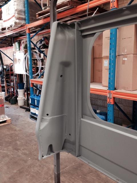

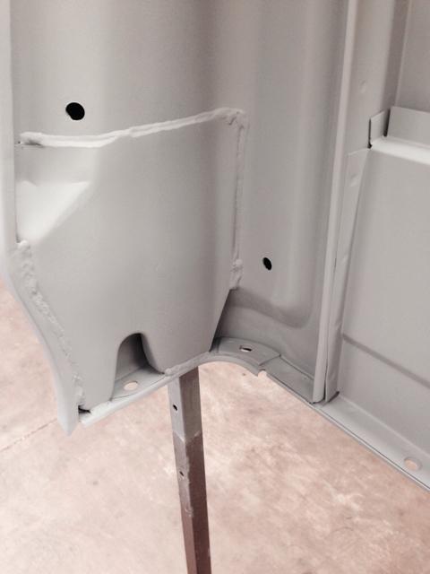

Gazzo - so is what I see hanging there an overlander top side panel sans window? Could I see a few pics of the back side? And how does the wing window seperating channel mount? Trying to retain details of what these tops look like and how to modify postal tops for windows eventually :)
Edit - i am thinking thats not an overlander side panel something is off with the seam and front detail...but damn is it close...what is that ? :p
Ding ding ding ding. Well done for paying attention to the thread Randy.
JJ you can go sit in the corner and face the wall for NOT paying attention, geeez.
Today for you I will get all up in one of my tintops and take some pics for you. In my mind you are considering converting your new old postal to an Overlander right?
Sent from my iPhone
Consider me in the corner. I have never seen someone take back panel apart before.
Oh and I don't need any pics of an assembled Overlander top I might have one laying around here :-)
That's what I thought. Go figure
Sent from my iPhone
Quite impressed with the build quality of this rear section now that we mention it. Bloody strong with lots of bits which all fit together real nice. One of these will make an awesome CJ8 cab one day

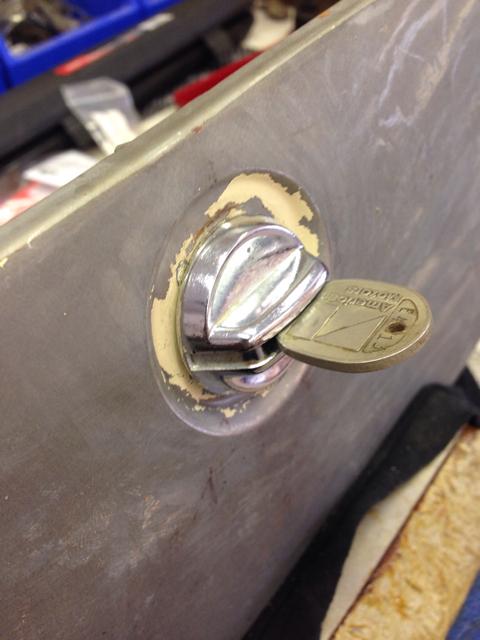

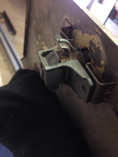

Anyone know how this stupid thing comes apart? Driving me nuts!!!
Please help a brother out
Sent from my iPhone
i could find only the doors as i wanted to sandblast them long time ago the locks are at my house so i cant take a picture right now but here is the procedure.. i took it off a web site a few years ago...
1. Unscrew the 2 screws holding the bridge on the glove box door.
2. Get a heavy paper clip and bend it out straight.
3. On the base of the lockset, there will be 2 small, square holes. These sometimes get plugged up with crud and are hard to see. Clean the outside of the lock off the best you can.
4. Use the paper clip to apply pressure inside 1 of the small square holes on the side of the lock. You are looking for the hole where you will feel one of the small, spring-loaded, brass wafers giving you some "springy" resistance.
5. As you push down on the wafer, wiggle the lock cylinder out of its case. There should be about 4 spring loaded wafers you must depress as you work the cylinder out of the case.
Cool thanks. I figured it had to be something to with with those two little square holes. The key would need to be in too right?
Sent from my iPhone
No key needed ..as most of them are lost to time.. So I rekeyed them...

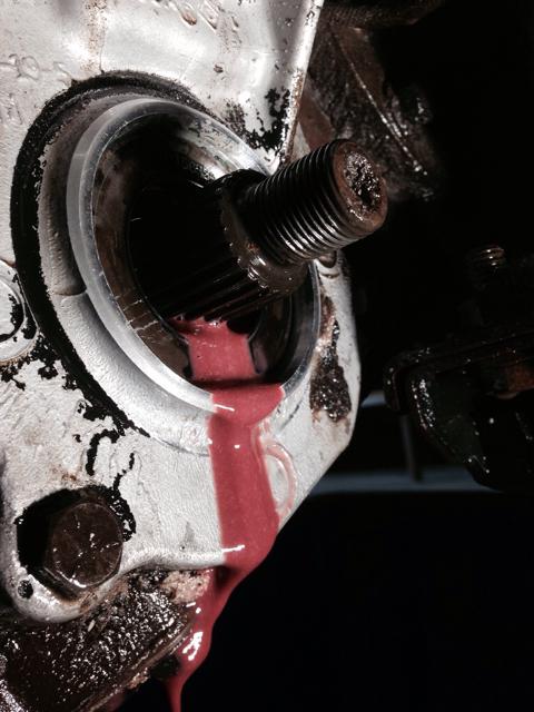

Overlander clinic today. First on the list fix the leaky d300. Hoping that's just from pressure washing, I've never swum this jeep but old mate before me may have. This transfer case/T5 combo came out of one of the twins, the one which spent time up north hunting crocs, pigs, buffalo etc :face palm:
