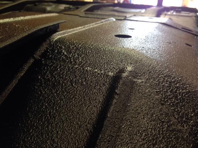

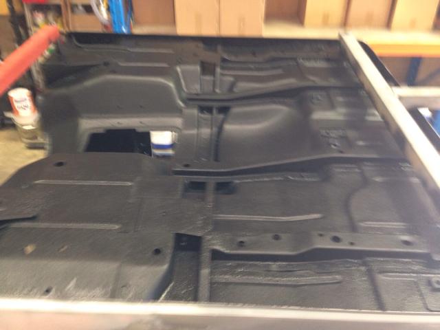

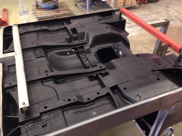

I got onto the liner inside and out on the truck this morning. Was able to spray DuPont bed liner with a engine bay gun which worked ok.
The join you can see is where I welded on a Key Parts floor pan. Very happy with how it turned out. I was able to blast the stuff deep into all the seams and joints.
