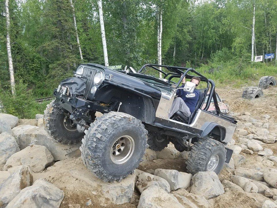

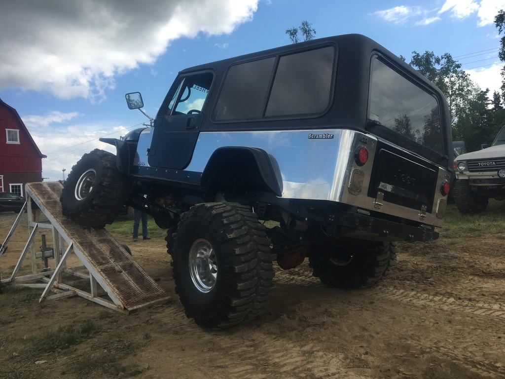

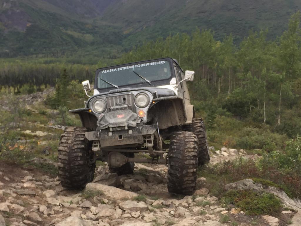

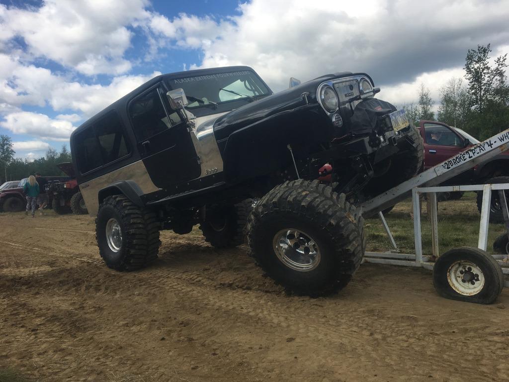

For no particular reason other than it's awesome, here's a pic that a friend of mine took at the M&G, and another friend edited:
A couple more from that event:

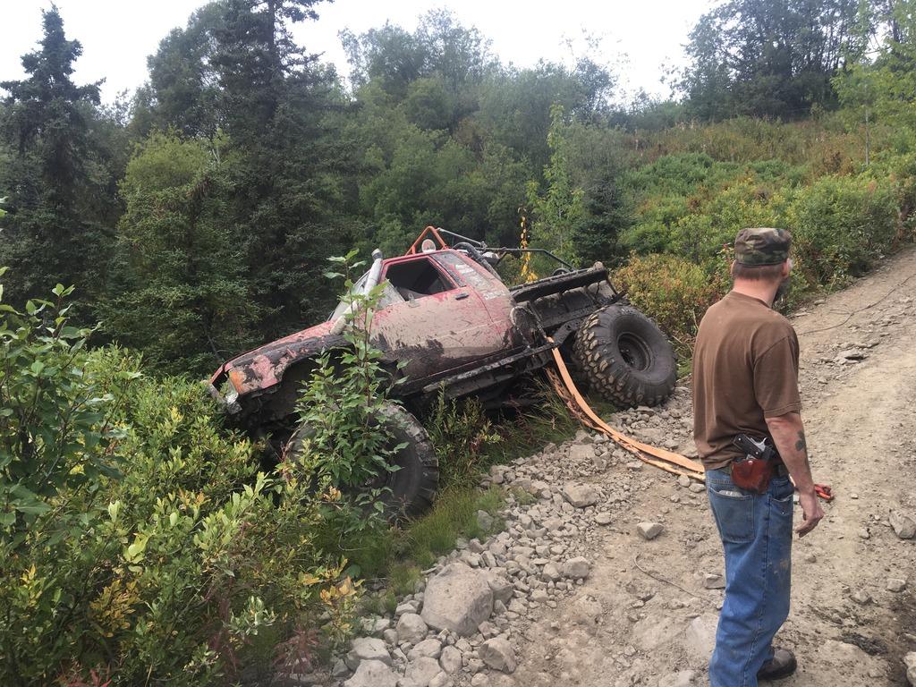

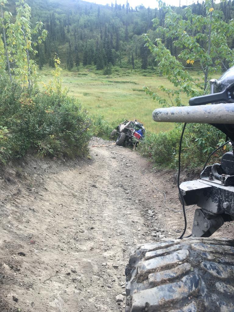

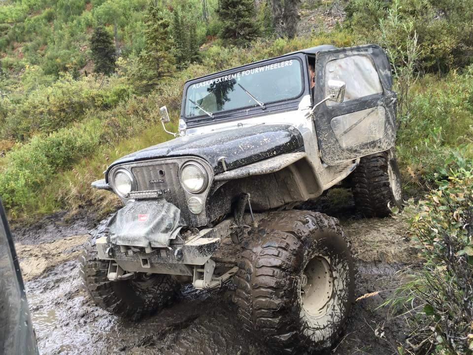

Used a second winch with a snatch-block to keep him upright while I winched him back:
And then the next day to the car wash:
I should probably just invest in a Hotsy.
I did drop down hard on a rock on the driver's side, giving me the first real test of the Ricochet Rockers. It left a small impression in the tubing, but I'm impressed!

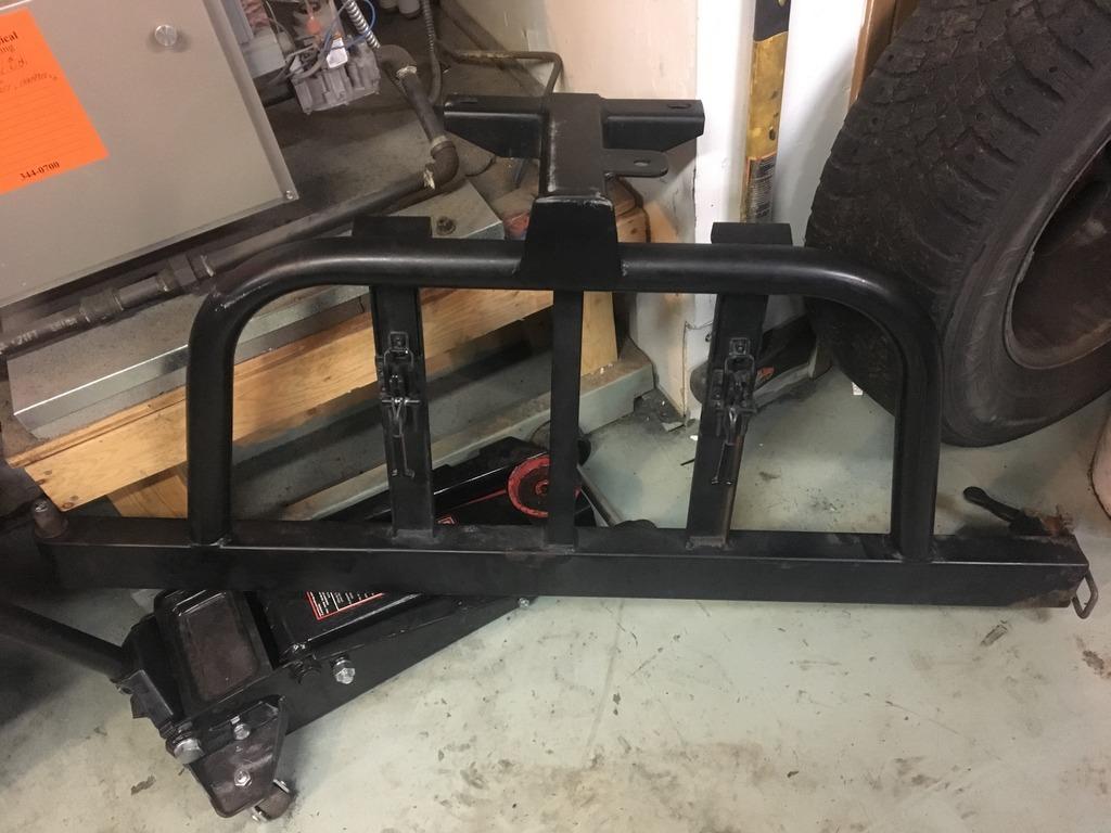

I snuck away for a couple hours yesterday afternoon to deal work on the tire carrier a little bit. Not surprisingly, the set screw was COMPLETELY rusted into place. I think the TJ it come up on was probably military-owned, and probably spent some time in the rust belt. Vice grips just crushed the exposed part of the screw, so I went to an easy-out, which didn't do anything either. At that point I just stepped up with drills until I started seeing threads. I figured the pin would slide out easy. NOPE! The whole carrier would go up-and-down 1/16", showing me that the set screw was definitely gone, but the pin refused to free itself from the bushings. Next step: I trimmed a couple notches into an old castle nut I had to weld it to the pin so I could get a slide hammer on it. That accomplished nothing as well. Next step: Now that a massive 1-5/16" nut was welded on, I figured I could put a wrench on it and simply jump on the wrench until the pin freed itself:
Ugh. At that point, I gave up and just cut the double-shear tower off to free it from the bumper. I figured this was the only way to get the carrier off. If I was lucky, I'd still be able to salvage it and re-weld it with some plate. Or, I'd be stuck going to an aftermarket spindle anyway. Looks like the latter is what's going to happen:
Faulty installation. The pin hadn't been installed deep enough, nor was the hole for the set-screw aligned on the pin. So, rather than the bushings turning around the pin and the pin staying stable with respect to the bumper, the pin itself was turning steel-against-steel. This caused the carrier to eventually loosen up and rattle. I BEAT on the pin with a hammer to force it out of the carrier and bushing assembly, but all I did was deform the pin. So, I'll definitely be cutting this all off anyway and replacing it with a spindle assembly.
Next project--check to see if the outer bolt holes from a TJ line up with the CJ:
Not even close. So I'll need to get some 3/4" or 1" plate to drill, tap, and weld on the back. I don't like trusting welds for recovery purposes from non-professionally-trained welders, so another option would be to simply run bolts all the way through the bumper. But that loses some of the "clean" look of this bumper . . . which I'm already going to destroy when I weld the spindle in. (sigh)
It was still worth it just to get the tire carrier though. It holds two jerry cans, a Hi-Lift, and has a spot for an antenna. That's saving me a TON of fab work even if I just build my own bumper.
But that begs the question: rather than using this as a Band-aid for now, maybe I need to bite-the-bullet and just build the bumper the way I want. Ugh. I'm in a quandry.

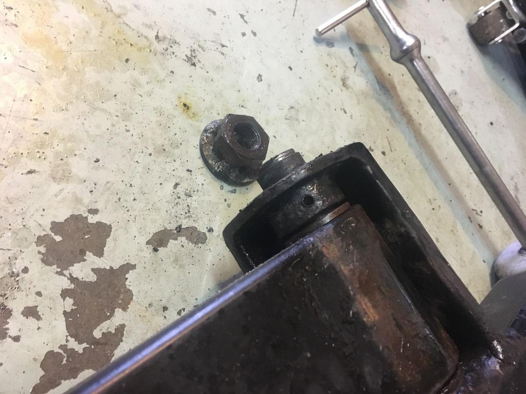

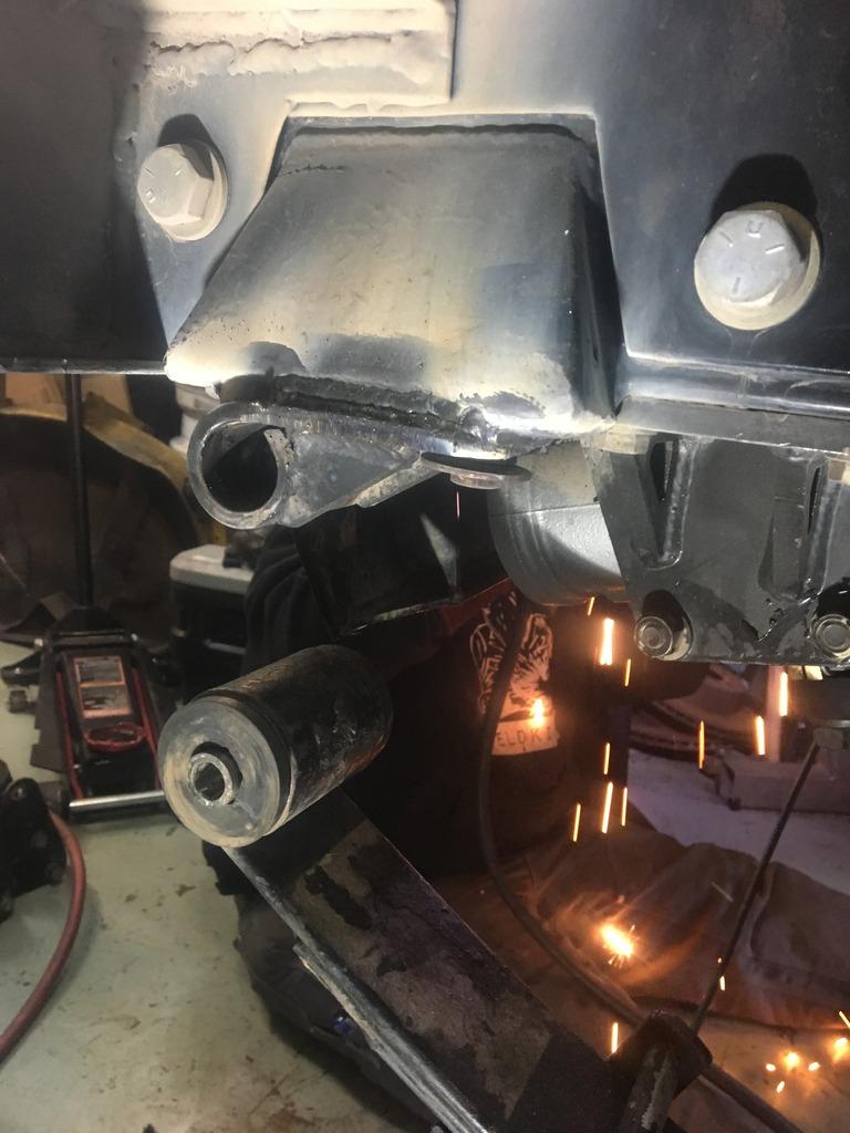

Last spring I finally decided to pull off my shackle hangers and figure out what was going on with my hangers always loosening up. I expected that I'd drill out the existing nut and tap it to a larger size, but I was surprised to discover cracks on the rearmost bolt on both sides:
The nutsert had cracked the welds just enough that it was loose. It wasn't spinning, nor had it pulled through. But torquing the bolt was ineffective since it just brought the loose nut into contact with the hanger, and still allowed the hanger to vibrate. I decided the solution was to re-weld the nuts, and then weld the hanger in place. This made me die a little inside because I had to grind off the galvanizing. I also enlisted a friend who is a certified welder since this involved welding upside down and in awkward angles.
So with that, the hangers are both welded and bolted.

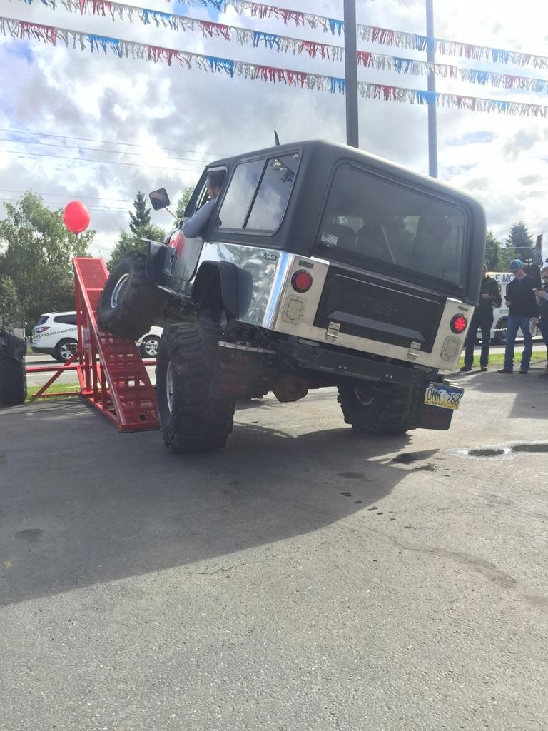

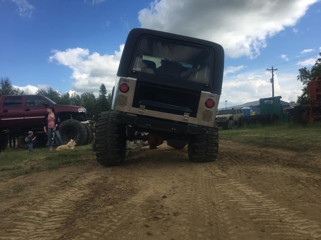

With death-wobble apparently solved, it allowed me to take it out to the annual Meet & Greet. I ran the course twice with zero problems, but don't have any pictures of that; just a few glamour shots on the RTI ramp. I did a second round where I got measured, and somehow scored a 1050! This strikes me as impossible, but that ramp isn't a standard angle or length.
