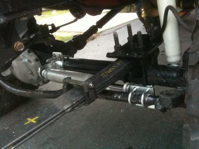

Stabilizer.

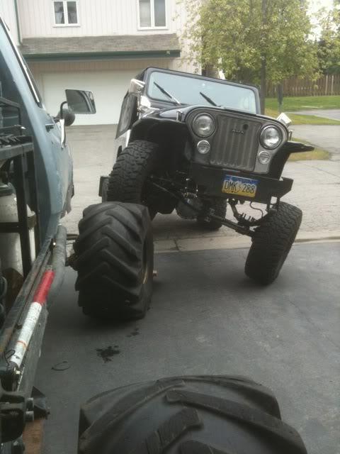

Measuring for the shocks. I didn't want to go any higher since I could already feel the suspension starting to unload on the back and it was getting "tippy," but I never lifted a tire!

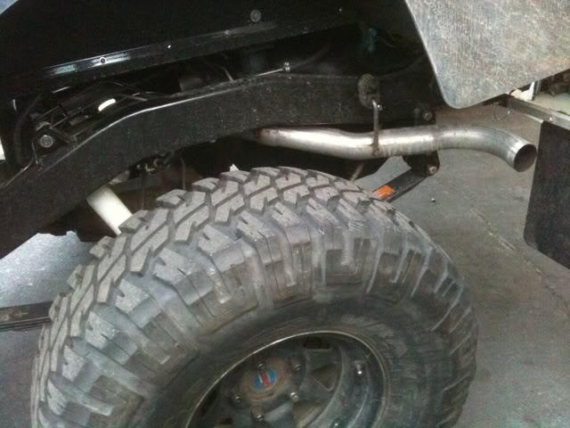

I decided to have the tailpipes exit in the back behind the tires so they wouldn't get near the auxilliary transfer pump or interfere with whatever bumper/tire-carrier combo I get.

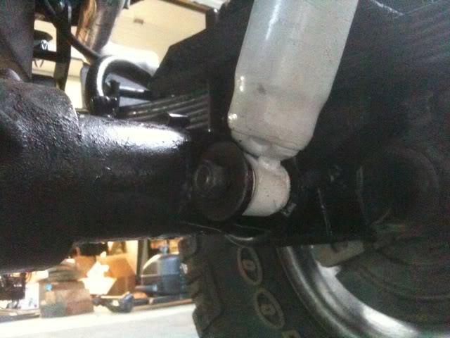

Rear lower shock mount. This is just 3/16" x 2" flat bar that my roommate welded up for me.

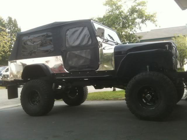

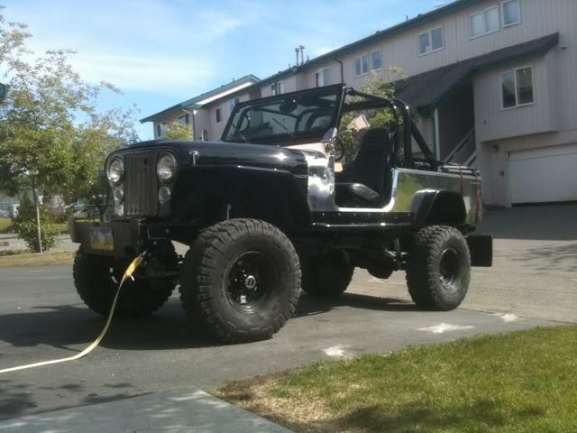

I spent Thursday night working on it until 5:00ish am, then slept for a couple hours, and worked on it until 6:00 am on Friday. It's now all polished, the rollcage is totally bolted in, the Ricochet Rockers are bolted on, the body mounts are tight, and the fender flares are on. I packed the Jeep and was ready to go out to the Meet & Greet, so I slept a couple hours, showered, grabbed coffee, and made it about 7 miles before my distributor gear shredded my cam gear and I coasted to a stop. Thankfully I was near an exit and was able to get off the highway.
Epic fail. I have a nice picture of it in the sun, behind a strap.
I think my California trip is cancelled. I gotta sleep on it and figure out my next move. I'll post a fresh pic tomorrow after I've had some sleep.

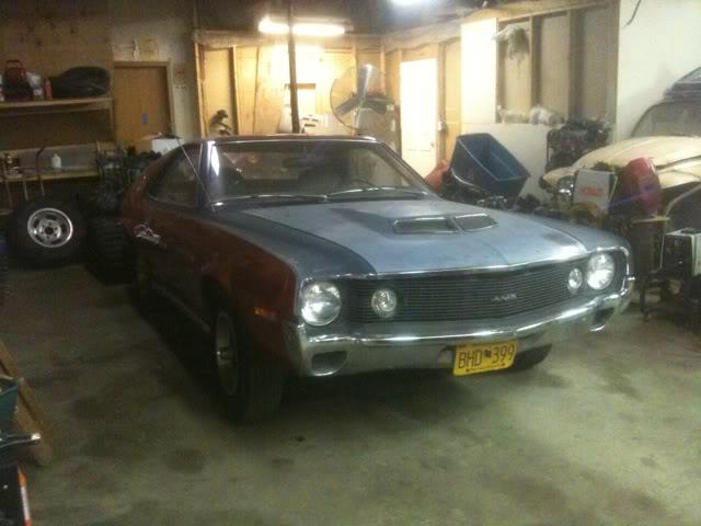

At least my 401 has good company with the 390 in this AMX at my buddy's shop:
