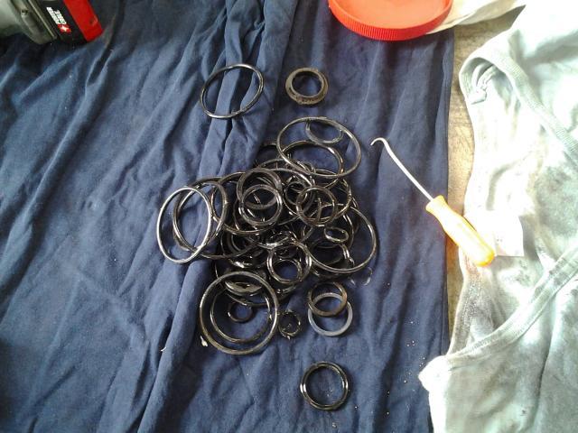

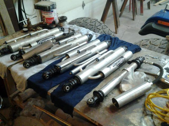

This morning I started out with this bench full
Then 6 reseal kits and three gallons of shock oil later

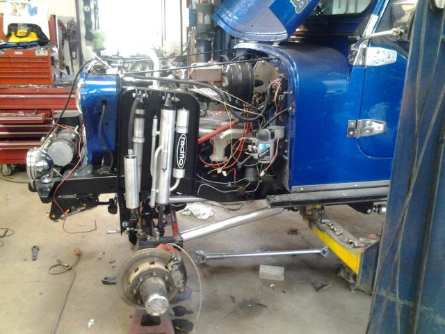

The shocks are all resealed and the front ones installed.
I still need to put a full charge of nitrogen in them and get good scale weights so I can order springs..................

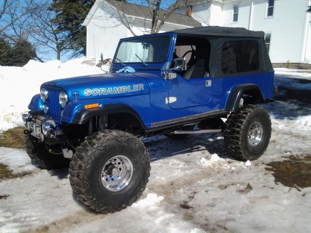

Great meeting you tonight, Jeff. The Scrambler looks GREAT!
Nice meeting you too.
As for the Scrambler, not much exciting going on. I've been fitting the exhaust back in. Most of it is all tacked together, now I have to remove and weld joints for final install. I'm hoping to fire it up this weekend and try out the new fuel injection. The other thing on the list is to get the front and rear spring rate so I can order springs.

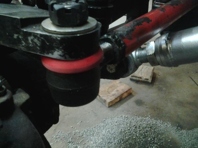

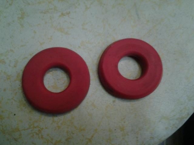

Started finishing my tie rod so I can get it painted. Still needed the ram assist mounts and one new tie rod end. I was a little concerned with the tie rod rotating under load. Since it is bent and has a assist ram attached.

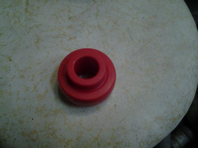

So I took a replacment Ford radius arm bushing that was in my cabinet. (What good are they anyway............. Ford...........stock??????)
Redneck machined with a band saw and belt sander into two "washers"
And put then under the tie rods to keep them straight.

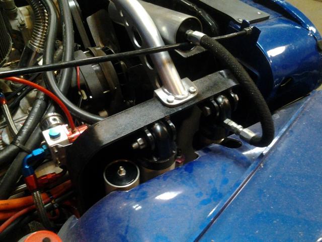

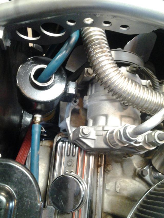

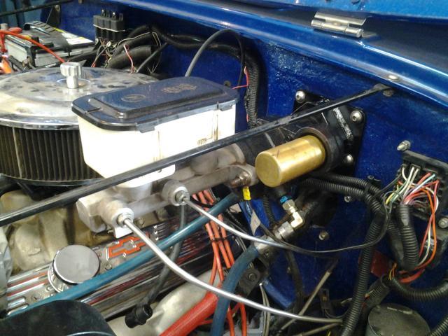

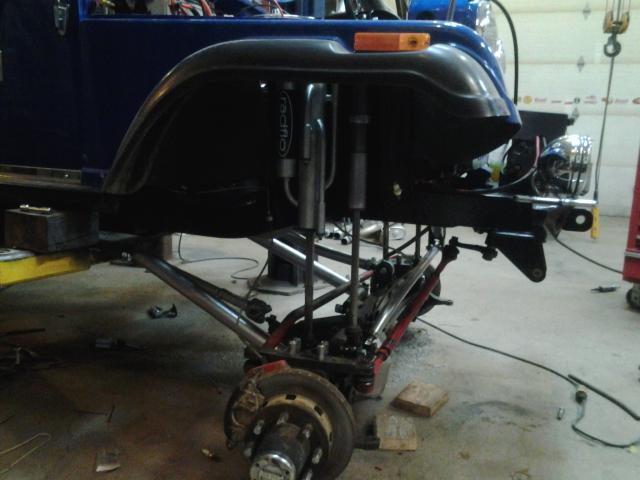

Hydroboost bracket built, and installed. Extra reservoir added to the power steering pump. One pressure hose to install and the steering and boost are done!
I dont know if it matters which way its mounted, but your hydroboost is upside down to the way I have mine mounted. All my lines are on the top and the reservoir is on the bottom passenger side. May have a problem bleeding the air out of it.
Yes it is technically upside down. But I have a couple friends that run them that way and it hasn't been a issue. I did it just for easier plumbing. As it is the master cylinder is 1/4" from the hood.

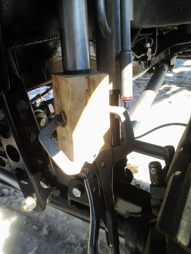

Still don't have springs so I made some "lift blocks" LOL
Good thing is......IT MOVES !!!!!
backed it out and took some pics
This is were ride height should end up......if the plan keeps working.
