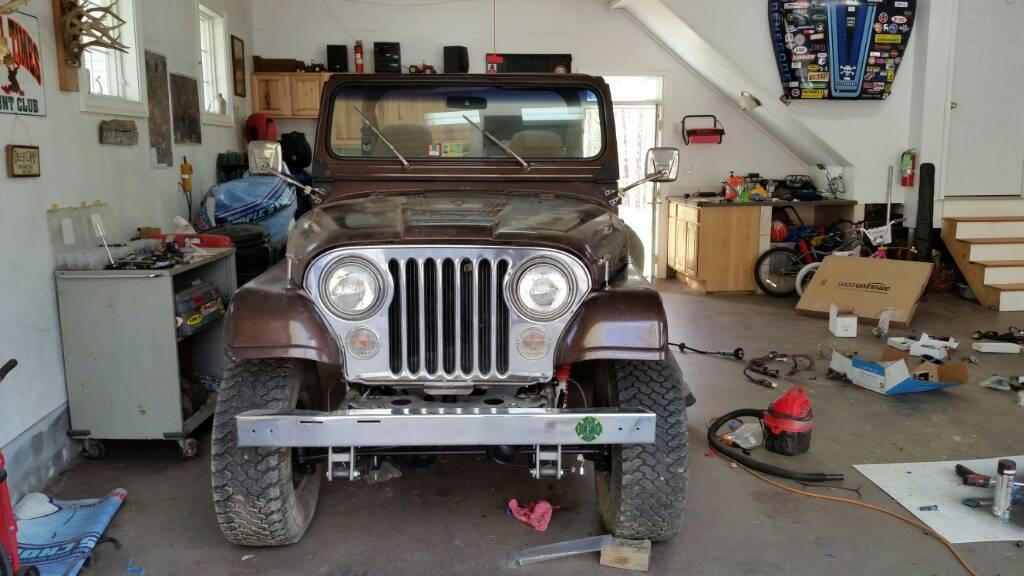

Starting to look like a jeep. Dustin recruited some more help this morning as well.
Drove out of tha garage uner its own power. Whooho :cool:

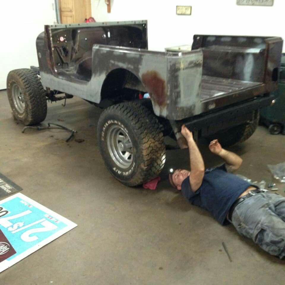

So started 6pm on Wednesday like this.

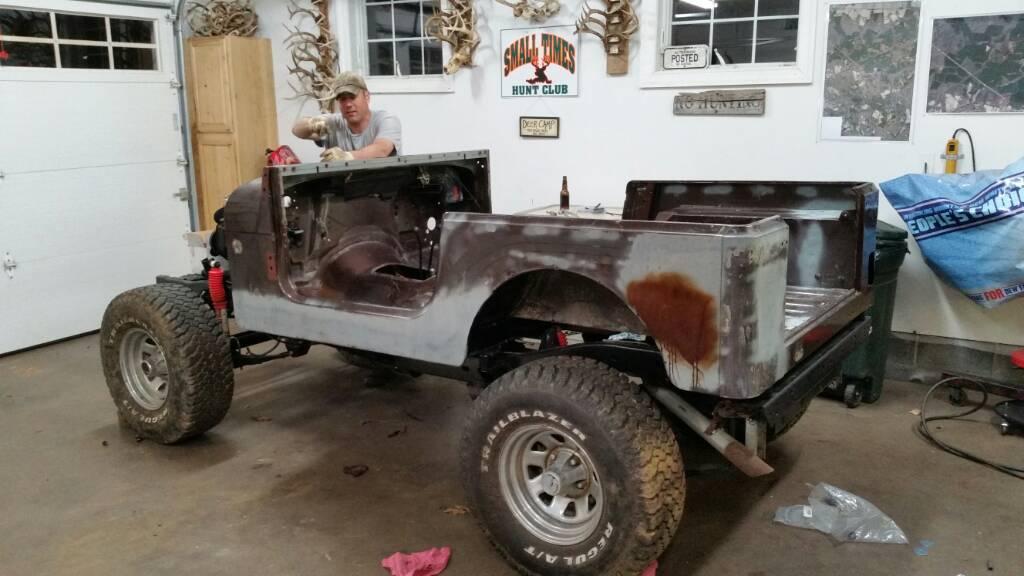

And by 1pm today had this.
Runs and drives. Huge shout out to jeeperdd his knowledge of jeeps is incredible.

Probly should have had more poctures but Dustin is hard to catch on film as fast as he can put one of these together.

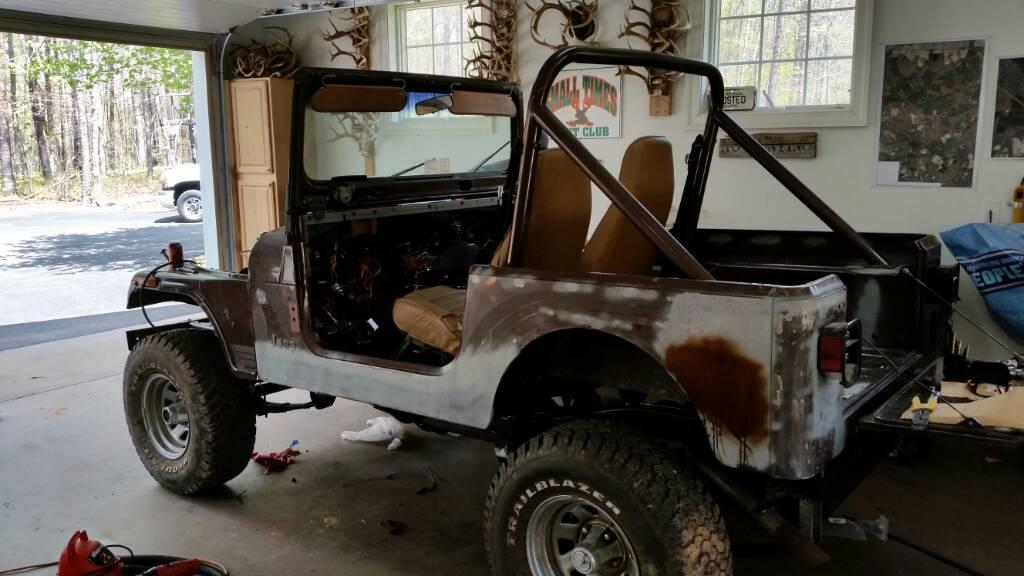

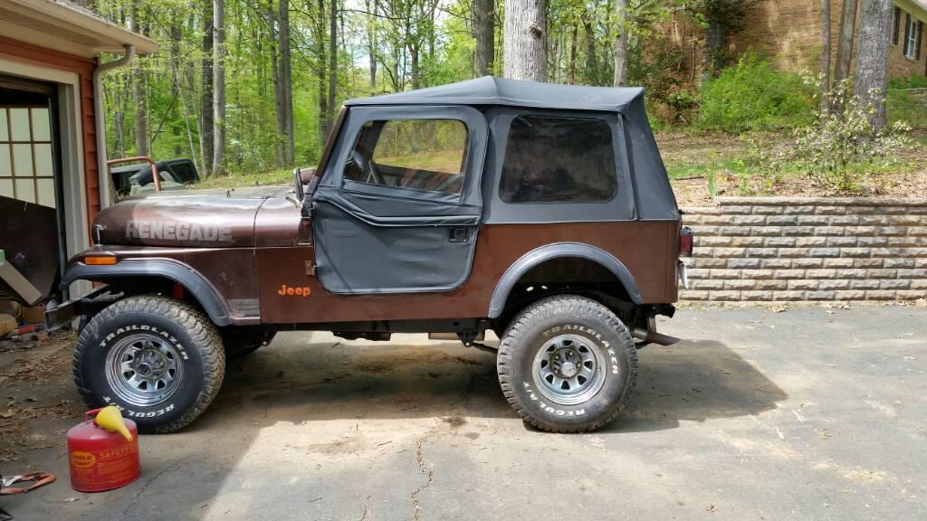

Got a little more done today. Tire carrier on, rear seat in, headlight and turn signals now working. Door hinges put on and then through the soft top on. I got it when i baught the jeep but never put it on. Thaught i would check it out. One bad zipper section i think the mice got into while it was in storage. But looks ok.
Winch on today. Making the mounts took much longer than i expected. And getting all the bolts tight was quite the puzzle.
Yes sir. Just trying to get up the nerve to try and get it inspected to be 100% legal.
