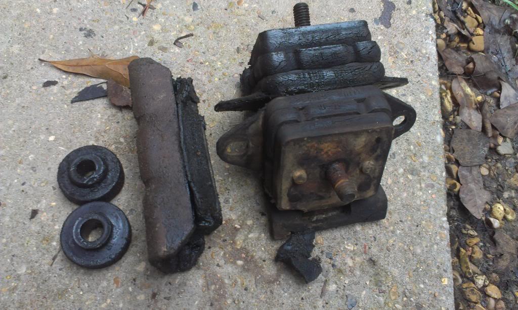

The factory motor mounts/transmission mount and torque arm bushings are soft/squishy/torn, a result of all the oil that sprayed out of the broken/leaking factory plastic valve cover:rotfl:

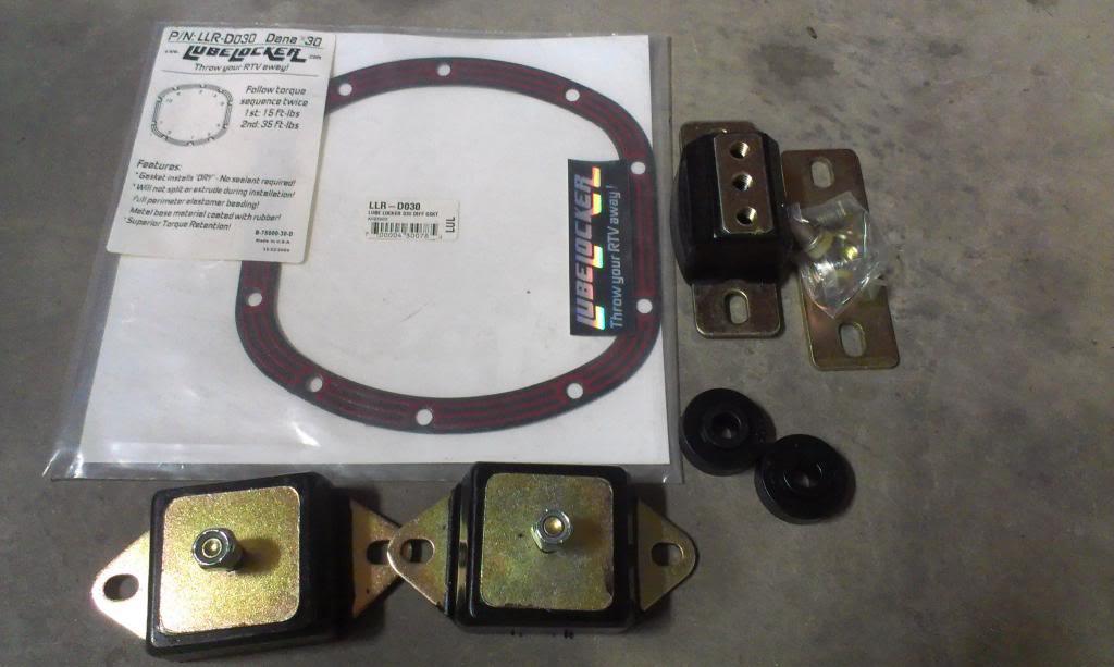

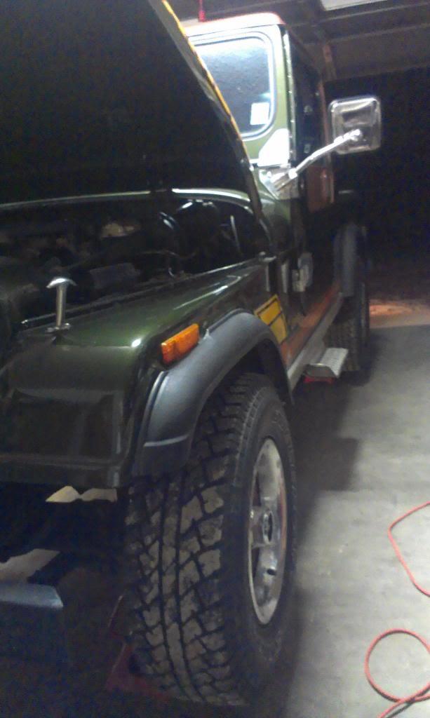

Picture of the replacement mounts, I went with black polyurethane pieces. Some people say that the poly transmits vibrations back through the frame, but I have not experienced this in any of my other Jeeps. I also decided to change out the front axle oil (note the Lube Locker gasket, I love them), transmission and transfer case oil.

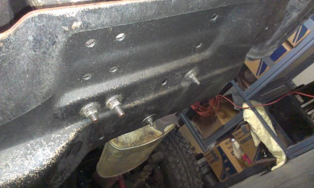

Since this Scrambler is sitting on 30 year old leaf springs, it sits too low to the ground to easily get underneath it, so using jack stands was a necessity.

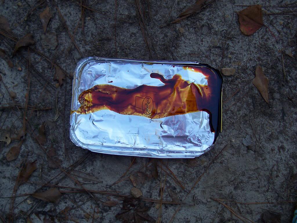

This is all motor oil. Surprisingly, the transmission and transfer case do not leak. I fixed the valve cover leak over a year ago, so this Scrambler really does not leak too much anymore. I really need to clean this one.

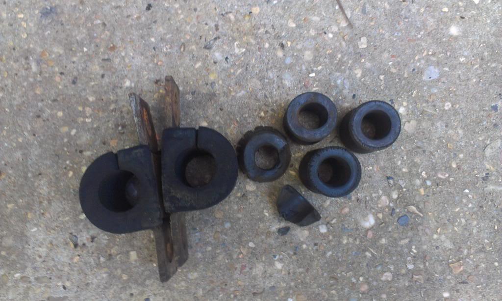

It was pretty easy to change out all of the above mentioned mounts, no issues. Quick picture of the old stuff. The transmission mount is completely smashed, I basically had metal on metal. I am hoping that this might have been the cause of my minor, inconsistent "knock" at idle sound. Before I changed all these mounts, you could watch the motor squirm around a little bit when it was idling.
Since I will be putting a 1" lift on this Scrambler in the very near future, and will be changing out all of the other suspension bushings, I went ahead and swapped out the old, dried up, cracked original sway bar bushings. Again, it was a piece of cake, I love rust free Scramblers!!!!!

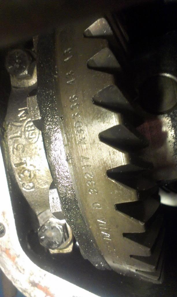

A few pictures from when I changed out the front axle gear oil. Everything looked fine in the front end, no need for any front differential work.
This Scrambler is running the stock 3.31 axle gears, computer controlled Carter carb equipped 258, T5, and 30" tires, and it is a "fun to drive" combination:twocents:

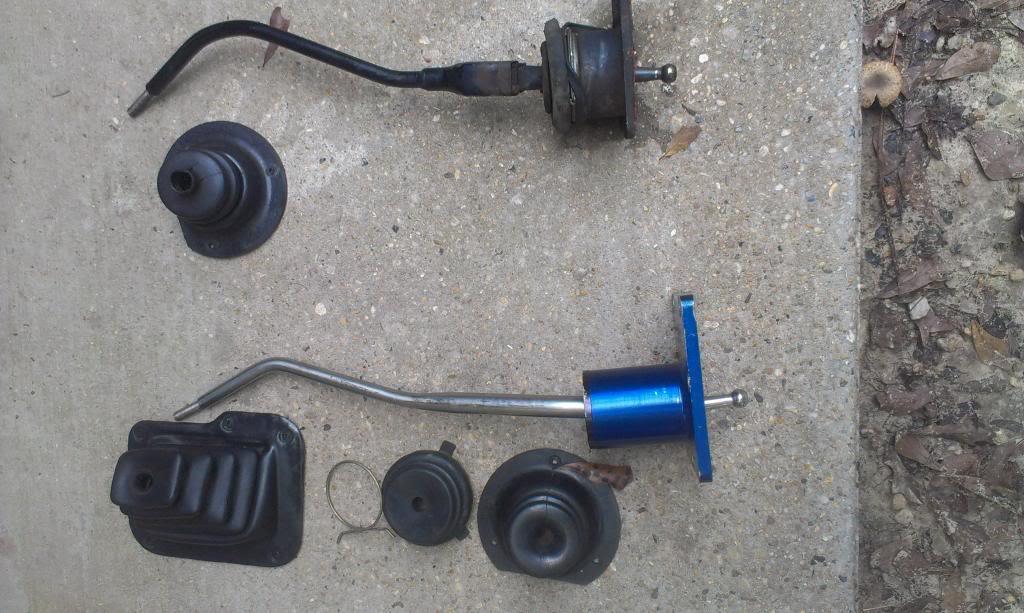

While there was nothing wrong with my stock T5 shifter, I decided to install my B&M short throw shifter, the shifter I was using in my red Scrambler. I love this shifter. I also changed out the stock/tore T5 shifter boots, the stock Dana 300 shifter boot was good to go.

I "assumed" this Scrambler's T5 ran ATF, due to the red colored hue of the fluid. I was wrong. This Scrambler, in the exact same fashion as Jeep Addict's T176 equipped Green Scrambler (80,000 mile original), had some funky fluid in the T5 AND the Dana 300????
All four of these units, my T5/Dana 300 and Jeep Addicts T176/Dana 300, which I am going to say that it is pretty safe to say that they were running factory fluid, all used the same stuff - this weird reddish/black thick fluid that has a unique smell, NOT LIKE GEAR OIL. This fluid is way thicker then any engine oil/ATF, and I would say that it is as thick as gear oil, yet it is stickier and maybe thicker, similar to syrup but not that thick:shrug:

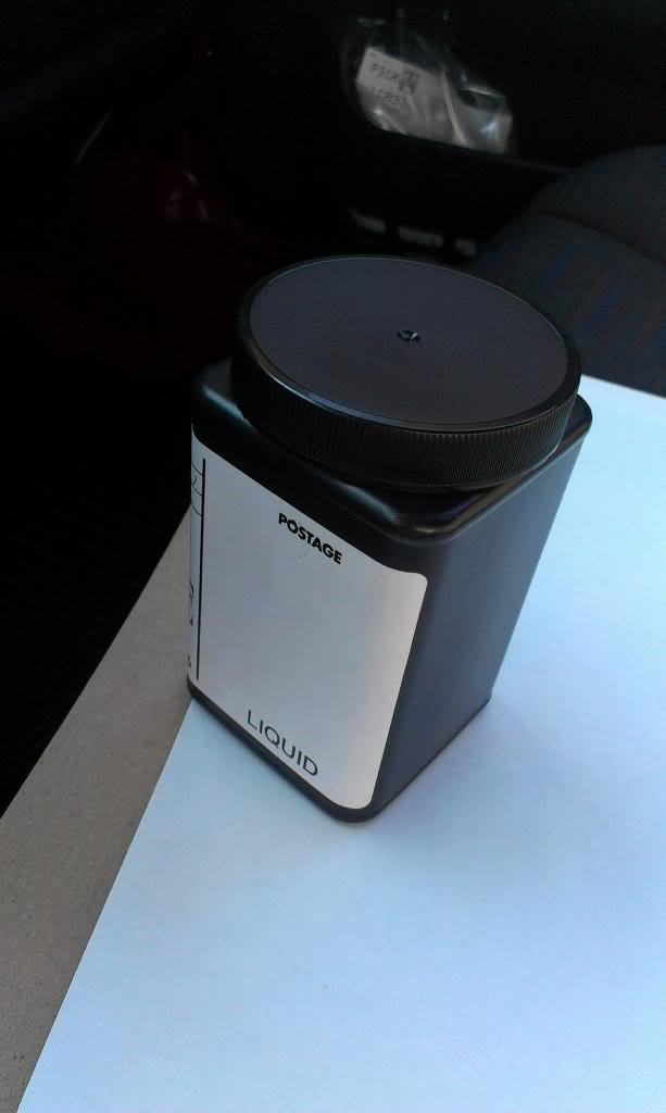

I saved some of the original fluid that came out of this T5. I plan on sending it to one of those "oil analysis places", suggestions welcome, to figure out exactly what this stuff is, and more importantly, what is a modern equivalent.

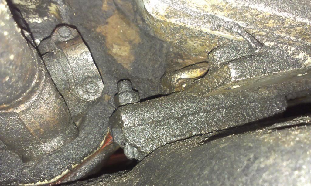

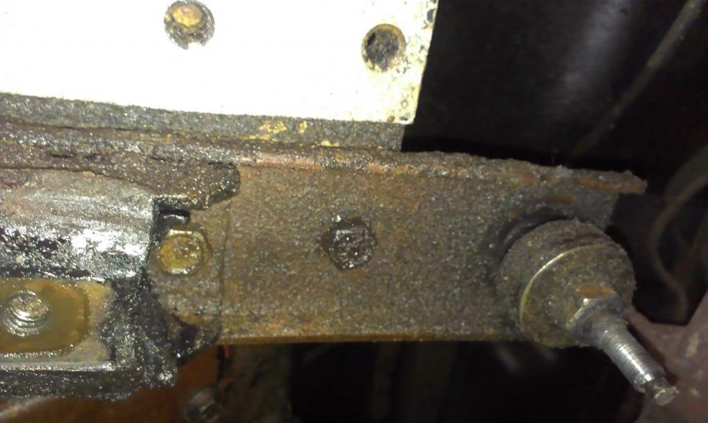

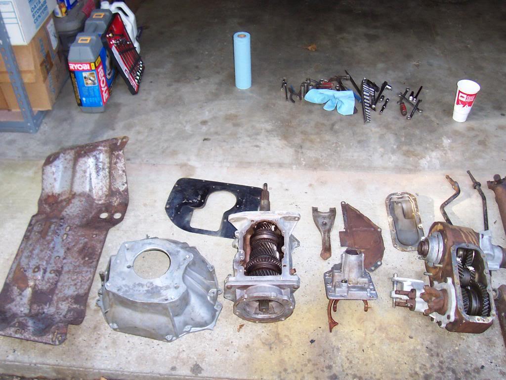

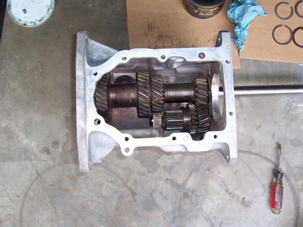

This is an old picture of the factory fluid that came out of "Yard Scrambler's" T176, the exact same fluid came out of my T5/Dana 300. I wonder what it is:shrug::shrug:
Note how this fluid "stains" the internal parts/cases.
Note - the "staining" was present after steam cleaning:eek::eek:
All of the above pictures are from "Yard Scrambler's" 80,000 mile original T176, BUT my T5 had the same fluid in it:shrug:

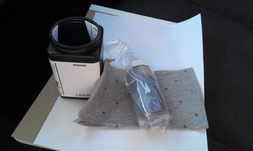

I received my lab sample kit this weekend.
Filled it up, mailed it out today.
Surprisingly, I didn't have a problem at the post office:fingerscrossed:
I have talked to the lab a little about what I am sending them. They are not sure if they can tell me what it is exactly, but that they can probably match it to something with similar characteristics. We will see..............

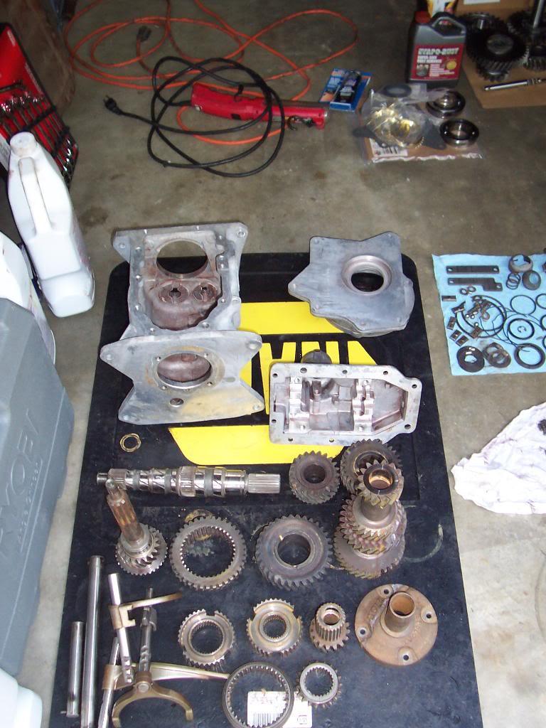

I ran ATF in my red Scrambler, after the first T5, filled with Mopar Manual Transmission Fluid (supposedly a driect replacement for the original AMC "fish oil") had a a cluster gear bearing journal failure. I then proceeded to have two T5's catastrophically fail while running ATF (broke input gear/cluster gear/cracked case).
