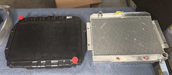

While I was in there, I replaced the Champion aluminum radiator with a brass/copper radiator from US Radiator. The Champion was working well but took some damage from high-speed hailstones. And I wanted the ability to repair small leaks in the field - which is hard on an aluminum radiator. This new radiator, as was the case for the Champion, is specifically for a Chevy Small Block in a CJ.

First problem is that the new compressor now totally blocked the stock Chevy thermostat housing. No way to get a radiator hose on it in that location. And you can also see the notch I made in the alternator mounting bracket to allow the Jeepair bracket to be used.
I have a V-Belt setup - not a serpentine belt. So, I had to figure out the right belt length. Ended up with a 57.5" Gates 7575 belt.
To solve the upper radiator hose issue, I sourced a "Swivel Neck" from Summit Racing for $25. It is an "Allstar Performance Aluminum Water Necks ALL30271" Besides swiveling into any rotation, the neck is at a 45-degree angle to allow for a smooth hose route to the radiator.
Ended up making heavier duty brackets for the condenser. I used the thin ones included in the kit and thought it would vibrate too much on long Overlanding washboard roads. Took @spankrjs advise and used screws with nylon lock nuts to mount them. Except for the top driver's side where I just drilled my new bracket and used the hood latch bolt that was already there.
Here is the finished engine compartment. You can see the receiver/dryer on the driver's side fender. I also looked at MANY upper radiator hoses and found Gates 25806 universal hose with a 90-degree end that fit perfectly. Plus, it is stocked at most auto parts stores in case I need one while traveling. Used the constant tension spring type hose clamps to avoid leaks. And I inserted the high-pressure line that goes inside the cab into a DES heat sleeve so it doesn't pick up too much heat on the way in. (I'm not an AC expert and don't know if this really helps...but I wanted to have it be as cold as possible) Not pictured but all the hoses route up and over the back of the engine along the firewall - like the main wiring harness.
