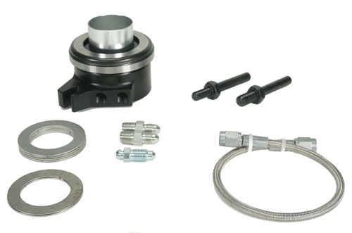

Got the T177 installed with the new internal hydraulic throwout and twin sticks on the D300 and it didn't blow up instantly when firing it up or driving it around the shop back and forth. I guess we'll know if she'll hold together when I get going down the road. Did have a scary moment when I put the shifter back in and the transmission wouldn't shift at all. Turns out the shift forks were misaligned. A quick google and a screw driver and we were back in business.
What did you use? I could not find one to fit my T176.
The RAM Clutches 78142. The collar of the bearing retainer on the T176/177 is 1.435" and this fit perfectly. I paired it up to the Wilwood 260-15098 master cylinder. No modifications needed, just measured and shimmed it like normal. The alignment stud that comes with it is the right pitch/length, as well.
I've got a T177/302 combo but it should work with any engine mated to the T176/T177 as long as you have 1.7" of distance between the bearing retainer face and your clutch fingers.
I've got a T177/302 combo but it should work with any engine mated to the T176/T177 as long as you have 1.7" of distance between the bearing retainer face and your clutch forks.
Thanks! If you knew the BS I went through trying to get a working clutch in my jeep. I'm running an Advance Adapter 71258 conversion bell housing to an SBC and never could get a working clutch that I was happy with, and Advance Adapter was no help. It's too late to take everything apart at this stage but I have added the info to my Jeep notes. (y)(y)
I went this direction because there are so many different SBF bellhousings and clutch setups...this seemed the easiest and since I already had the transmission out for the rebuild it was the time to make it happen. I exchanged several emails with the RAM Clutch support guys. They were always super fast to respond, gave me all of the bore and stroke info for my MC, and helped look at different options. Can't beat that it's made in the USA, too.
