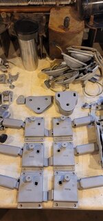

Little bit of sandblasting last week . I had to go to 2 nj harbor freights as someone has been buying out there inventory or glass media in Brooklyn. I got the last 100lbs

Honestly I would trust a Koyo bearing over a Timken these days.
Japanese bearings tend to be very high quality. I've seen Timken made in India.
I rebuild a LOT of Honda ATV's, and Koyo bearings are what Honda uses. They are pricey too, compared to all the chy-na junk out there.
