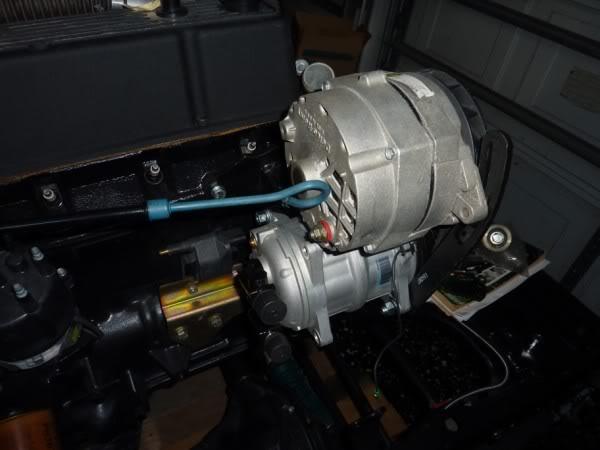

Need PICS! Can't figure out the A/C compressor mounting. Anybody have pics? Have unit from CB. If anyone has done it, is it possible to take pics of the brackets etc for me to mount this one? Thanks in advance. Craner8.

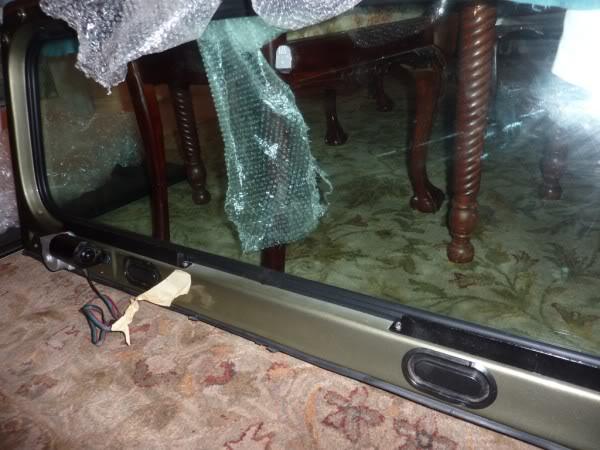

Chris or anyone: Any ideas about why the vent openings in the windshield frame are obstructed/covered? Is the glass installed correctly?
Windshield Gasket
Looking at your picture it looks like your windshield gasket is inside/out compared to mine. It looks like we may have the same gasket. Here are a couple of pictures so you can see how mine is installed. Here is the outside, this looks like what you have inside by the shape.......

Here is the inside with the vent installed. Hopefully you can see the difference in the shape and your gasket is the same.

That's what I'm thinking. I am going to take it back to the glass shop and ask them about it. I mentioned it when I picked it up and asked if they could re-use the rubber if I needed it removed and he said they'de likely break the glass b/c its tempered. Oh well. Not sure that's my problem; problem was obvious when they finished it. I prefer it done correctly and the vents installed.
Any photos of a CB A/C compressor installed?
Will take your pics to glass shop with me. Thanks.
Got a little done tonight. Took the windshield back to the glass company and they removed the glass and installed it from the front. Now the vents fit fine.

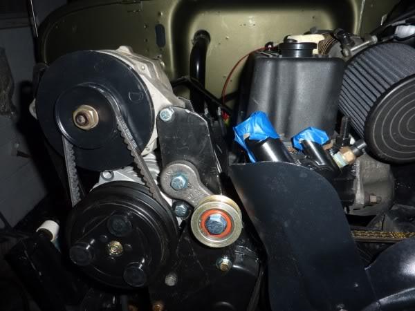

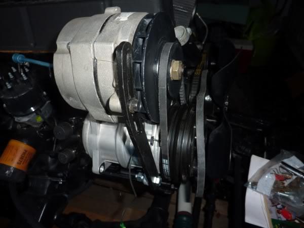

Got the A/C compressor installed tonight. First pics aren't done correctly. Moved some brackets around.
Finished the brackets for the top, passenger side. Someone drilled screws too big, so I used locking clips behind the screws. Finished it up.

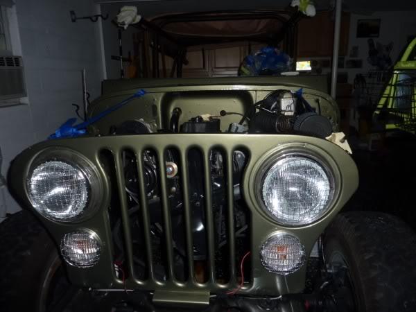

Working on the grill; installing the parts for the A/C on it, and then installing the headlights. Got HID lights to go in, then the shroud and set the grill onto the frame. Had the 2 bars supporting the grill to the body powder coated gloss black. When the harness is installed and everything else is done, will install them. Need to paint the hinges, install and final paint and clear them.

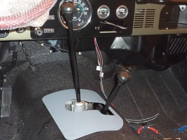

Any ideas how to install the shifter? Can't figure it out yet. Ideas? Got transfer case installed tonight. Shifter installs, but won't shift properly. Frustrating--but close.

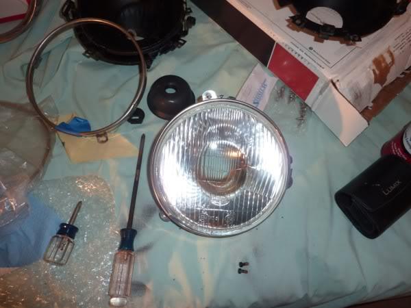

A little progress past few days. Need to remount the compressor so the hoses enter from the top. Easy correction. Installed the grill after I ordered the proper mount. Lost original in the rebuild somewhere and contacted Energy Suspension in California only to be told they don't sell individual parts but they referred me to a company elsewhere who sells single pieces. Began working on the headlights-H-4. Need to complete HID lights soon. Mounted in the grill with wire guards.
Added supports bars.
Will likely add new headlight rings; orginals need replacing.

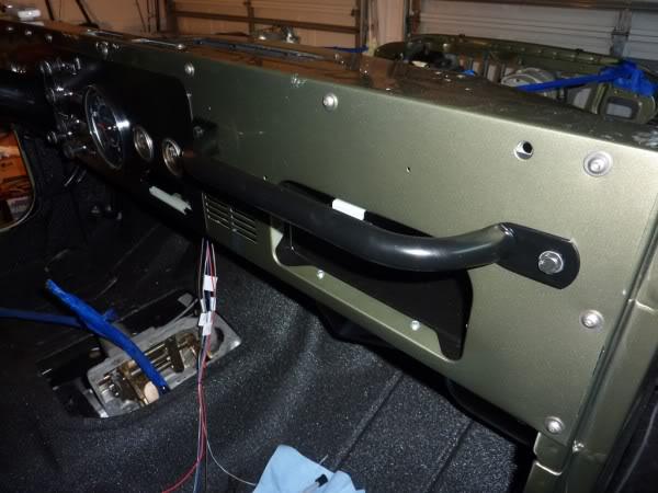

Added new grab bar to the interior.
Finally, Art figured out the shifter and installed it last evening. Had a new trans cover made and fitted it over floor.
Took windshield frame back to glass installer and had him re-install it correctly so that vents fit frame inside. Also, installed the wiper arms, motor etc. and greased, nearly ready for installation- getting hinges painted first.

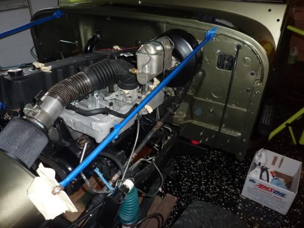

Finishing A/C to radiator to reinstall all into grill. On to wiring under hood.
