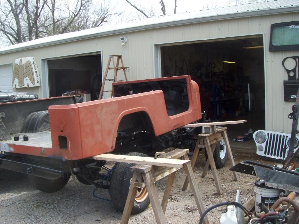

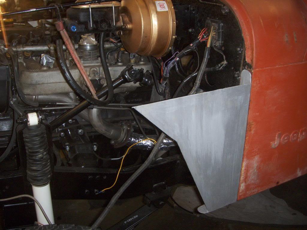

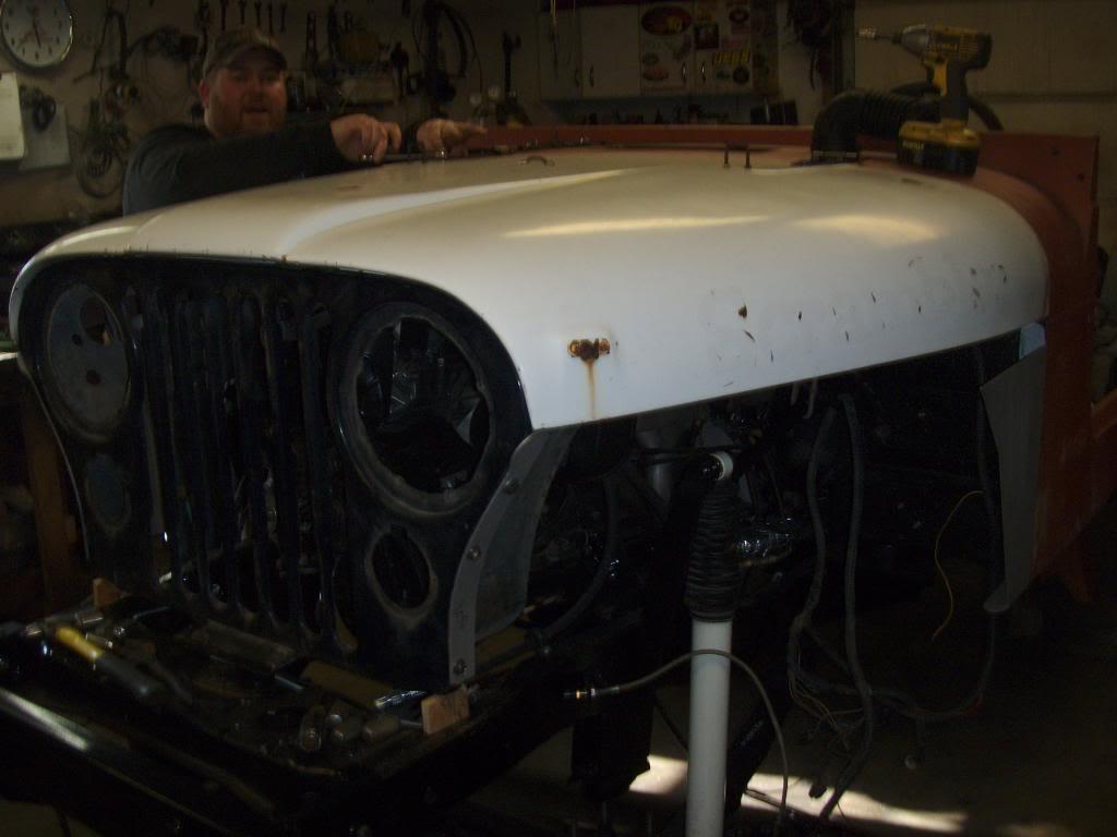

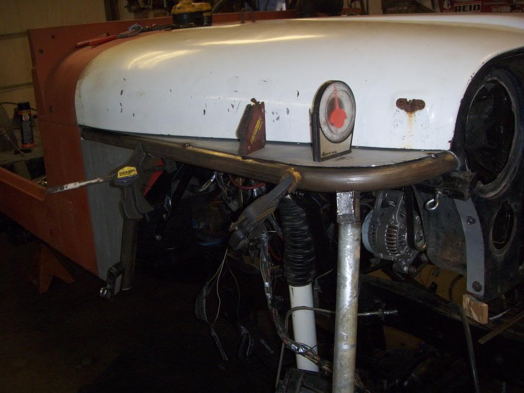

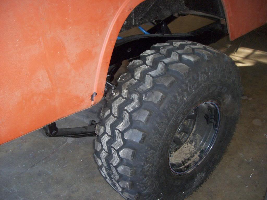

Fitting our tube fenders
stock inner fender used
new meat 35"

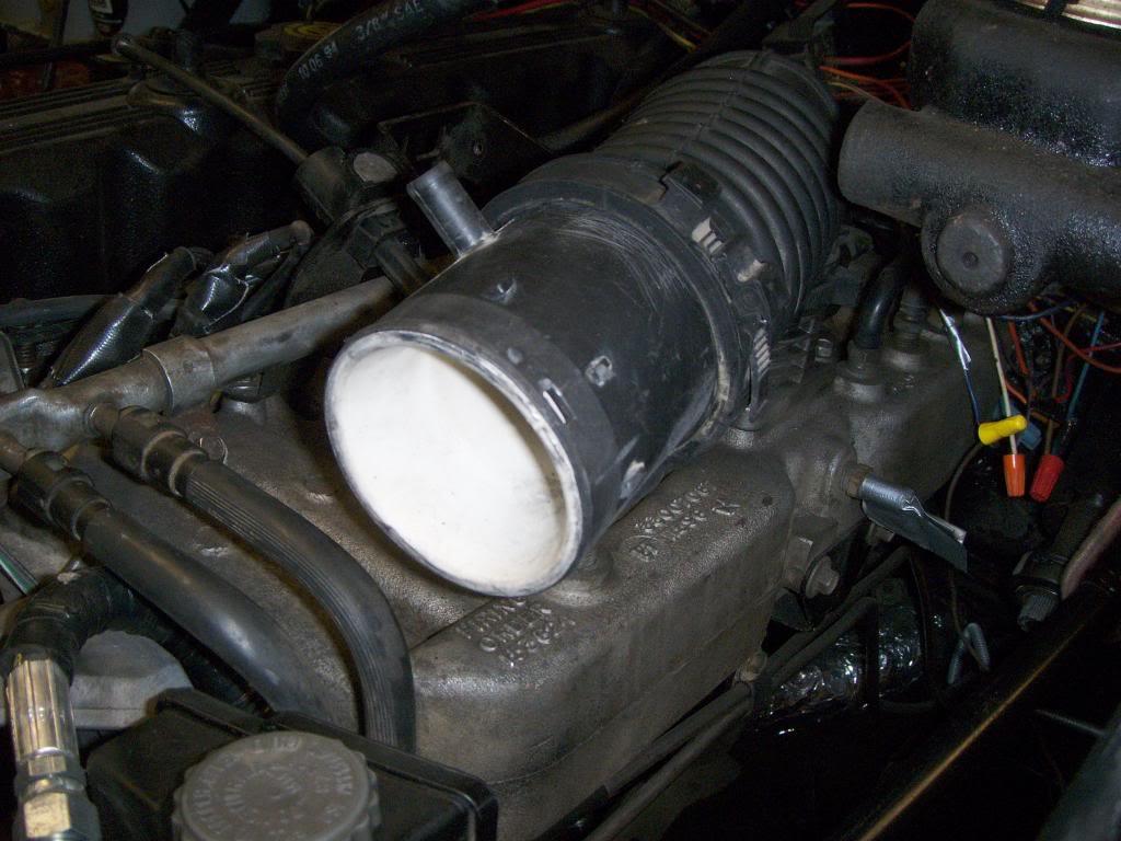

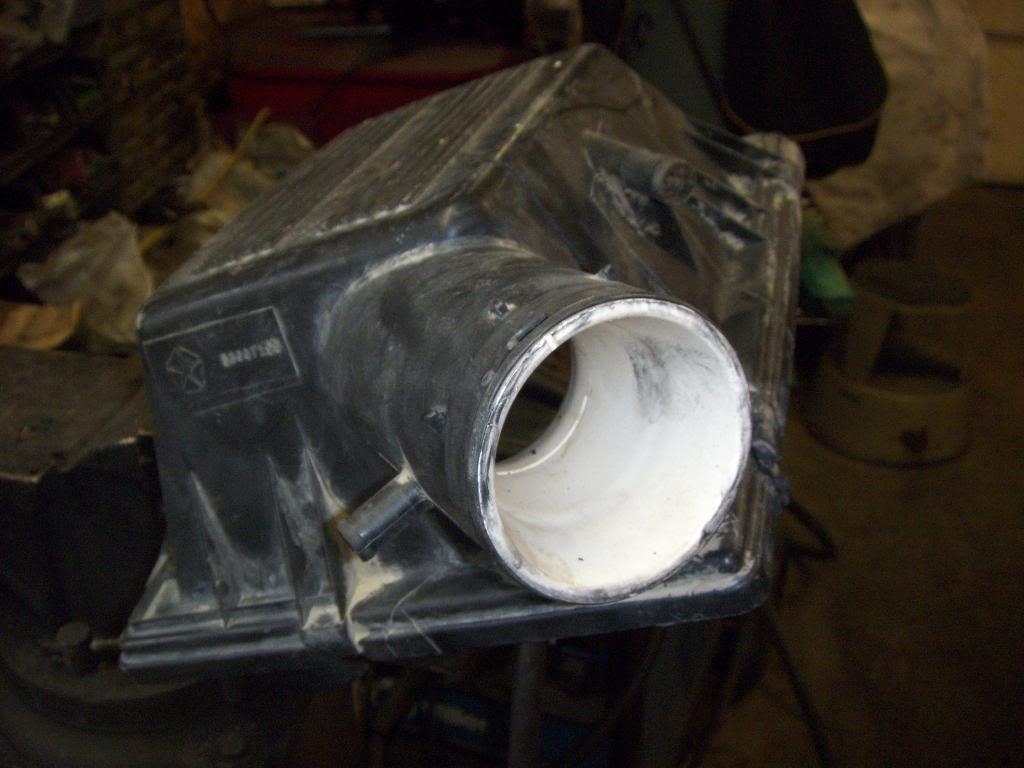

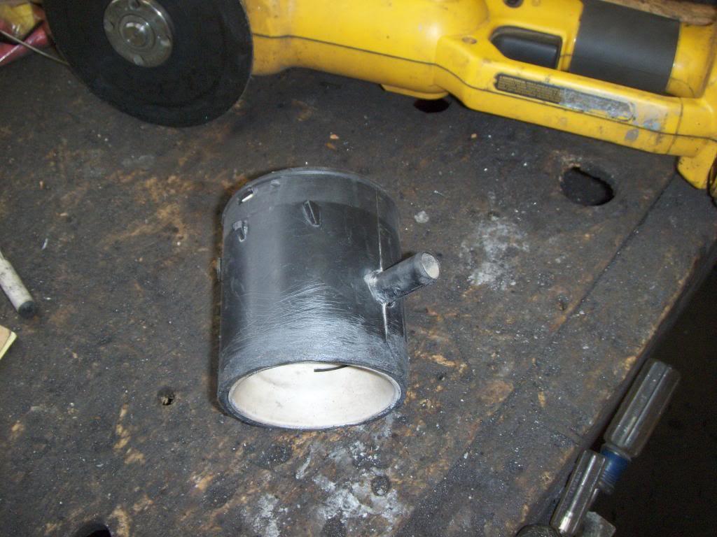

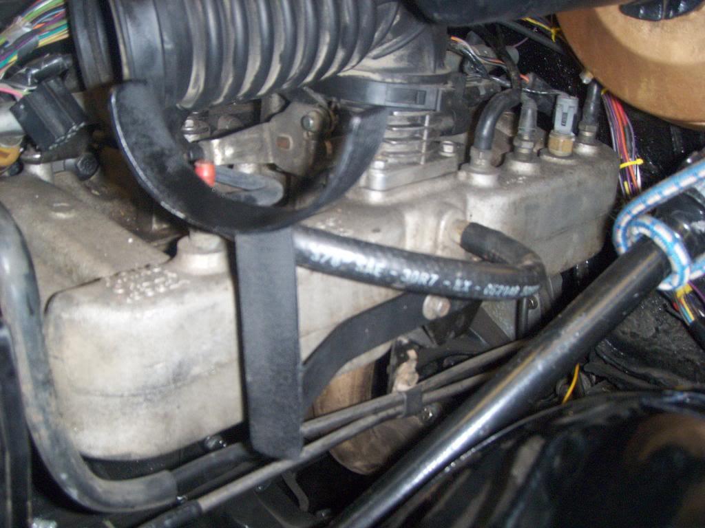

Using part of stock XJ air box to adapt to a K&N filter
Awaiting the K&N and a custom standoff bracket
Plat to use K&N cone filter RU-5122

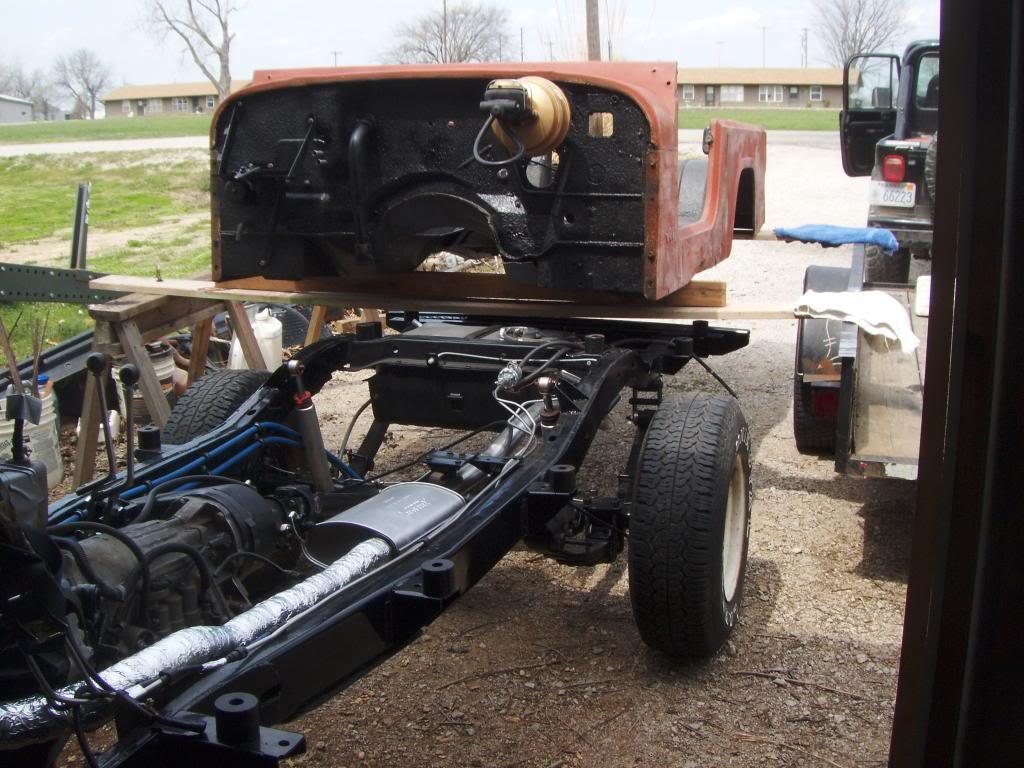

what did you use to wrap the exhaust?

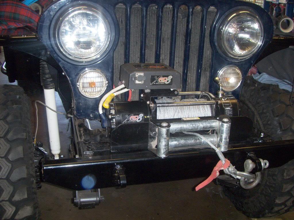

Didn't like how the winch solenoid box covered the turn signal.
So pap did a nice little mod to move it more center to clear turn signal.

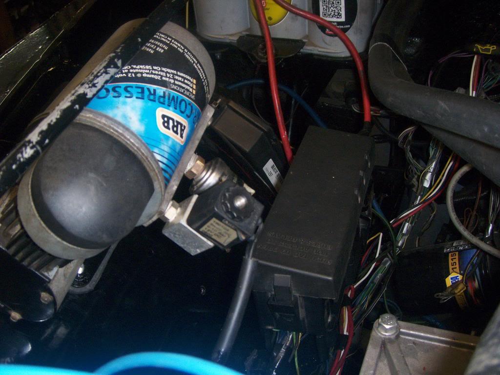

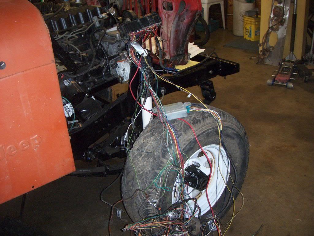

4.0L computer and fuse box nicely attached to fender, along with ARB compressor for front locker.

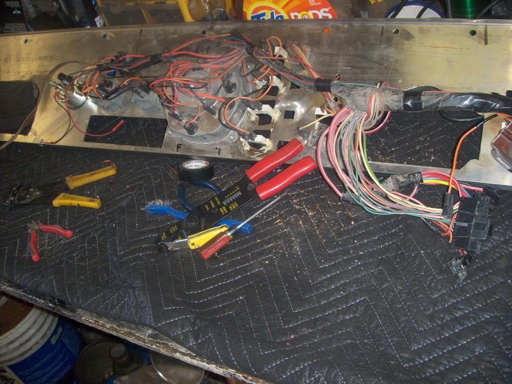

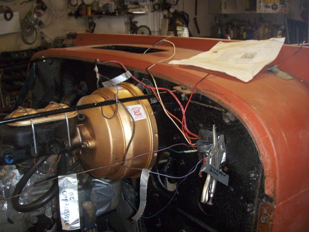

Checking out the dash wiring.

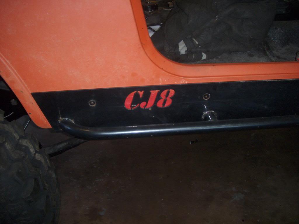

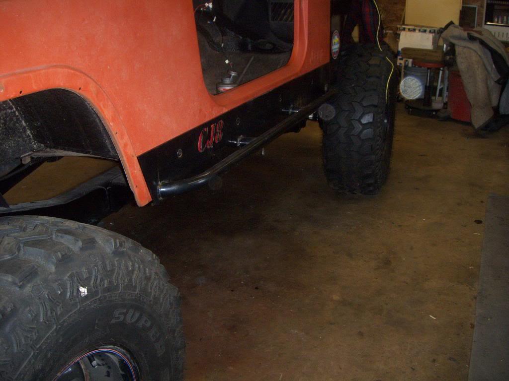

Rocker skids mounted.

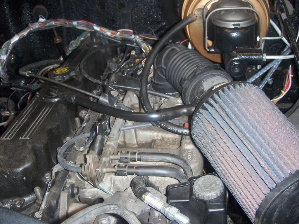

Pap fabbed up a nice bracket for clamping the K&N filter in place.

Are you using a 77-82 Corvette Master Cylinder? I had heard that they are a decent upgrade to the stock master cylinder....I ask because I keep buying NEW ones from the parts store and the lids keep leaking, looks like a better lid design.
No. It is the Navajo brake kit from Off Again 4x4. http://www.offagain4x4.com/Navajo_brakes.html

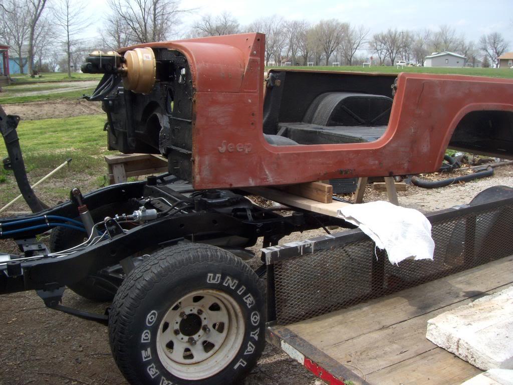

This was used unit we acquired. The master cylinder was bad, the guys at Off Again said to use master cylinder from a 1978 Chevy 1 ton
O'Reilly Part # 10-1534
