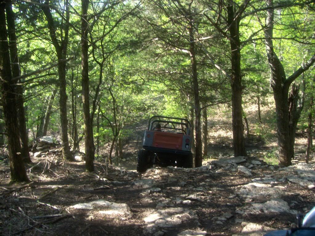

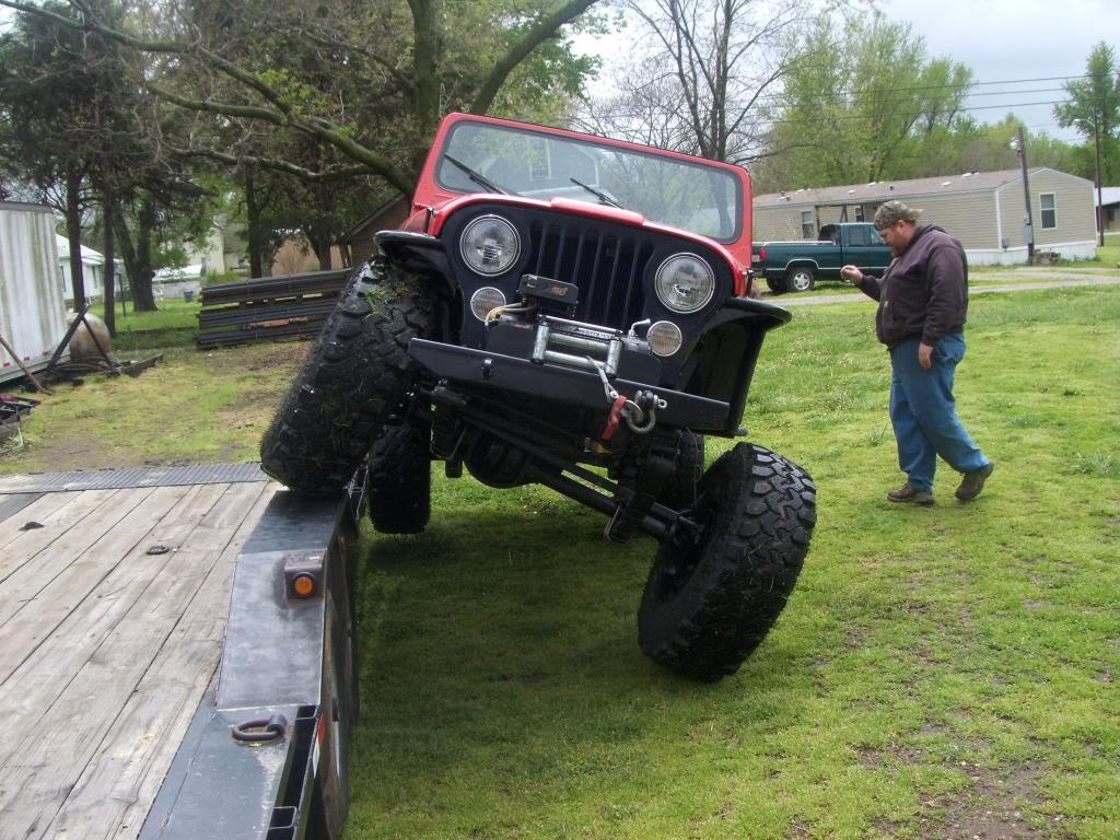

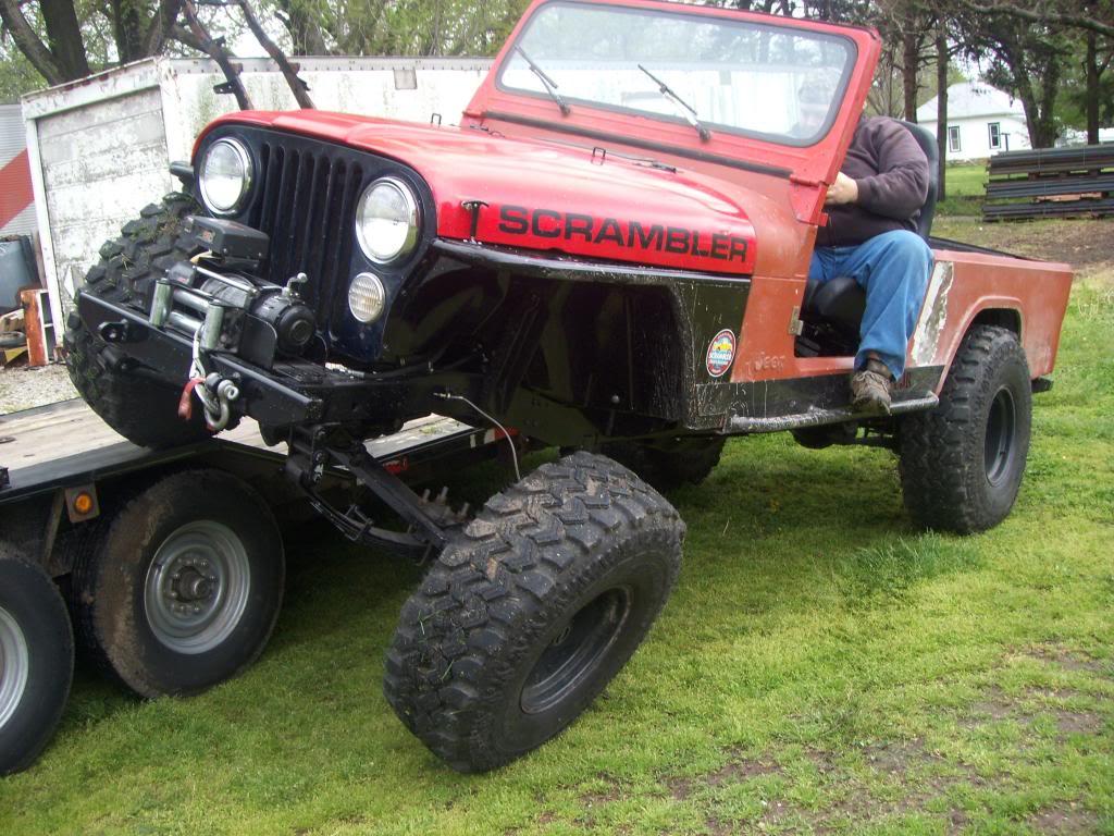

Couple more flexing

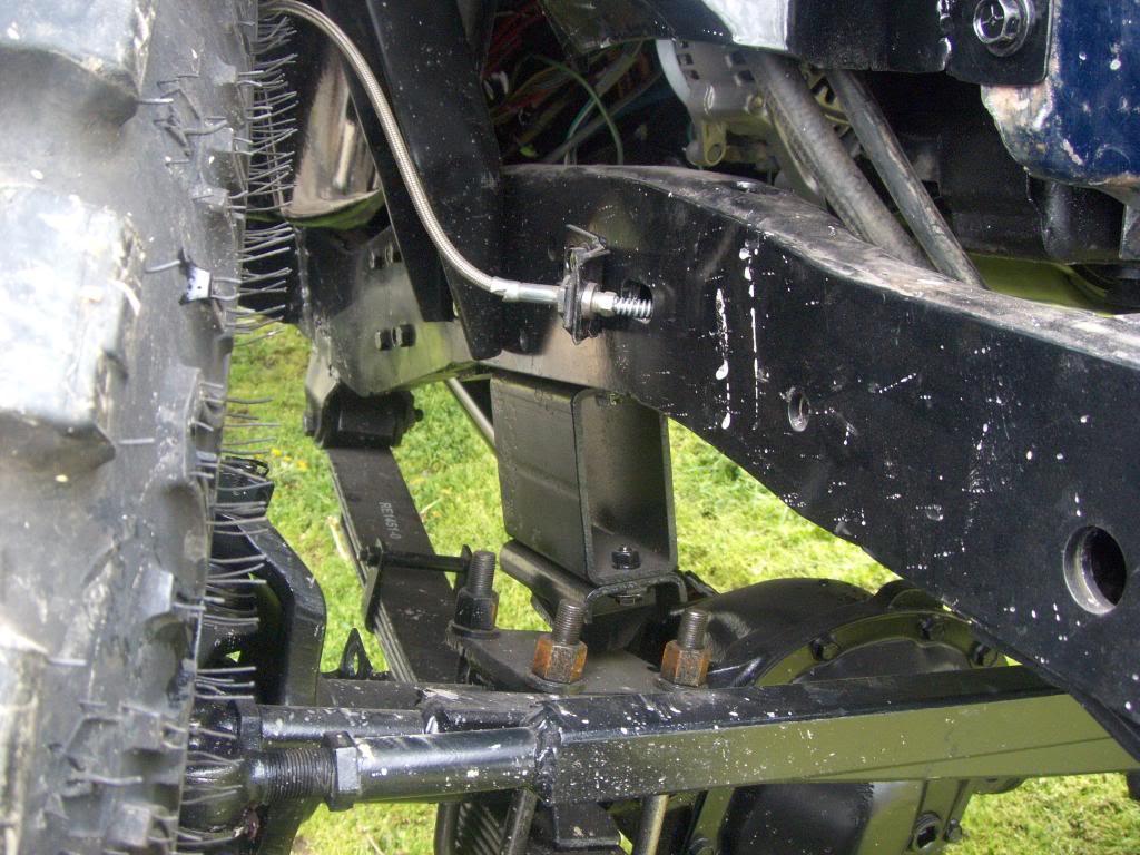

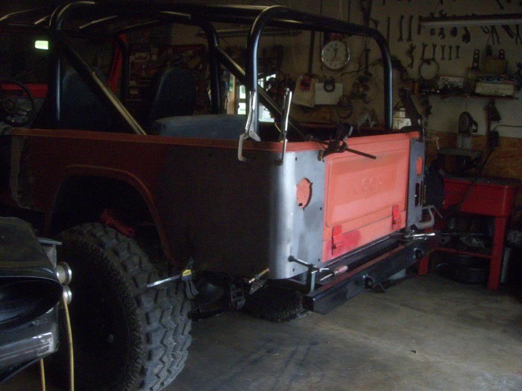

Need to trim the U-bolts
Using this for now! Thinking of buying a bender sometime soon.

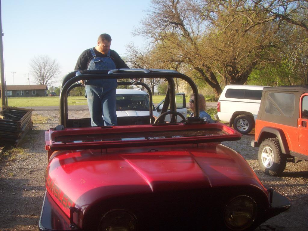

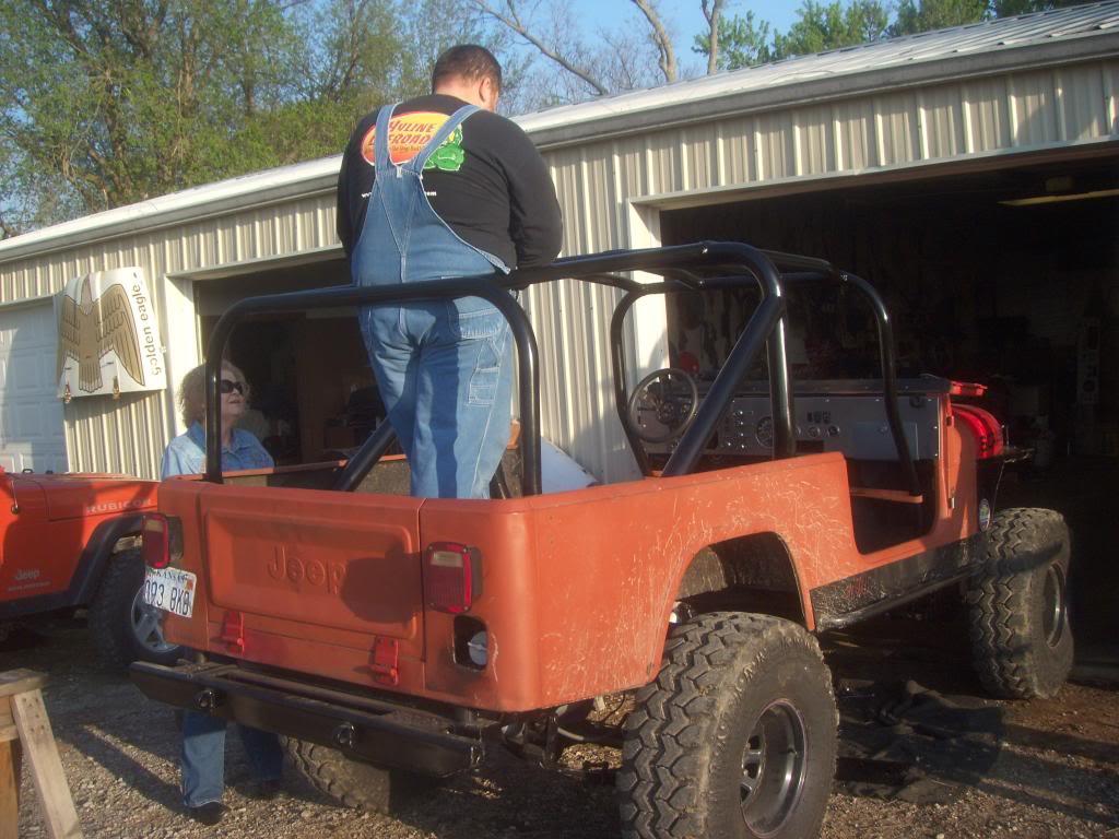

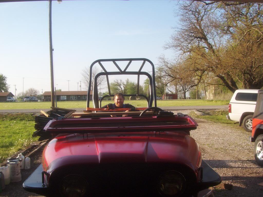

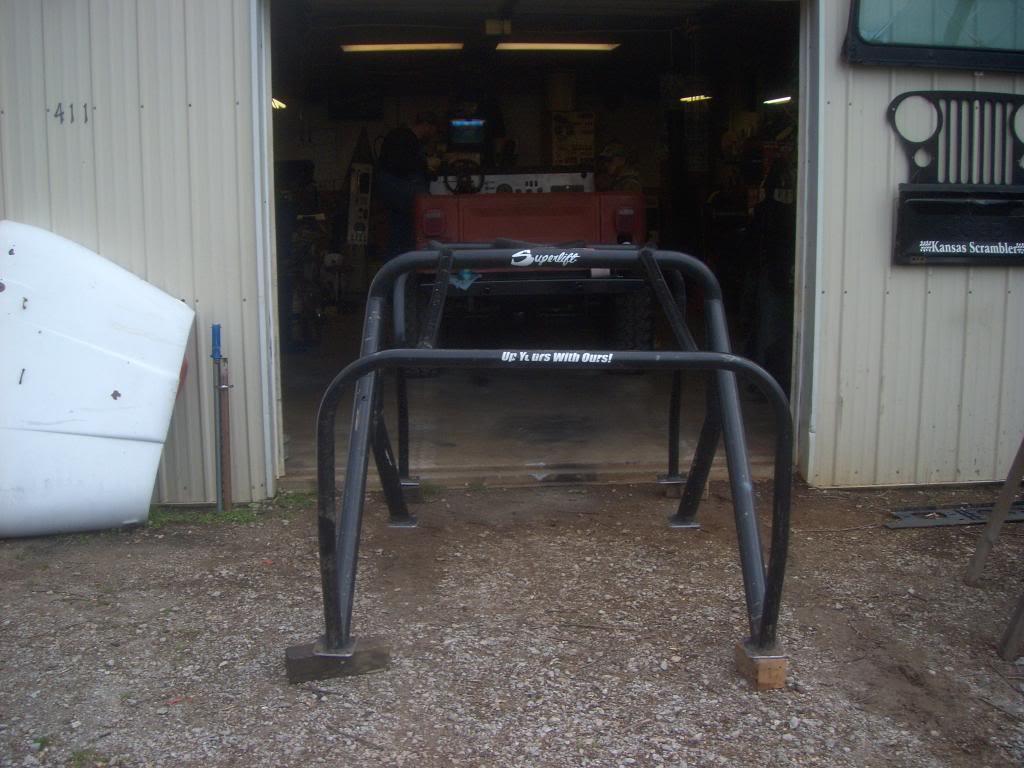

Putting in the roll bar
Sure, mom shows up after we struggle to get it in place.

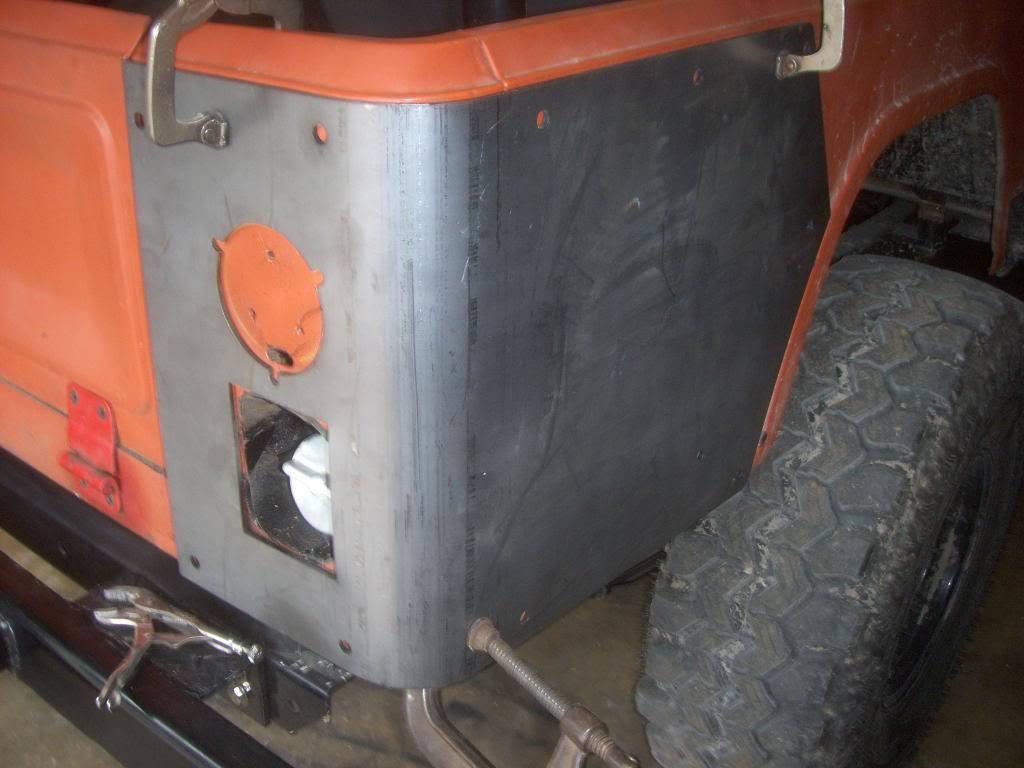

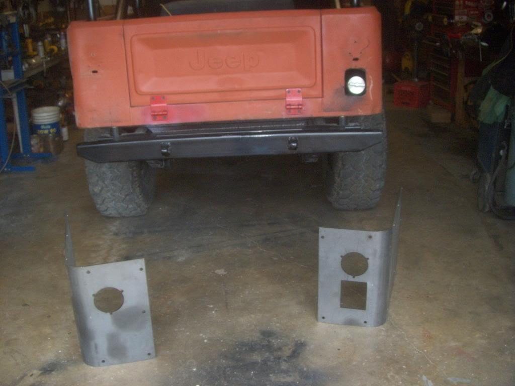

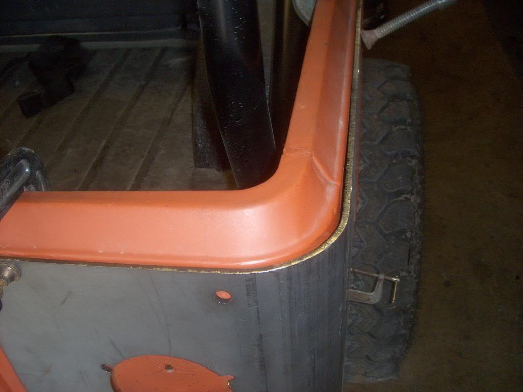

Corner armor

The corner armor looks good...been thinking about it for the CJ5 as well as the Scrambler... did you end up making it or buying it?
