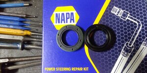

Picked up this seal kit today:
IIRC this is for a 1978 CJ7 which has the larger input shaft. Looks like a match:
Decided to lay in the mud/water/ps fluid mud hole and install the seal.
This seal went in much better:

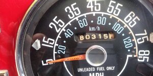

Got it back together, refilled the system with fluid, so far so good. I drove it around 30 minutes tonight, no fluid dripping out the back of the box, so fingers crossed!!! Need to clean all the PS fluid off the rest of the bottom of the Jeep to confirm, but cautiously optimistic! Hope its fixed because I need to use it this weekend to clean up a yard full of tree limbs from the storm today.
That's it for now!!!
Drove it to work today, parked it over clean concrete for 8 hours, no leaks :headbang:

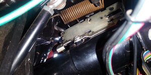

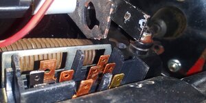

Had a "no starter starting" issue out of the blue yesterday, whiff of smoke from under the dash. Manually jumped the solenoid and it started right up.
Of course, nothing simple like a bad solenoid or just the ignition switch. I replaced the ignition switch to be safe, but this is my problem, and pretty sure it took out the switch:
That blue wire runs straight from the ignition switch through electrical bulkhead connector to the top post on the starter solenoid. No fuse or fusible link between the two components. Wire is still fine, but looks a little iffy at this plug.
What caused this is simple to deduct but I have no idea how it could occur. I have a stock steering column and pedal assembly, ignition switch sits flat to the column like it should:
But, on the other side, where the wire plugs plug in, the lower portion of the brake light switch mounting tab has apparently been making contact. You can see how there is a chamfer/angle cut to this tab to provide clearance in the picture below with the wire plugs not plugged in.
BUT, with the wires plugged in, the plastic plug is jammed tight to the tab. and the tab eventually wore through the plastic, allowing a direct short to ground when I turned the key to "start", energizing this blue wire:
The blue wire and connector were most probably fine, but I pushed the tab out of the plastic and cut it off the blue wire to make sure. I ghetto fabricated it back together for now, and it is working fine, just butch.
I also bent this lower portion of the tab out of the way:
I need to order a new plug assembly and install it, my current set up is working but it is pretty meh. NAPA can get either plug, I just need to figure out which one I need and redo this entire plug end.

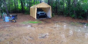

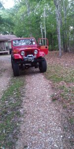

Rained all weekend long so I worked on the Red Scrambler, maintenance/inspection/minor repairs before the National/Sand Blast trips this summer. Kicked the 392 out the garage so I could work inside where it is dry LOL:
Not just summer showers, I would have been swimming out here!!
I'm not having any issues or problems, but I like to periodically take stuff apart to inspect verify condition. All four tires off, time to get to work:

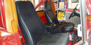

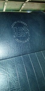

I have been using OEM Base model seats in this Jeep, which I love. But, they are getting hard to find, and I have been driving this Jeep to work every day, scared I am going to jump in with a screw driver and ruin them. So, installed my Leon Rosser seats I picked up last year at a swap meet.
OEM vs Leon Rosser:
Cool logo:
This was the manufacturer, which I Googled, still in business.
They manufacture seats for buses and commercial/delivery trucks. This would explain why these seats are so heavy duty!! The internal frames and the vinyl are super heavy duty. If you are familiar with how flimsy the OEM seats are, you can see the beef these jewels have!!
I bought a pair of these same seats new when I was in high school for my first/daily driven Jeep CJ7. That Jeep never had a top on it, sun rain high school abuse no problems. When someone stole that Jeep and stripped it, they stole the seats!
Not the best picture, but cleaned up and installed:
These seats are super comfortable. I love OEM seats but these are more comfortable/durable. They are a hair thicker and wider then OEM, but I still have plenty of room between my thighs/belly and non-tilt steering column/wheel. If need be I could remove my aftermarket seat sliders, install an OEM slider on driver seat, and gain an inch, but I have no need. I'm 5'-11", 180 pounds, fit fine and my head is still clear of the Rock Hard in cab roll cage. YMMV. Quick test drive, love these seats!!!
I might contact the manufacturer and see if they could still build a pair of these seats. They are very comfortable and durable, I would buy a new set if available.

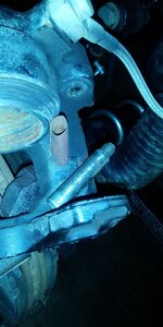

Front brakes started sticking/dragging bad Friday morning on the way to work. No smoke but it wouldn't pull 45mph in 5th gear. At lunch it worked fine. On the way home I could feel it dragging some. When I was about a mile from home I couldn't shift out of 3rd gear they were dragging so bad.
Pulled it apart, at first I thought it was only the driver side front. Nope, both fronts. Front calipers are two years old. Had a new pair in garage so I swapped them on, same thing. Pulled both front flex lines off, clean with no internal degradation.
Only a little bit of trash in fluid:
I put it back together, bled the fronts, they worked for a few minutes but the last time I hit the brakes both front calipers were locked up again.
I am assuming something happened to the master cylinder. It pushes fluid down but will not allow it to flow back up. If I blow into one front hard line air blows out the other side, nothing pushing back up to master cylinder.

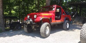

Finally arrived:
Ready for the trails:

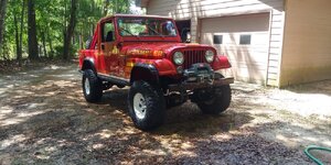

All cleaned up, mostly ready for Sand Blast, more on this in a bit.
