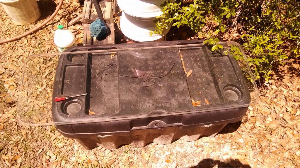

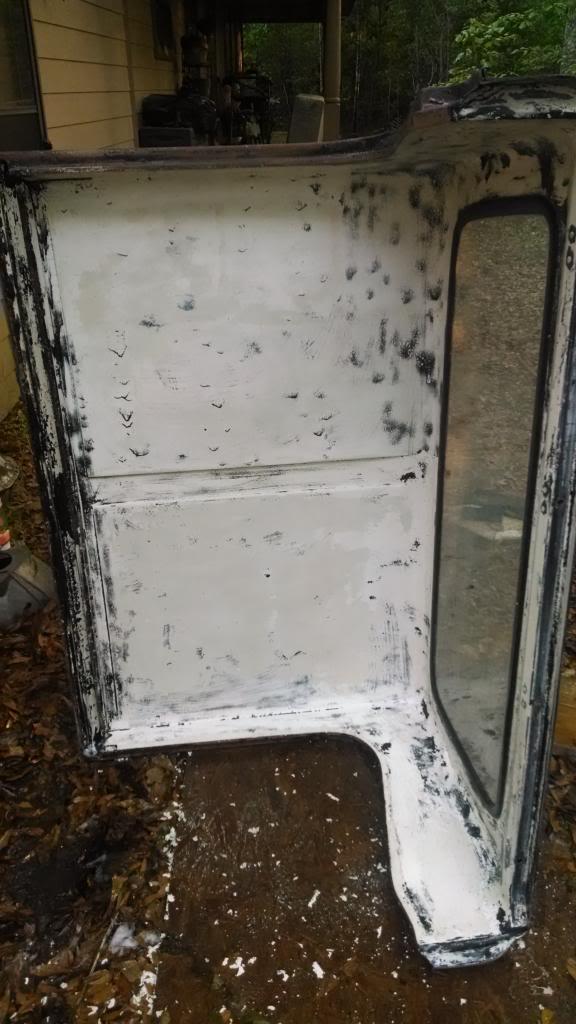

And this is what I came home with, a nice spray painted 1/2 hard top:
While it looks like crap, it is actually in great shape. No cracks, it has the metal strip still attached, the glass isn't broken, etc. I have not checked to see if the little threaded inserts are still intact, but even if they aren't, that isn't too big of a deal.

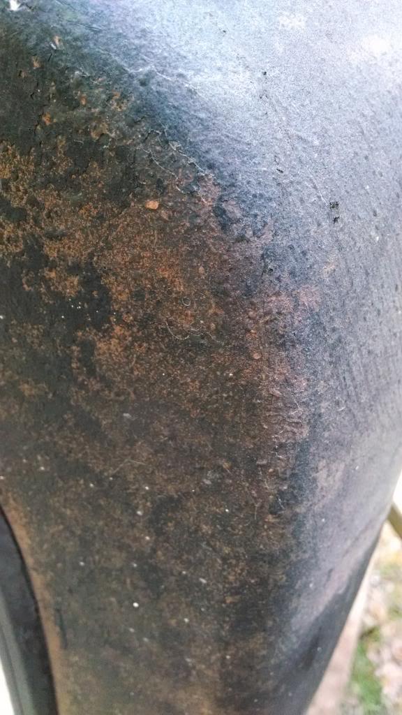

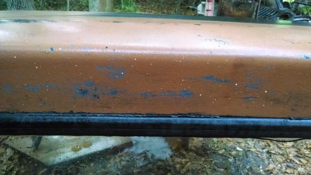

I really like my nutmeg colored 1/2 soft top, so I want to replicate that color scheme with this top. Anyway, after closer inspection, I discovered that this top still has the original nutmeg finish on it, it is just covered with some sort of black paint. The factory applied "texture" is still in great shape, too.

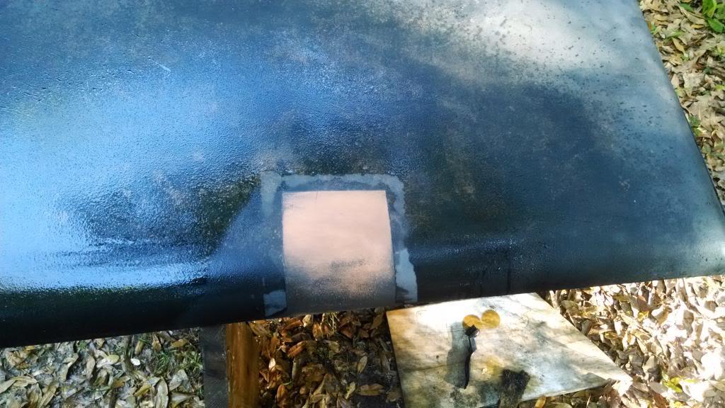

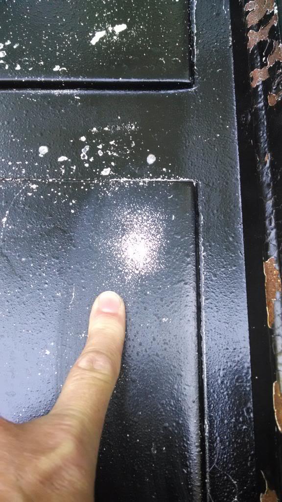

I did a quick "experiment", wiped a spot on the inside down with an Acetone soaked rag. The black paint came off pretty easy:

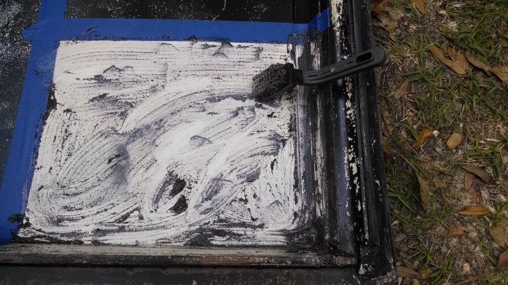

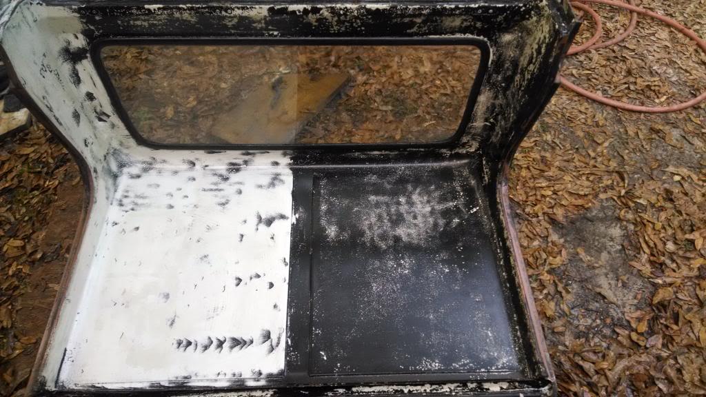

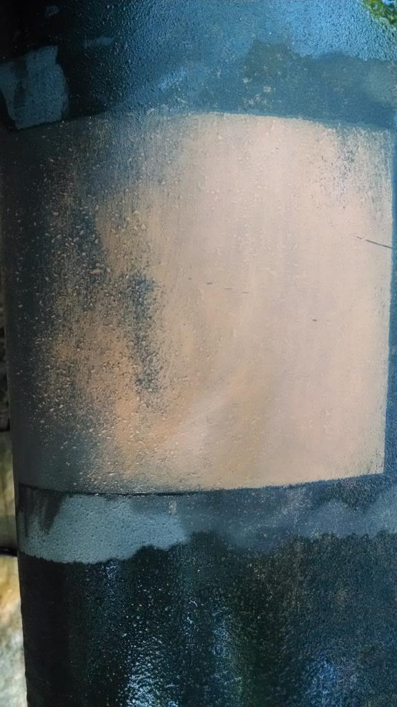

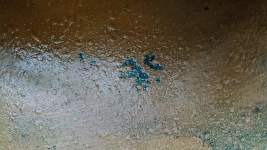

I taped off a 1' x 1' square on the inside and applied some stripper with an old paint brush. Within 30 seconds, the black paint was coming off:

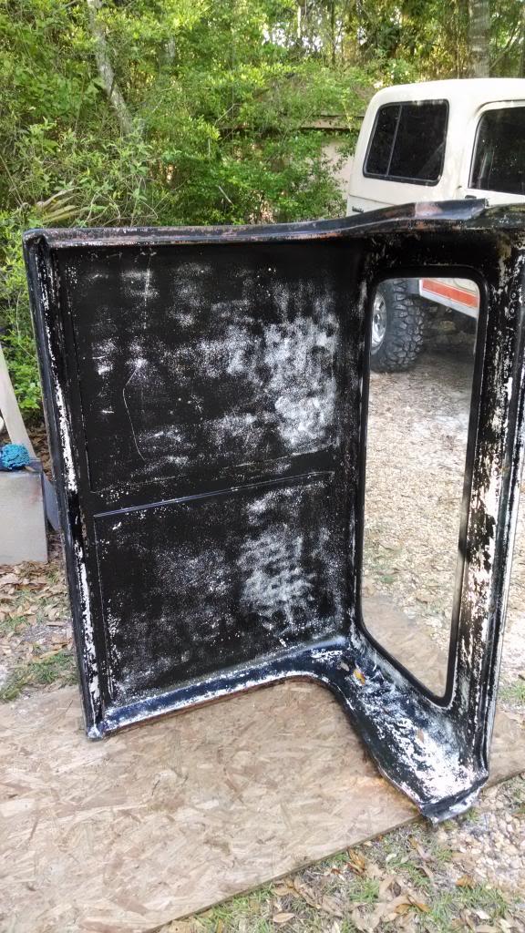

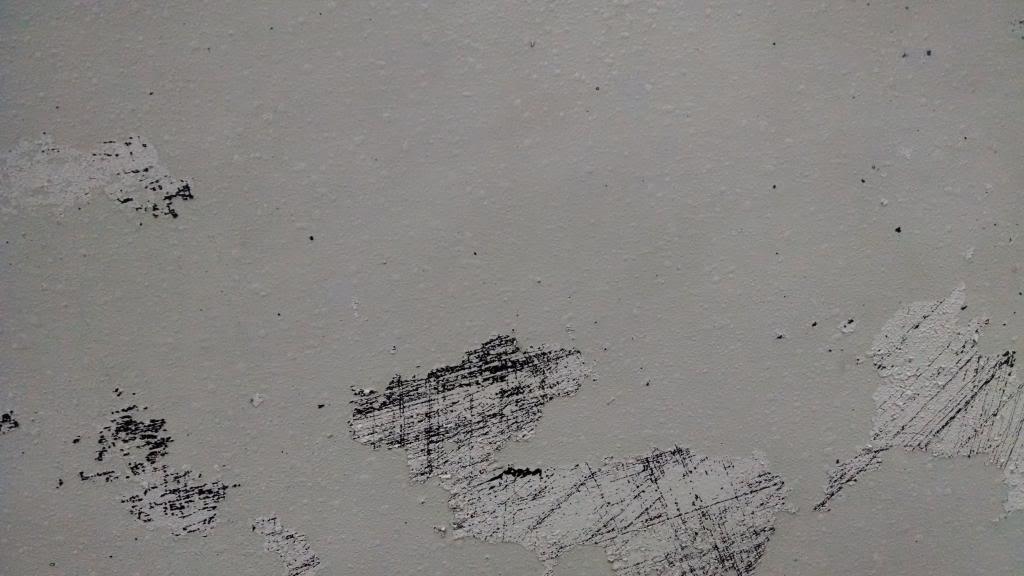

I decided to try to speed up the process by scrubbing with a soft copper brush:

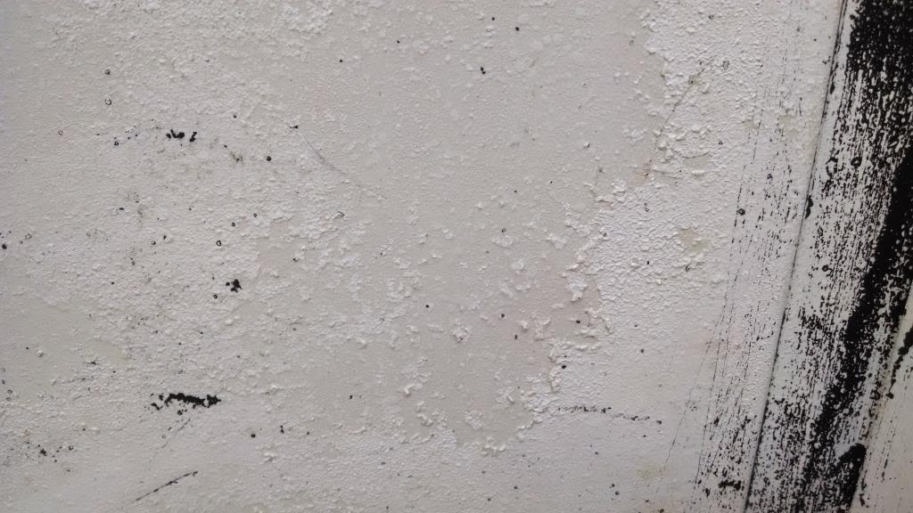

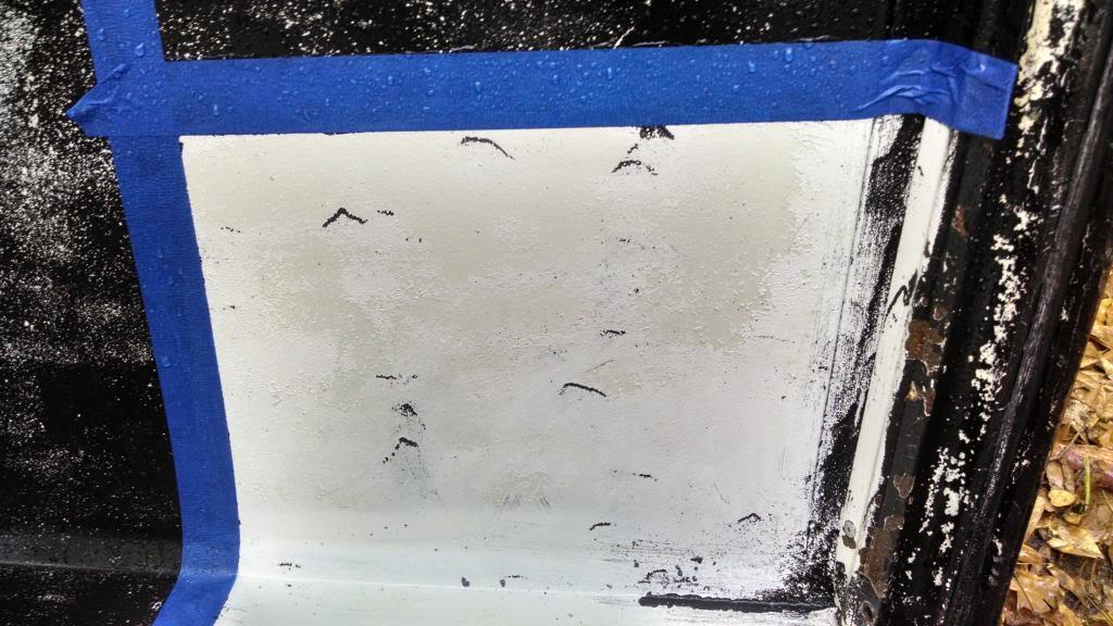

Using the brush was not the best idea, it was a bit too aggressive, and actually removed some of the white paint:
Besides some of the white paint coming off, this stuff worked great. It did not harm the texture or the gel-coat:
It is still "risky" to use chemical strippers on fiberglass. If you leave them on too long, or use too aggressive of a chemical, it could leach into the fiberglass. To minimize this, I am doing a 12" x 12" section at a time, leaving the stripper on for less then a minute, speeding the process up by scrubbing with a 3M paint removing pad, and thoroughly cleaning/flushing the stripper off with water.
