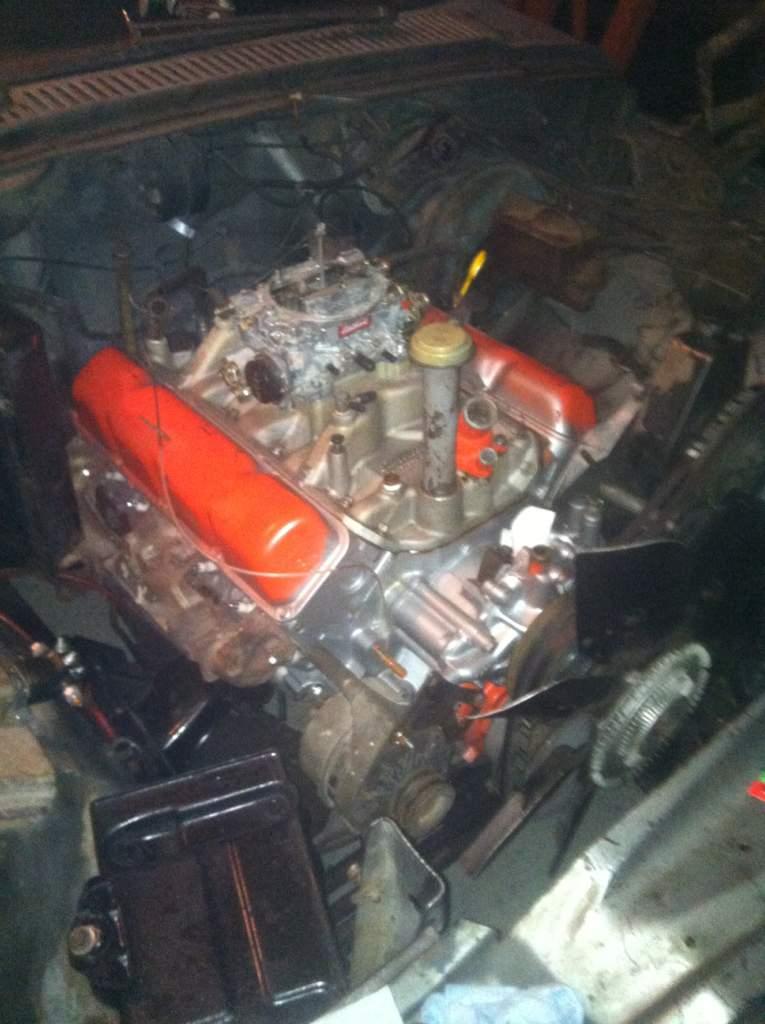

Today's progress, starting to look like a motor.
Have to figure out the dizzy issue.

I'm working on firing this beast up. Just have to prime the oil system, get to TDC on 1, triple check everything and try it. I think.
Priming tool from old dizzy.
Where it sits now.
