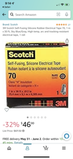

I realized that the heat shrink would not hold up too well to a line that is heated by trans fluid. So I replaced the heat shrink with some silicone self-bonding tape. Good to 360 degrees. That should work.63832433-220D-4E35-8D0A-6C51B960E2C7.png
This is the stuff I used. I got a couple rolls of it in a box full of goodies at a yard sale. That $2.00 box had hundreds of dollars of treasures inside!
