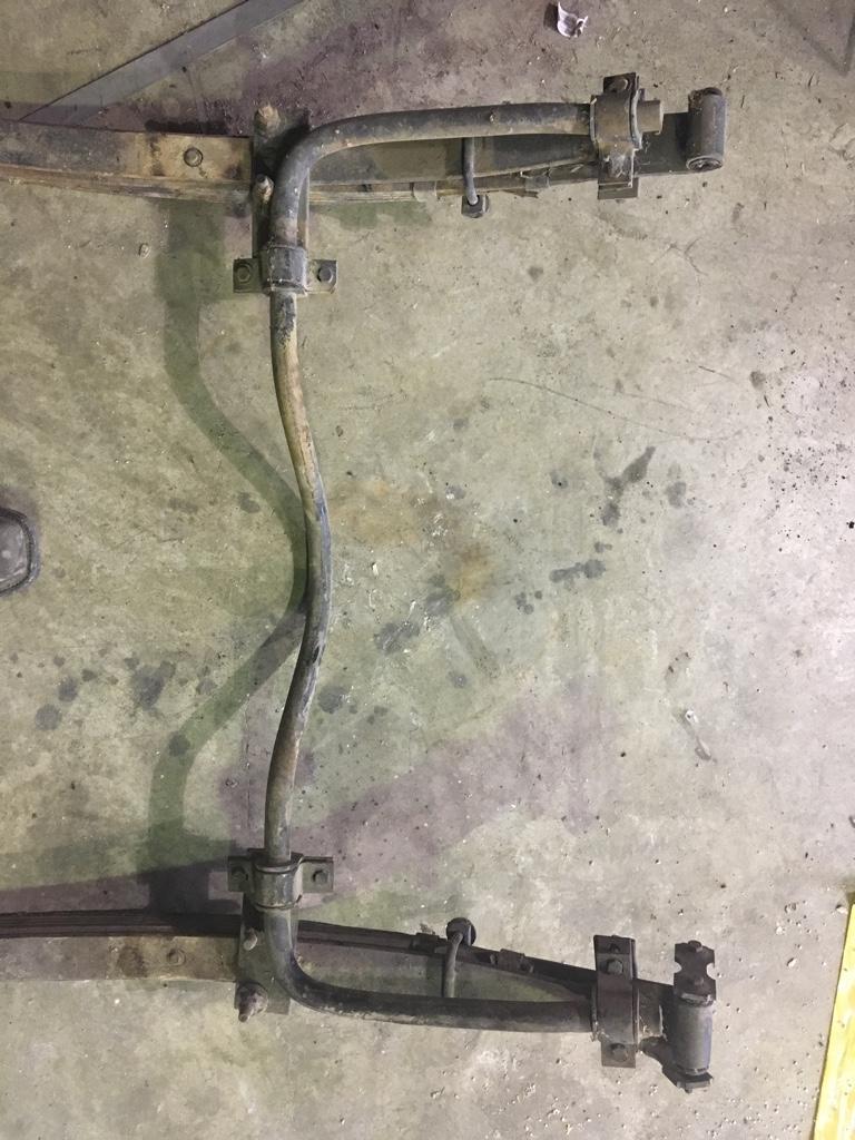

Is this connector something I need to clean up and put on my new springs? It's on the rear springs that I took out. I'm not sure if it's original or even necessary.
That's some kind of non-original sway bar. I'd have no idea just how effective it might be. I'd pass on it.
I agree. I would think a sway bar on the rear would be a negative. More so THAT sway bar.
