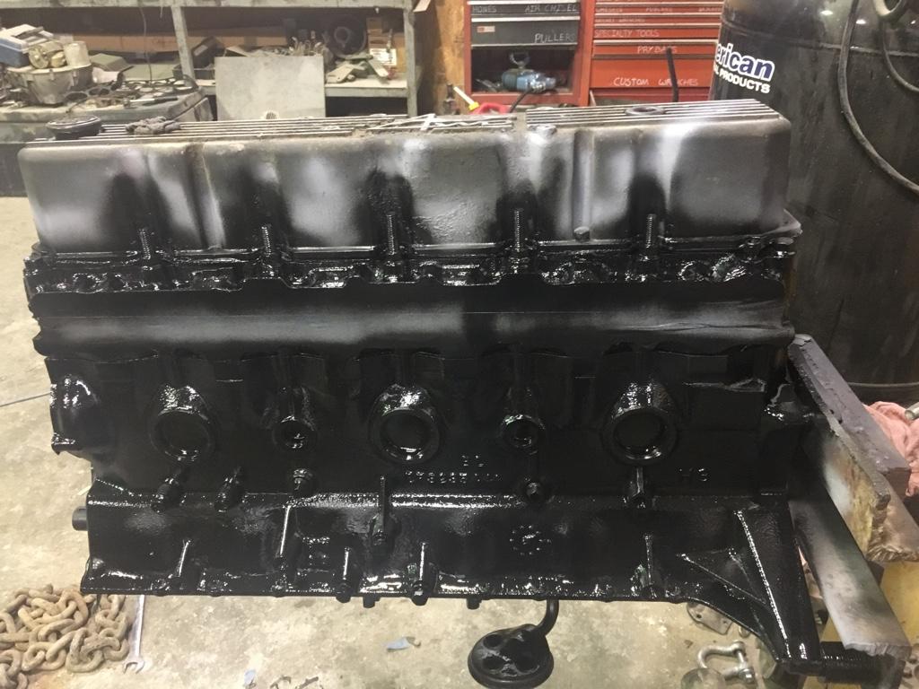

Wow just painted my oil pan and doesn't look like that. Think you could eat off that or shave. Valve cover really looks good
Sent from my iPad
cattleman1977
Delavan
KS
If it runs as good as it looks I'll be ecstatic.

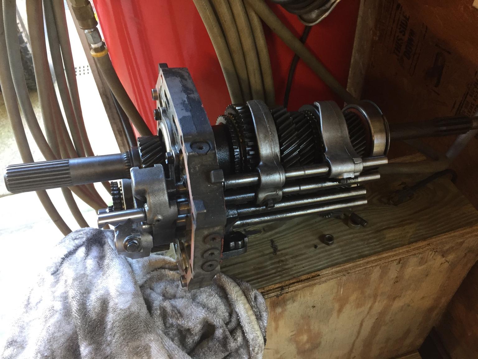

But... I tore into my T176 and initially thought everything looked good. But then I found a piece of aluminum lodged in a gear. Turns out my cover is chipped on the underside.
It won't cause it to leak but it's around a hole where one of the shifter pieces connects to the cover.

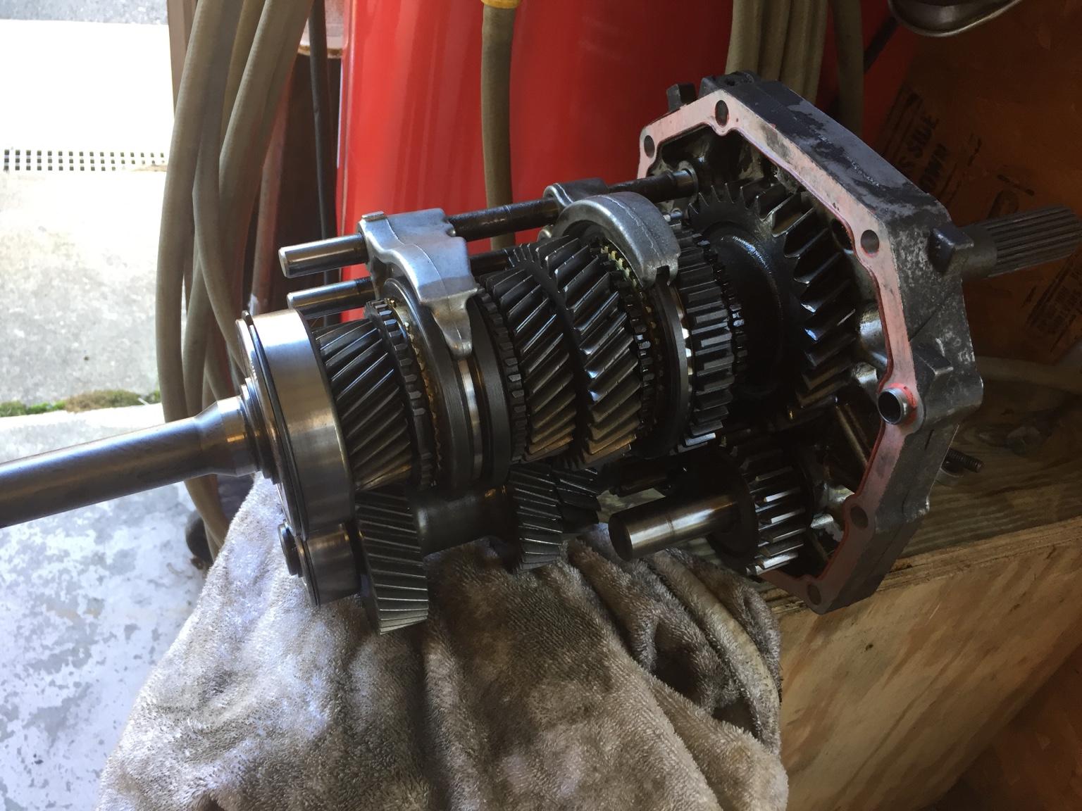

Additionally, I discovered this.
It might be difficult to see but this is the second gear in from the output side of the transmission on the bottom set of gears.
The decision I have to make is look over the 5 speed I have and use it or rebuild the 4 speed. Supposedly the five ran just fine when it was pulled last spring but I'm not sure if I will like it with my 4:10 axles. I'll start pricing rebuild kits tonight but any thoughts are welcome.

Unless you plan on driving this Scrambler really long distances on the interstate at above 65 MPH speeds, keep the T176 :twocents:
I have even ran the T176 with 33's, 4.10 gears on a few long (350 miles one way) trips, not terrible, but 65-70 is about the max speed I would want to push.
I went from a T176 to a T5, I broke three of them while driving on the interstate, 75 MPH. All of them, front gear on cluster gear, input shaft gear, completely destroyed, no other damage.
Stockish size tires, stockish gears, stockish power, the T5 should be OK. Modify any of those parameters, or all three like I did, I think you can expect trouble :twocents:
The T176 is a much stronger transmission then the T5. When you open up the T5, compare the size of all the parts. In manual transmissions, bigger is better.
As for your T176, the bottom gear with slightly chipped teeth is the reverse slider gear IIRC. I would not worry about that. If reverse worked fine before, it should be OK.
If I were you, I would find a good USED T176 cover, and then rebuild the T176. It is easy to rebuild. DO NOT BUY AN AFTERMARKET TOP COVER OR SHIFT FORKS, they will not work correctly:twocents:
