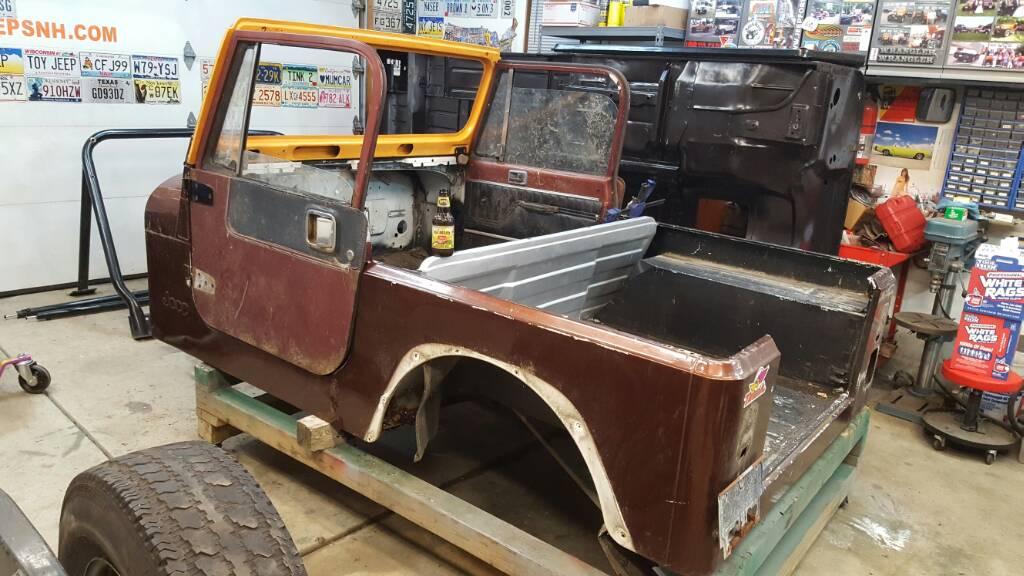

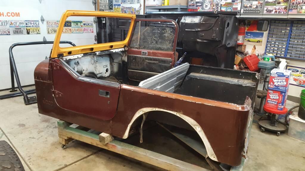

So, got down the doors from the 7 as the other doors wouldn't fit no matter what I would do... now these doors don't fit... I am sensing a pattern.
Turns out the tub seems to be tweaked a bit. The top doesn't sit down flush on the driver side and the openings for the door aren't the same side to side.
I am off like 1/4", so I am wondering if this got hit maybe, not sure.
I am thinking that if I cut the back off and bolt it down to the frame, it will probably straighten itself out, but seeing if anyone has any other suggestions.

I will tell you this, this happened to me twice on Wrangler YJ tub swaps. The orange build you may remember for the Doc, the door opening was nearly 3/8" "shorter" and after he wanted hard doors on THAT tub at all costs, the solution was to trim the hard doors themselves by grinding some off each edge, then sent it to the body shop for clean up and paint......still, the gap was too close looking for my tastes, but we did get the doors to shut right in the end. Another YJ tub was like this too...but then many others haven't been....who knows...it'll drive you up a wall tho... :shrug:

My thinking is with the b pillars rotted out on the bottom the tub has shifted and either bent down on one side and bent up on the other side.
It is like 1/4" out on the passenger and 1/4" tight on the driver... almost exactly.
I do like that all the other holes are going in and working nicely, but I am glad I tried the doors up front.
I might have another YJ tub coming in, so I can measure that one and maybe use that one and not mess with this one, but without trying the doors upfront, I would have never have known.
I kind of need doors on this too, it is going to be a truck, so doors kinda useful.
