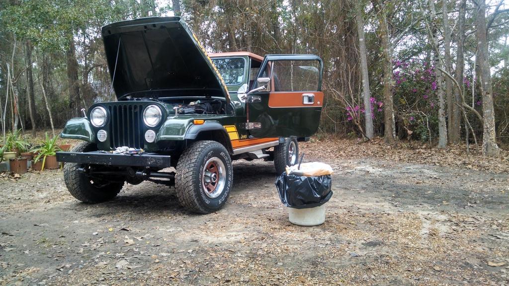

Been a long time since I messed with this one. Last fuel fill up was November 20, 2014, thank God I used ethanol free gas!!!! The last time I started this one up and drove it was in early 2015. After charging up the battery, it started up fairly easy. The transmission did not want to shift at first, I guess all the oil had run off the shifter forks due to it sitting for so long.
So, drove Josh's Scrambler back to Tuscaloosa Friday night, washed four Jeeps on Saturday, got bored Sunday afternoon and decided to start tinkering with this one again
I have been slowly learning about/researching/acquiring parts to get all the feedback carb/emissions systems stuff reinstalled and operational on this one. I guess I want a challenge
After the work I did a few years back, the computer is going into "closed loop" and controlling the carb. The Scrambler runs really well, about the only issue it has is that it likes to blow the reverse light fuse, which also controls the choke.
This Scrambler was not "Bubba'd" too much in its past, but some "Bubba" did happen. More on that in a bit.

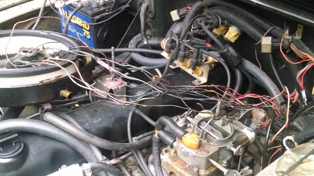

After getting this one fired up and running, I did some testing using the factory under hood diagnostic port. After changing the choke fuse,and armed with my trusty muti-meter, I checked the diagnostic port contacts:

Basically, just confirmed what I already knew. I did not bother to check/test the pulse air sytem components at this time. The vacuum/electric switches are still hooked up, but I have not hooked up any of the valves/piping. The pulse air stuff not being present would not effect how the Scrambler runs anyway, I suppose

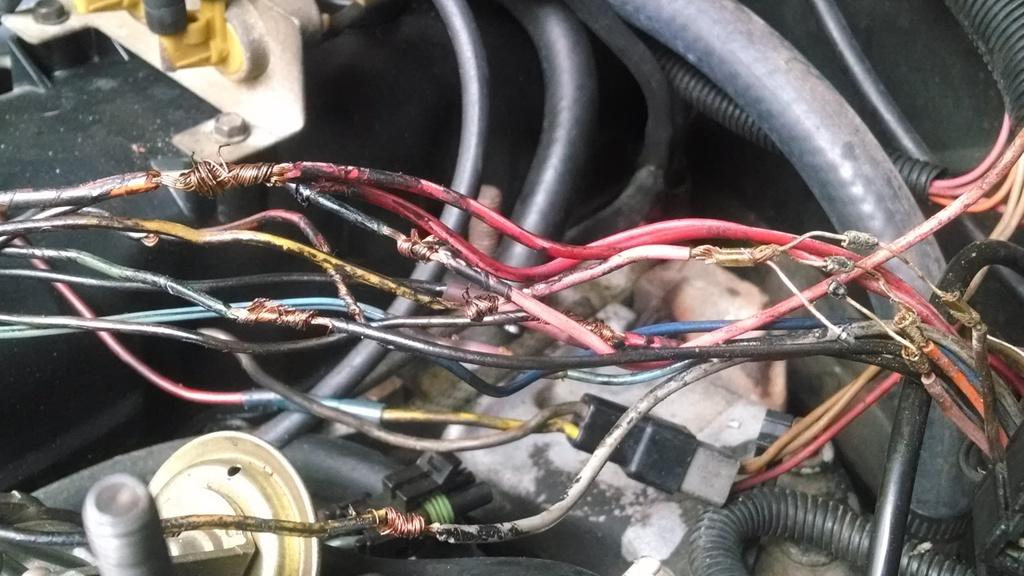

The one potential "Bubba" issue with this Scrambler involves the wiring harness that runs from the firewall to the intake manifold/carb area. All the wires were wrapped up in electric tape, that was good and crispy. Not sure how the factory ran this part of the harness, but I don't imagine they just let it sit on the hot intake/exhaust manifolds??
A few years back I repaired the thermal electric switch wires in this area due to the fact that they were melted. I guess I should have dug further
Yep, looks like it all melted before, and someone did the old "cut out and twisty wrap new wires in"
The melted wires wont be hard to repair, but I need some more information on some of these wires, and why some of them have either diodes or resistors on them. The 82 FSM with '83 supplement does not describe/show too much on some of this wiring. Only one diode/resistor/fusible link is broken. What I know:

7) SolVac wiring - ground wire OK, with diode attached before ringlet, as it should be. The energizing wire is damaged.
8) Choke wires - see above picture. Looks like two tanish browns and a red go into a grey connector, then a black plug comes out of it. Single yellow wire spliced out of it to choke (not stock obvious). It also has another wire with a female spade terminal coming off the black connector, this was melted badly. The melted wire was resting on the exhaust manifold, probably the cause of the fuse blowing.
