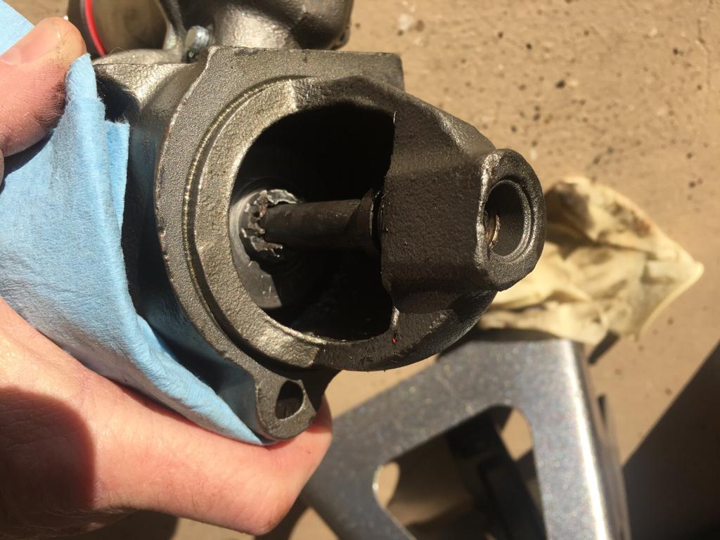

Starter crapped out.
This Impala is starting to piss me off. Spent a lot of time on it today and accomplished zippy.
Shimmed the starter. Many times, trying to get it right. No matter what, it made a scraping sound. Found the teeth from the gear in the starter pictured above. But inspecting the flywheel showed at least one flat spot where the teeth were ground down. Pisses me off. Now I need to install a new flywheel. Awesome. Not doing this myself. Taking it somewhere (probably a Hot Rod shop I went to today to check out). If they get the Impala to start right, I may get them to do more work. We will see.
