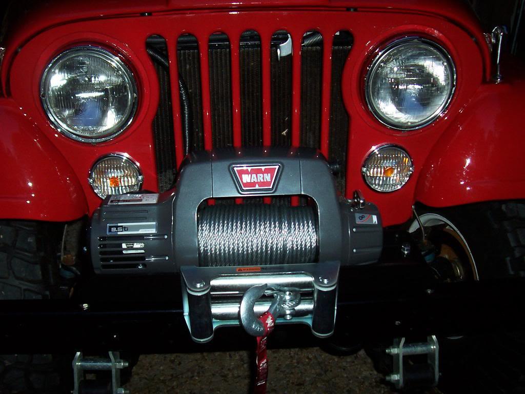

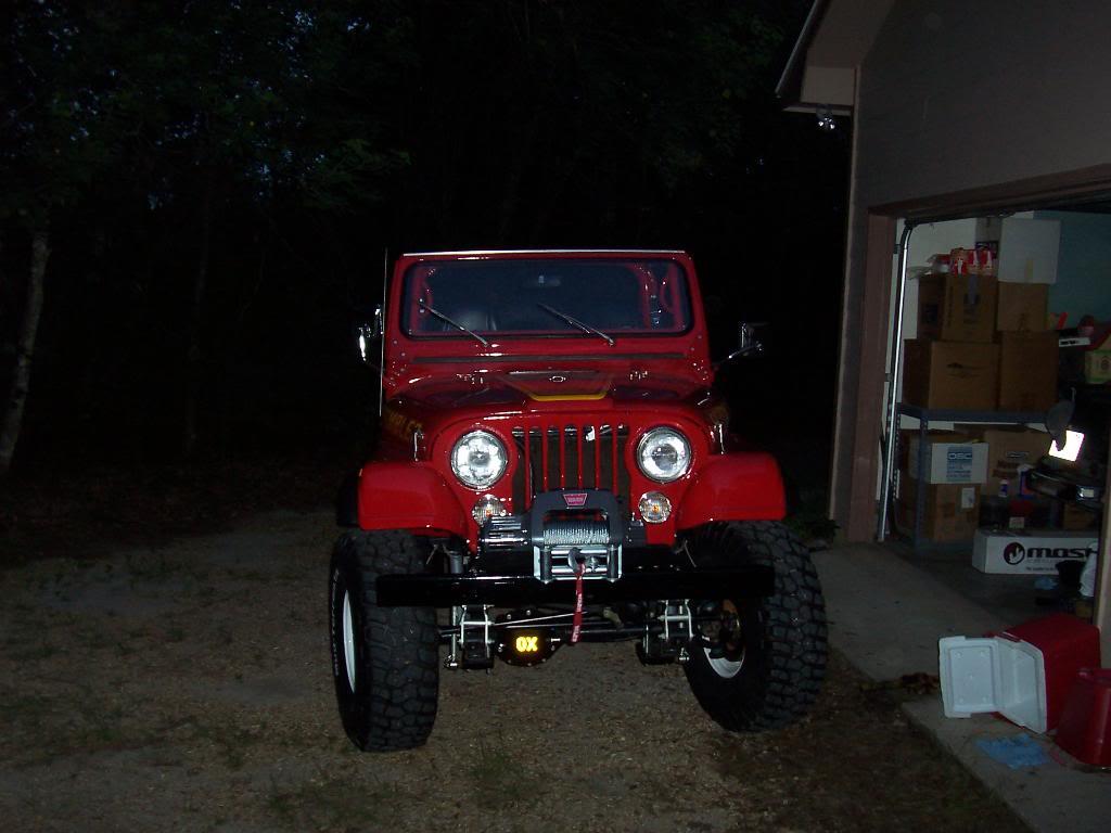

Incredibly nice! would you like to take mine and work on it while I drive yours a while??? Please?

I can't take on any more Scramblers right now, I still have one of "JeepAddicts" refugees in my yard LOL
If I get back out to New Mexico again anytime soon I will definitely let you borrow it
